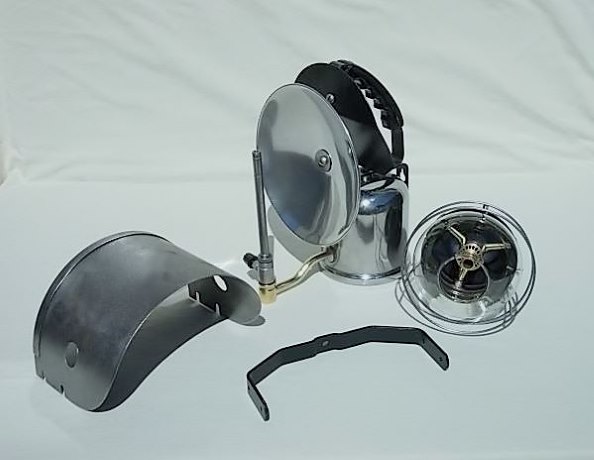

    Hi all,
    Here's an AL15A I bought off E bay recently, it arrived with a track work stand, but as I needed that one for another AL15A which was without that particular apparatus, it'll maybe be appearing slightly half dressed.
    This one here came equip with the large hooded cowl, bracket & doofer wing-nuts; but as the cowl was in very rough shape indeed, I thought it a good enough idea to fit the proper hood, cage net & onion globe to an AL620 model :idea: .
    I did have to give it some thought first, as I don't entirely like to separate part components from old timers (unless breakage forces it), but I'd have been looking at the other AL15A for another few years, before I got around to ending up joyously sequestering, "just" the single track work stand sought, in any other auction find/ bring & buy, or E bay UK.
    It sort of looks nice enough to me, any way, here it is, a little bit the worse for wear . . . .. (hiccup) !

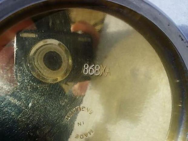

    I was very surprised when I'd started removing its original white or cream coloured paint, to be looking at what appeared to be a steel tank ! I had a tip given, to boil them in a pan of water, which then makes very light work of the complete paint removal process.
    Well, that worked & it certainly was steel, as I'd suspected it could have been an under coat, as the boiling had begun, but later on the clock, apart from the heavy pitting & rust at the founts crown, most of its sides were thankfully in quite good nic, with no dings or pit runs to be seen round the 360'.
    The manufacture date is stamped on the base, to me it looks like 1968, the month of August ? I can't see this dating to the mid eighties :mrgreen: , but another question was why or what, at that late 60's date, were Tilley using steel for with the tanks. The usual brass roll, possibly thin on the ground for what reasons, I haven't a clue there ?

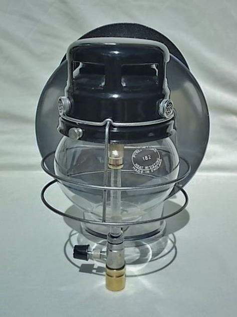

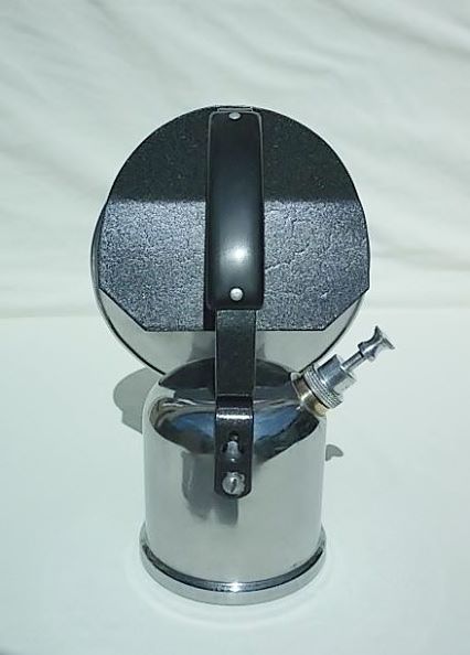

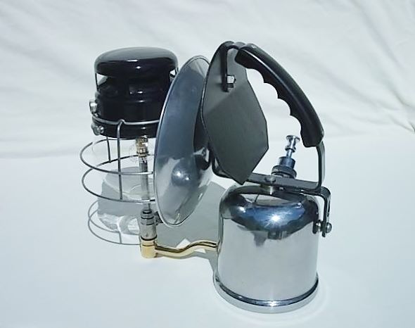

    I just enjoy fettling these types of lamps, and that's not just for their diminutive size, they have a certain charm about them, that's brought to light as you move through the cleaning up process.
    Eventually, on 'clunk clicking' all the parts back together again, the photo session looms 'a near'; & it's this reward in itself, that makes these AL's also, a lot of fun . . . .
    I find 'em a very photogenic lamp, they catch the light well, from any angle. . . . .
    Any further info on these models, including how to easily acquire "another track work stand", would be very interesting to hear, hopefully so ?
    I haven't dared to light this one yet, I usually enter a scan with the lamp, during 'burn'; but I hope it's enjoyed regardless. I might give it a shot, around this crimbo time.
    Cheers :thumbup: ,
    Jon.

    That sure is a nice looking lamp! Did you simply polish the steel tank, or have it re-chromed? It looks really shiny. Oh, and please do light it up... how else will you know how well it works?
    Phil
    16,663
    The AL-620 is a very handy lamp and in my opinion it's far less bother to maintain than the AL-15 and AL15-A.
    August 1968 is correct and as it's stamped made in England, that was a tank which they had in stock and steel is cheaper than brass.
    It's a fine lamp, but if it's going to be a user rather than a shelf Queen, then I would change the pump to an X-246 Guardsman lantern pump and I would also change the control cock to a proper brass GF., Jeff.

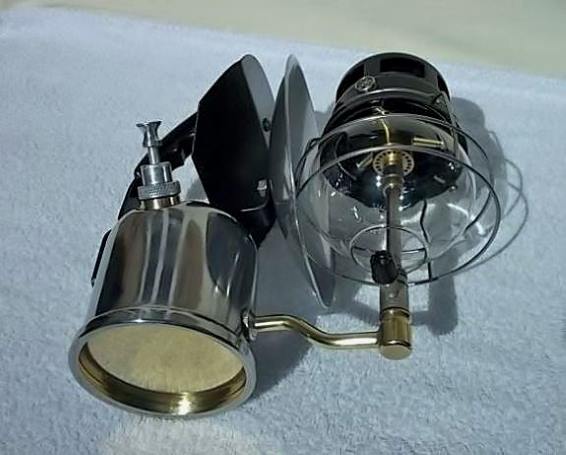

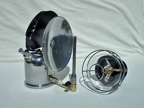

    It's a "No" to your chroming question, all that can be seen of the tank, either the main steel carcass or the brass base plate, has just been heavily polished.
    It all took a hek of a long time, as I did it manually, the least impressive area left visible, is around the top of the tank; it was covered (near enough) in it's original coat of cream white paint, & because that area will be where rain can rest & pool, this maybe where the weather first starts to get behind the paints skin (with the type of work these were used for, way back)?
    The rust had just germinated all around the shoulders, the camera's not too good with 'close up' shots anymore, but it kind of resembles very fine acne scarring; it doesn't depreciate the look of it though, more than anything, it adds to it's authenticity value.
    I'll have to light it, for sure, but will test it without the globe in place & with a cheapo X246B helmet & burner fitted; it's just too nice to ruin all that work, for one safety test run. It'll be a shelf queen, unless I do the dirty, & holler it's potential around the markets !

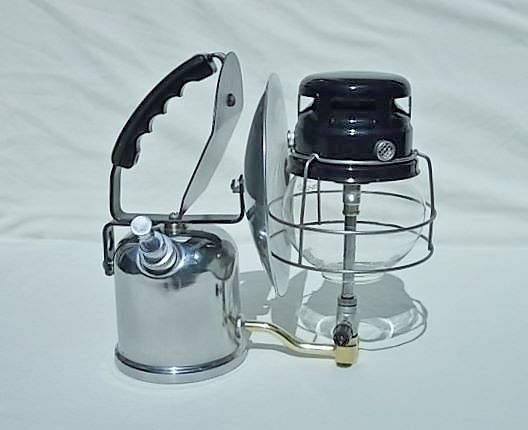

    Thanks for the two tips Jeff, what's shown there is everything it arrived with (pump & control cock, I mean), the control c/k isn't a cheapo X246B replacement (that arrived with it), & added later by whom ever; it's very similar to the very good quality, original X246A stop c/k's. I couldn't be fully sure, but suspect its the one it headed straight out the factory with, in thelate 60's.
    The pump ? Well, I have to 'ditto' there with that too, though it does look like the X246B full pump from the appearance of the thumb fob & cap; it is much heavier & has all the same internals as the Hendons have. If it does go pear shaped mind, I've plenty of X246 pumps from the 50's, infact in the collection I've one that's chromed, so it'd match; I'll give that a go, should it be needed.
    The vapouriser's a good'n, it cleaned up well & gives a powerful yet constant stream, straight up; that's always good to find, all those newer ones loitering about here & there, ought be reconstituted within a girder ](*,) . I find most of those with the brass stop, work very nicely.
    Steel V's Brass ? Steel can be sparked (nearly was last week), brass can't; but from what you're saying, the smelting ingredients or process of brass, must require more labor intensiveness.
    That's got me wondering how many lanterns there are out there, made from Stainless steel; I read the Nite Hawk is, maybe there are other world models/ brands, that will also not rust ?
    The AL620 does look good, mine, well, I'd prefer it to be sporting the track work stand, but until then; I'll be packing it away after it's had its first light (the attached pic's, show the stand it had been bought with, it'll be the shiniest black one there; it was red on arrival mind).

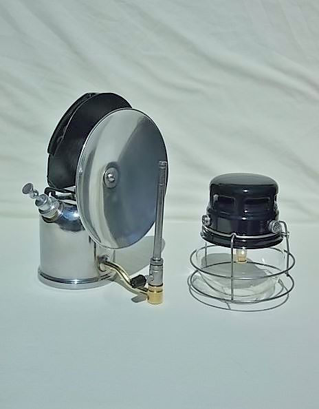

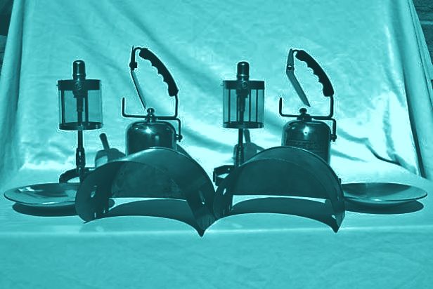

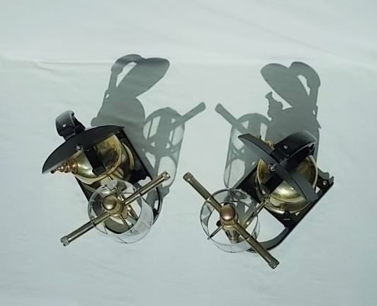

    This picture may show the grotty Cowl canopy, I got the picture order mixed up, sorry (I've three AL15A Cowls); but in any case, the worse one will be redundant' until something 'just right' comes along in the market, I can add it too.
    This shot turned out a bit whacky (It's Zig & Zag, hyper bolting through space on a ragga trip. . . . .. . :lol: .)
    I have to get those cowls enameled, to finish these pictured here; it all takes time, but hopefully I'm nearly there now.
