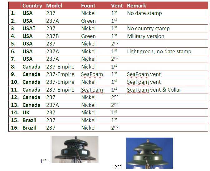

    Hi I am doing some research on Coleman 237 lanterns
    after finding out the variations of the lantern.
    I want to know when the variations were made
    so please dig out your 237's match them to the number in the table below and give me a date of manufacture.
    of course ver#1 is a bit problematic
    thanks in advance for the help!
  2. Mackburner
    I have two.
    3 is dated 12 61 No country stamp on the tank but is does have made in USA on the control wheel.
    8 dated 3 48.
    :: Neil::

  4. listertrucks
    listertrucks Subscriber
    Apr 26, 2011
    138
    Hi Doron
    237A Nickel fount made in Canada dated 11-69 2nd type vent

    Has anybody seen a 237 made in USA with a second style vent?

    15
    Good luck on your research!
    #2 10/69

  10. Dan D
    Dan D Subscriber
    Feb 13, 2011
    374
    I also have two.
    Both style 3 with no country but marked "Made in the United States of America" on the control valve.
    Dated
    2 63

    I've got 2 237s both with first style vent, both undated, both nickle plated; one from the fifties because of the Sunrise logo on the side; one probably from the sixties because it has a decal, don't think its marked "Made in the USA"... other than that no other info...

    My 237A is a 10-72 and is a #2 style

    I have a number #5 dated 2-54 with the second style vent.

    my 237 is 1st type vent with nickel font dated 5 52

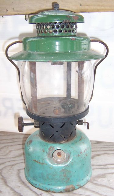

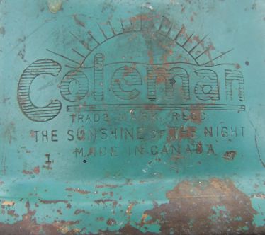

    Here is a 1/47 Canadian 237. I just got it, havent had a chance to clean it up yet. I wish you all the best with your project. feel free to use my pictures if needed. Jim
