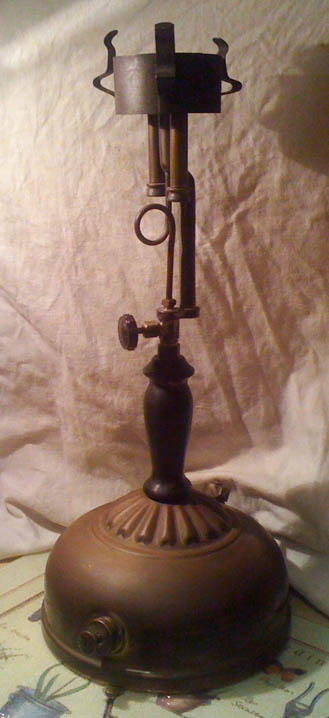

    Hello everybody,
    A friend of mine has an antique Coleman lamp that requires two new mantles.
    Could anybody help identify the lamp? Also are mantles available for this model?
    Thanks very much :)
  2. Neighbor Al
    Nov 21, 2011
    1,062
    Russell, PA United States
    That's a CQ table lamp with a Q99 generator/vapourizer. Very nice that it has the built-in pump.
    This lamp can use Coleman #21 mantles, but some recommend the smaller #20 to prevent heat from damaging the fuel knob.
    Personally, I prefer the Peerless 2C-HG mantles that are likely easier for you to get.
    Tell more! Does it hold pressure? Does the pump work? Is the generator/vapourizer working or fouled?
    You'll need to use Coleman Fuel in this lamp for good operation.

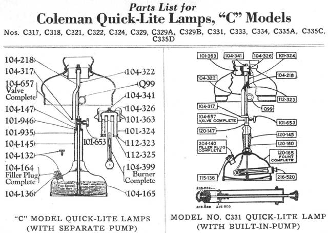

  3. Mackburner
    No this is not a CQ lamp. With that tank and a built in pump it is model C331. ::Neil::

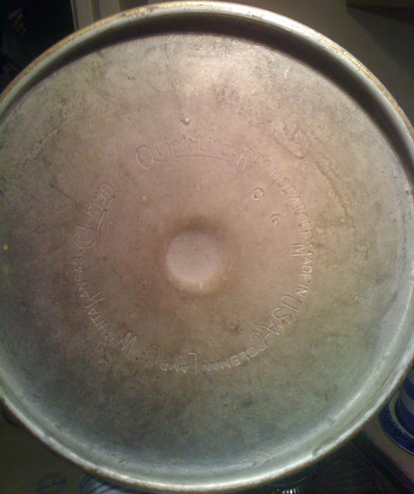

    I ran over to Terry Marsh's site and now I'm confused. Cake444's lamp has CQ stamped on the base, but a pump and Q99 generator that are out of place.
    How do any of us know what it is? (Besides a very nice looking lamp)
    Al
  5. Mackburner
    Yes these are confusing lamps. Mainly this is because Coleman in the late 1920s and early 1930s tended to use up old stock base plates so you get CQ stamped in the base of both C types and some of the Instant-Lite lamps such as 117 118 and 119. This is one area where the info on the lamp does not always agree with the catalouge information. Took us years to work this out. Anyway here is a part page from the 1930 parts catalogue which shows the C and C331 lamps. ::Neil::

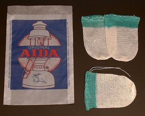

  6. Cake444
    Jan 25, 2012
    2
    Hi guys,
    Thank you for your replies! It’s much appreciated.
    The lamp is fully functional and in good working order but my friend needs some mantles and Coleman fuel/panel wipe to get it started efficiently.
    I can only find mantle # 21's in regulate supply over here in the UK. A bit like the link below.
    http://www.rei.com/product/638672/coleman-20-tie-mantles-package-of-2
    Would these be ok as I will be buying around 4 sets?
  7. JEFF JOHNSON
    16,630
    You can use the number 21 mantles, but the number 20 mantles are better, Jeff.
  8. Mackburner
    Coleman 21s are fine. I know the 20s will work a tad better but I have very few of those and plenty of 21s so that is what I use on these twin mantle lamps. Strictly speaking they are well over size but they do work OK. One thing you might do first though once you have a suitable fuel such as panel wipe or Aspen T4 is try a burn without mantles. A fairly low pressure and pre heat the generator with a gentle blow torch flame running past both mantle carriers and you should get a nice blue Bunsen flame from each. Doing this means you get to know if the lamp will work right without wasting a pair of mantles if it does not. ::Neil::

    One of the risks of using the 21s in lieu of the 20s is that they extend lower and tempt the operator to push out more light with more pressure.
    The heat that they generate has a tendency to melt/damage the fuel knob...
    21s are really just fine, but do exercise restraint on pumping up the lamp.
    Are Peerless mantles unavailable over there? Really a much better product than the Coleman mantles...

  11. David Shouksmith
    I get them via eBay USA from the E. J. Basnett Hardware Company of Houston, Texas. I deal with a chap called Enoch, who may well be E.J. Basnett himself. Their eBay name is 'ejbasnettco'.
    They're very good - always eager to please their customers. I can't remember what the cost was for the last batch of mantles I got, but they were very reasonable indeed.
    They also have fuelcap seals for Coleman lanterns and other odds and ends. I'd recommend 'em... :thumbup:
    Edit - They were $2.25 for a packet of four + $1.97 S+H. A total cost of $4.22 (=~£2.70) i.e. less than 70 pence each...
  12. WimVe
    3,530
    If we are talking baout the same:
    U-shape mantles
    And they speak english too.

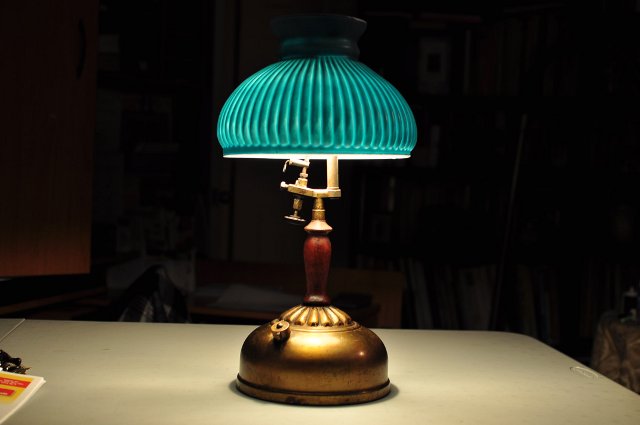

  19. Mr. Lantern
    Dec 30, 2014
    18
    I know that this thread/post is a few years old but now my interest is leading me towards getting a Coleman indoor lamp such as the model discussed above, the C331 along with the Coleman 118 colored glass lamp shade, such as the one pictured below. Looking for this particular style & shade?

    My apologies but the model (118) lamp shade is incorrect, that I previously posted.
    The correct model glass lamp shade is a Coleman glass ribbed 307. Believe it came in three colors, white, green and salmon/pinkish, maybe red?
