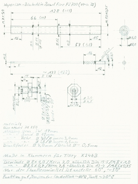

    This is my first Bialaddin Bowl Fire F 2700. I baught it in 2015.
    After a complete service and first time running i give it a new paint and my self made vaporizer. Finaly it becomes the original Vaporizer & Preheater with a glassfaser wick and a parabol in better condition. I'm very happy with this heater and use it very often.
    Regards, Frank

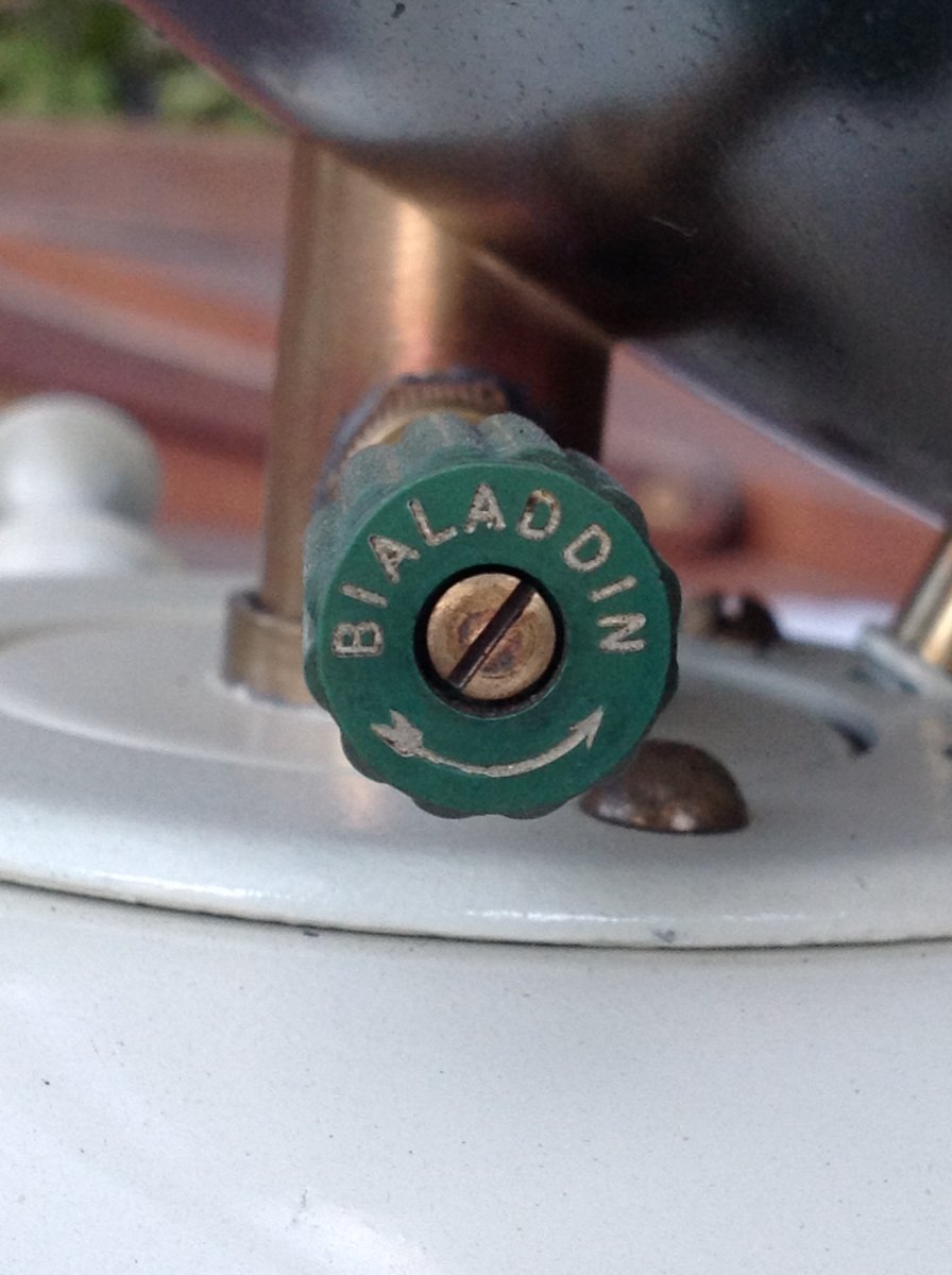

    image.jpeg ... here the color i used.
    Regards, Frank

    Fine workmanship with the machining. There could be a market out there for them!!

    1 question:
    How can i change the knob positions from the pictures.:doh:

  9. David Shouksmith
    If you can't turn it into a more convenient position without causing damage or leaks, you'll have to try a slightly thicker or thinner washer (i.e. seal) between the tank and the jet cleaner cock. Usually though, if you just use a new seal there, the knob will end up in a different position. That works for me... :thumbup: :)
