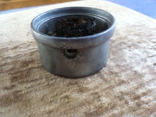

    Also, the spirit/wick cup is different to any others I've seen, with only one hole in it for pouring in the meths, is this original or a replacement from a different lamp?

    I have not seen a meths cup like that one before.

    That is a later Alloy alcohol cup and original to the lamp.

    And thanks for the update on the spirit cup, was wondering if it was original.
