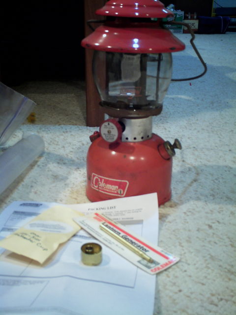

    I just got the parts in to convert one 6/65 200A into a kerosene burning 201. The lamp doesn't really lend itself to a pre-heater cup since getting the spirits in is going to be a challenge, but what the heck!
    Pleasant surprise that the parts were cheaper to order directly from Coleman than anyone else. (I did take advantage of a running discount program they still have out there.)
    Here's a question: I'll get a 201 label to indicate that it's a kerosene lantern, but would you paint it another color (blue?) to make it obvious?

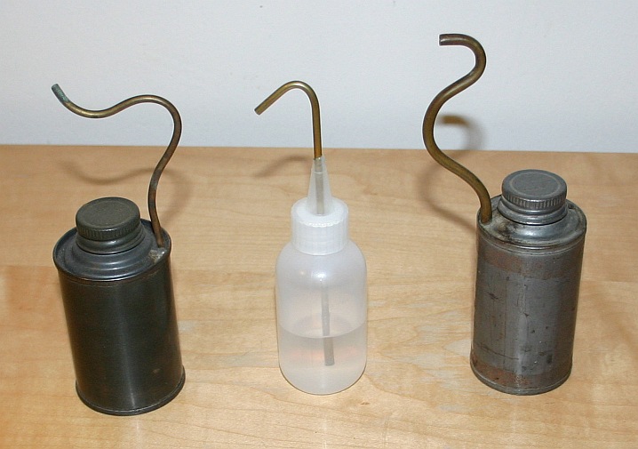

  12. JEFF JOHNSON
    16,663
    I use one of those Coleman meths bottles and it does the job well.
    In the video glue is used but I would not use glue, I would fit a rubber washer to make the seal, so that the pipe can still be moved as some lanterns are wider than others, Jeff.
  13. Dan D
    Dan D Subscriber
    Feb 13, 2011
    374
    I have not had the problem described in the video. I like the ability to move the tube up and down as the level of meths in the bottle changes.
    The only modification I did was to bend the tube downward. It's much easier to get the meths where you want it, especially since you usually squeeze the bottle. With the original set up, with the bottle at an angle, the tube is parallel to the cup, requiring a bit of control to not over shoot it. (or maybe I'm just a klutz :) )
    If you decide to do this mod, be sure to temporarily stick a wire in the tube first, otherwise it will crease when bent.
    Picture includes some other examples of meths bottles.

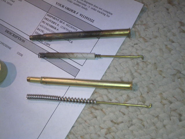

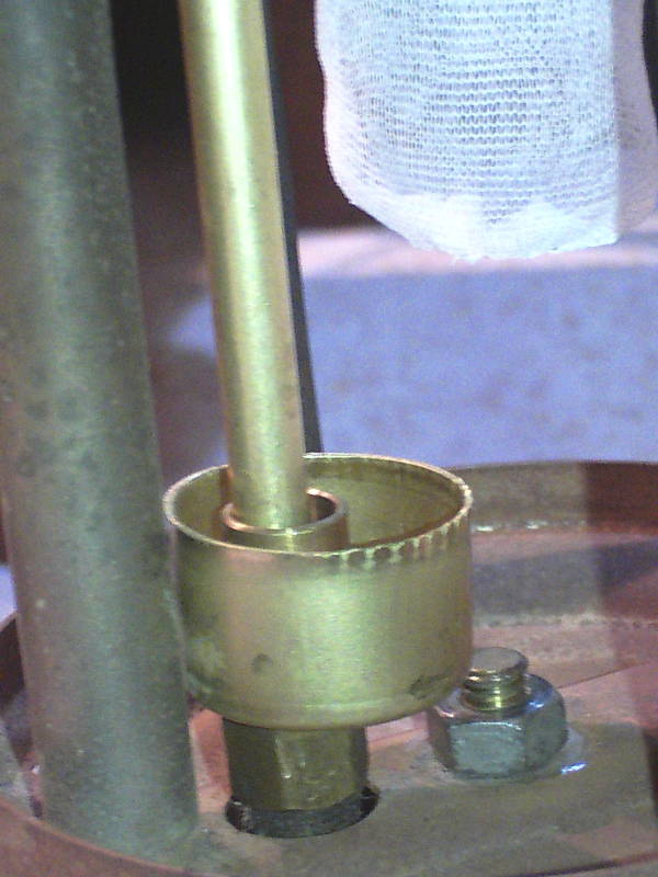

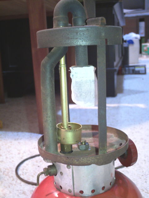

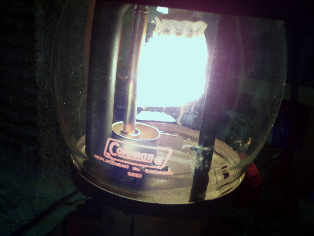

    All of this is probably nothing new to you folks, but here are some more photos of the work in progress. Replacing the generator and installing the spirit cup was remarkably easy. It was so easy that I never so much as cracked the mantle that was installed!
    I've also included a photo of the guts of the Coleman fuel and kerosene generators. The CF generator has a paper liner, and the kerosene generator has a thicker spring. I understand that the kerosene jet is a smaller diameter...
    1325215622-Generators_opt.jpg 1325215605-Installed_1_opt.jpg 1325215613-Installed_2_opt.jpg 1325215630-Flame_On__opt.jpg

  18. JEFF JOHNSON
    16,663
    Hello AL, I have had a look at your photos and I do not see the clip which holds the meths cup in place.
    That clip is needed in case the lantern is knocked over, if that happens without the clip being fitted the meths cup will move and destroy the mantle.
    A metal cable clip will do the job, just clip it onto the the air pipe and shove it down to hold the meths cup in place, Jeff.
  19. Neighbor Al
    Nov 21, 2011
    1,062
    Russell, PA United States
    Jeff, THANKS!
    I just went back to the 201 part diagram and now I see it there. I'll do what you suggest to make sure that it can't move.
    Happy New Year!
    Al
