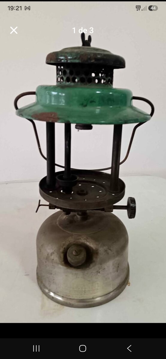

    Hello,
    Could anyone please i.d this model? I read it was Canadian and ran on kero.
  2. ROBBO55
    4,439
    It looks to be one of the 242 variants. The generator looks to narrow to be a kerosene 249
    If it's Canadian it should be stamped on the side of the fount.
    242 & 246 letter variants, 2243
  3. Adolfo
    Adolfo Chile Subscriber
    Apr 3, 2023
    202
    Chile
    Thanks ROBBO55,
    I see the metal collar is missed, am I right? I checked your attached list but I couldn't find any model like the one I submitted.
  4. ROBBO55
    4,439
    Yes, the collar is missing.
    The wing nut on top isn't original, and neither is the Tee handle on the cleaning needle arm.
    It's hard to tell from that one picture and I'm no expert on Colemans. It could be the larger 237, 237A, 237B
