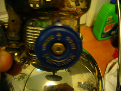

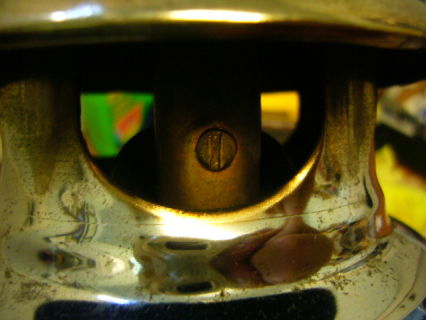

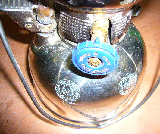

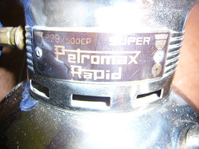

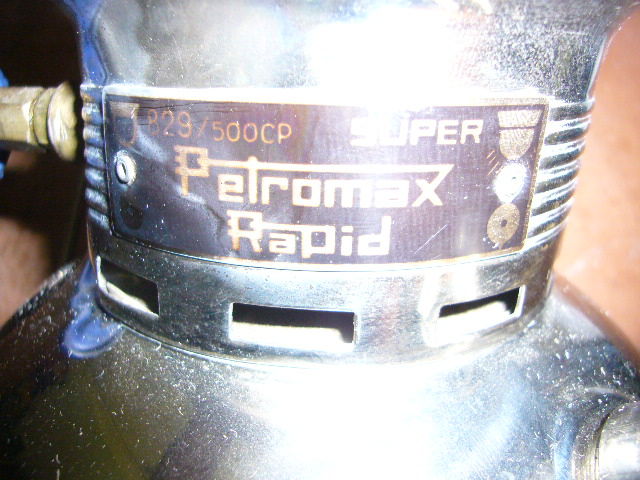

  12. Big BTU
    Feb 24, 2011
    67
    Hi Bob, the lantern is an 829/500, my manometer isn't working but I am only pumping about 20-25 strokes. There are no cracks on the nozzle, in fact I can't even get the nozzle off, the ceramic appears to have become one with the metal...I have other Swedish Kero lanterns without the manometer so I know not to overpump. I have adjusted the air fuel gap with the tool and it has a new jet and needle adjusted to the right height. I feel it is just not containing the flames within the mantle. the mantle isn't burning but at about 50% brightness and there is a soot line that starts on the mantle if I leave it burning too long.
    Thanks for the help.

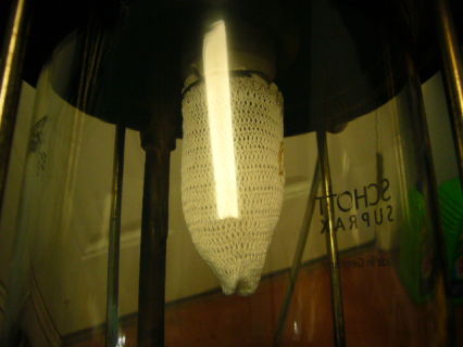

  13. Nils Stephenson
    3,384
    It definately sounds like it's getting way too much fuel. You could try raising the mixing tube another couple of millimeters. Looking at the picture, the mantle does look a little small.
    Btw, you will have a hard time overpressurising the lamp with the built in pump. It needs to be pumped until your thumb hurts.

    I think Nils may be onto something. Just for S and G's raise the air gap to its maximum and see if the lantern gets brighter. Sooting means RICH. So does lack of brightness. Your shutter is inline so no adjustment has been made. I have had lanterns do this before. They were stinkers when burning. When I maxed out the air gap they cleaned up. Once you raise the gap, then you might get some "response" out of the shutter. As for pressure, you'll get "P'max Thumb" before you overpressure it.
    Bob
  15. JEFF JOHNSON
    16,663
    The mantle which is shown in your photos is far to tubular, the Petromax style of burner system needs a bulbous shaped mantle.
    This keeps the vapouriser at the proper temperature to vapourise the fuel, if the vapouriser is not kept hot enough, then you will have the problems which you have mentioned, Jeff.

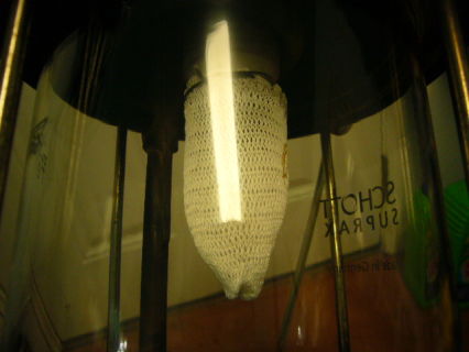

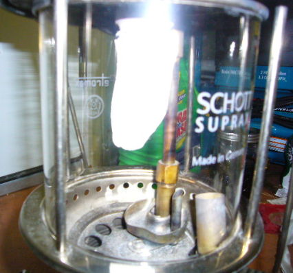

  16. Big BTU
    Feb 24, 2011
    67

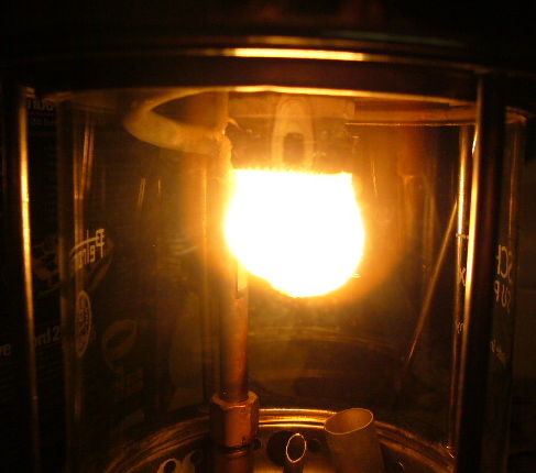

    Hi all,
    I have taken all your suggestions, I moved the mixing tube up to the maximum the lip is now level with the edge of the hole, I switched the mantle out to a bulbous one unfortunately I only have 350/400 CP of those, It seems to be burning much brighter and the flames are more see through now but I still have the halo.
    Oh I also fixed the pressure gauge.

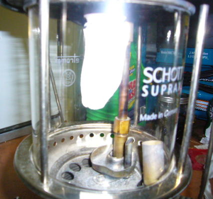

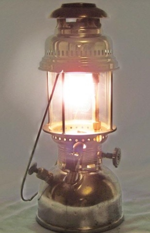

    What is the consensus on the halo now? I have included two pictures, would they perhaps go away with a 500CP mantle that was bulbous?
  17. Bob M
    Bob M R.I.P.
    334

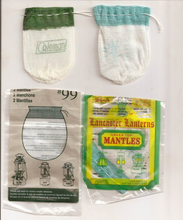

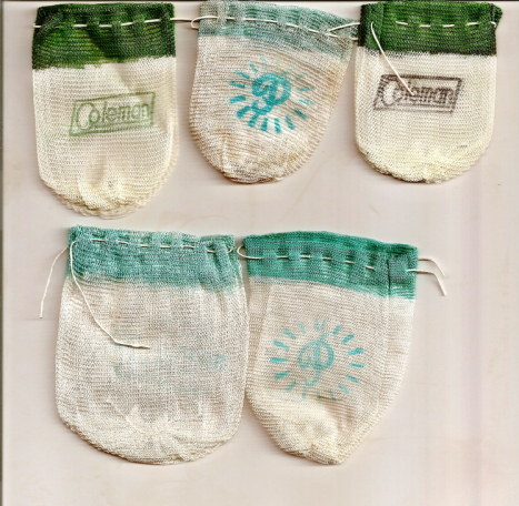

    Though it is hard to see because of the BRIGHTNESS. This 829 is burning a Peerless 111 500 CP thorium coated "Coleman style" mantle. Its additional length might be what's needed. If you have some Coleman #11 mantles, tie one on and see if that cures the halo. From the looks of your images I can see it spilling out the bottom.
    The next image shows the sizes of Peerless and Coleman mantles. Top row L-R: Coleman #99, Peerless 2C-HG, Coleman #21
    Bottom row L-R: Coleman 1111 HiPower, Peerless 111
    The bottom image shows the size comparison between the Coleman #99 and the Lancaster 24A. These are 350 CP mantles
    Bob

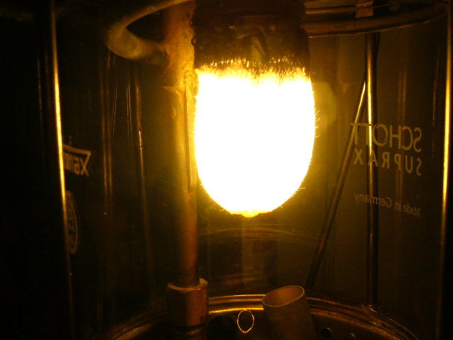

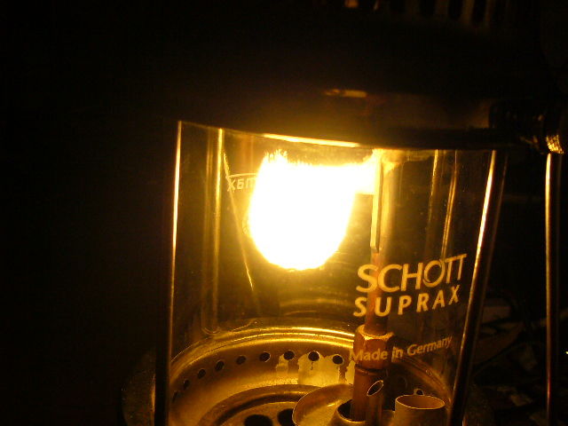

  18. Big BTU
    Feb 24, 2011
    67

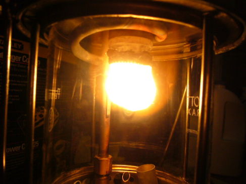

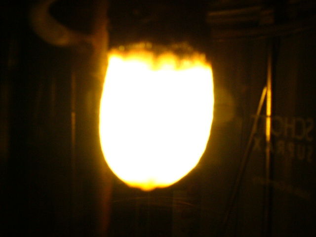

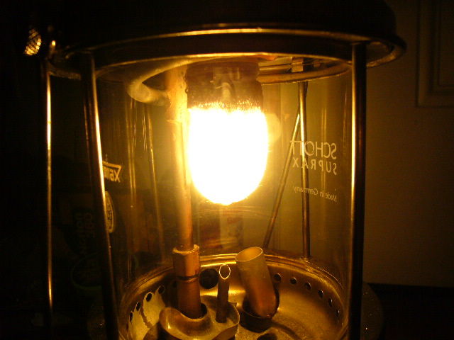

    1318995441-P1120764_opt.jpg 1318995454-P1120765_opt.jpg 1318995484-P1120766_opt.jpg 1318995515-P1120767_opt.jpg
    Well, I went all out, I removed the air mix tube, cleaned it out removed the Burner (original that had been cemented in place and had to break it out. I replaced it with a Britelyt SS burner.
    I put a 1111 mantle in, it is burning much brighter the halo is invisible to pictures but I can still see it it isnt nearly as bad. The mantle isn't the bright white that I am used to burning my Coleman 237 though, more of a bright yellow... Is this burning right now, should I be able to see a halo? To be fair, I can see through it now and it is almost invisible but it is still there.
    Thanks all,
  19. Bob M
    Bob M R.I.P.
    334
    OK, now go back and adjust the shutter and see if you get a change in the brightness. It's just a 90 degree or less adjustment. Maybe now if you have the air gap to big the mixture has gone LEAN. That will reduce the brightness as well. I think that there may be some halo present that when it's running at peak efficiency. But if it's so bright that you can't look at it, how do you tell? Looking through a welding lens? If it's burning bright, and doesn't stink, you've got it made. I'm sort of "spoiled" using the Peerless thorium coated. They out shine just about any mantle made.
    Bob
  20. Nils Stephenson
    3,384
    A 500cp lantern needs a big mantle. It looks like you've pretty well got that part under control. I've never used the 'Coleman style' mantles, so can't comment there. I would suggest to play with the air gap now. As mentioned, it's probably running too lean now.

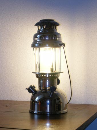

    If you click on the link below you will see my Petromax 829 lit, Jeff.
    http://0flo.com/index.php?posts/9380
  22. Big BTU
    Feb 24, 2011
    67
    Hi all,
    OK, I lowered the mixing tube a bit, doesn't seem any brighter I figure I am getting 350CP off of it, it doesn't look anywhere near as bright as your examples. It is still halo ing but you can see through the halo now, I take it this is the regular operation of the lantern?
    It must be the mantle, it has at least shrunk up quite a bit more than when it was running way too rich. I need to get ahold of some Peerless I guess as all I have are the Goldmann (Trojan)1111 mantles.
