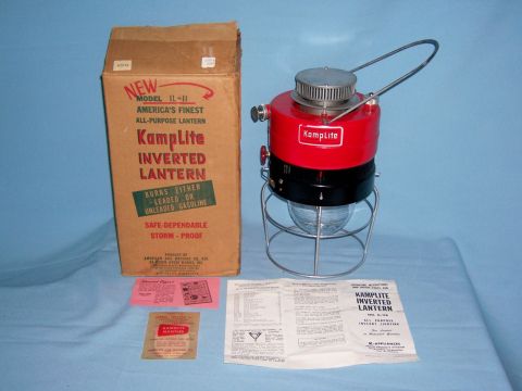

    Never fueled or fired and never will be.

    Nice one, Bob!
    It looks the same as my 8321 which isn't too surprising given the company history there.
    I've never run mine (which I'm a bit in awe of, i.e. terrified) because it's inverted, petrol/Coleman fuelled and I've no instructions.
    Will you be scanning yours and posting them hereabouts..?

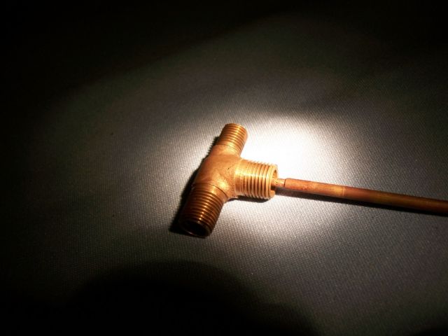

    they have a very common issue when trying to light after a long time not used.
    they have a very fine screen on the fuel pickup tube that gets clogged.
    so if it does not burn from start that is one of the first issues to look at (besides NRV, pump leather, pump seal and usual...)

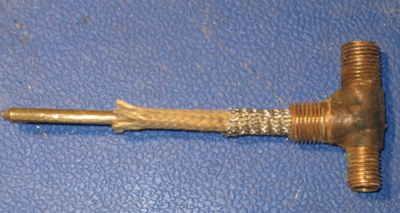

    here is my fix as I couldn't find a very fine brass mesh I used a fiberglass string and stainless steel mesh to hold it in place, that worked well :)
    after that I was told I can find a fine brass mash in Coleman 220 generators between in the internals and the jet.

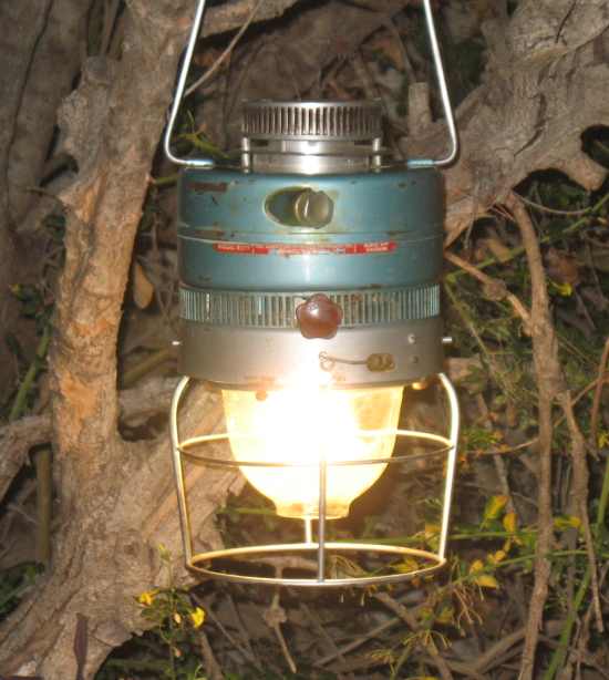

    here it is fired up

    That IL-11B booklet has been downloaded to the archival data section. It's full size as best as I could manage. NICE fix on the inlet screen Doron! That fuel orifice is SMALL. It appears as a black dot just to the left of the "shoulder" in the fuel/air tube. So one can see why the screen is so important. If plugged the best way to tell is to invert the lantern and it will run, turn it right side up and it will go out. That tube by the way can be unscrewed from the valve body for a thorough cleaning. In the words of Homer Simpson, "MMMMM! Donuts!"

    I'm jealous of the unfired-yummyness of this one.
    They are great runners, and no more dangerous than any other gasoline lantern.
