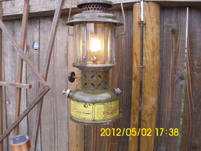

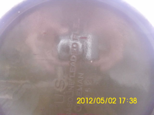

  4. Matukat
    13
    Recently acquired this 1952 milspec Coleman- 12.50 plus 17. for the pump and spares cap. First time I have had to remove a checkvalve. Not sure I did anything by doing so, but it finally started running after my fettle... ;)
