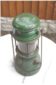

    Hi I thought I would share my first restoration and repair with you all perhaps this is not quite up to the standards expected but it is my first attempt and I know nothing about lanterns except what I learn on here and what I get from the members .
    Before

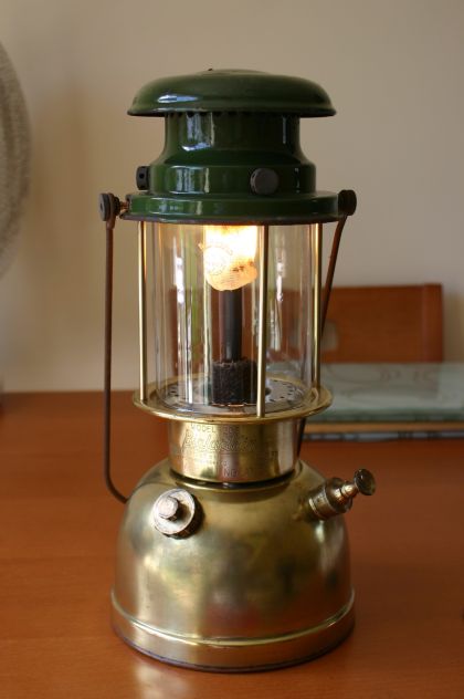

    After
  2. Mackburner
    The expected standard is up to you. You have to do what pleases you not us. We have people who like to make them look new and others who leave them alone and just make them run. It is the difference between those who like to say "this is what it looked like when it was sold" and those who say "this is an experienced lamp and you can tell because of how it looks". In between is a good clean and fettle to work.
    These are nice simple lamps which normaly restore well and function pretty good too. Nice job. ::Neil::
  3. Deider
    Jul 18, 2011
    8
    Looks like a nice cleanup to me. :thumbup:
    Good job!
  4. wilf
    May 30, 2011
    11
    nice job :thumbup: what did you use on the hood?
    wilf
  5. netsniper
    Jun 24, 2011
    111
    Hi Wilf most of the marks on it were only surface marks so I just cleaned it with Braso which is something I use on the chrome on my car.
  6. Mackburner
    'Orrible stuff Brasso. That fluid of the devil is designed to ensure your brass lamp tank stress cracks. It is loaded with ammonia and will damage the chemical balance of the brass. So use it on the hood by all means but keep it away from the tank. ::Neil::
  7. David Shouksmith
    Is there a non-ammonia containing alternative to Brasso , Neil?
    That's if I ever gets around ter polishin' me lamps, that is... :p
  8. pete sav
    pete sav Founder Member
    Sep 7, 2010
    1,182
    West yorks
    I clean enamel hoods and paintwork with scotbrite (like a scouring pad stuff) and T-CUT used for car paintwork
    pete
  9. Mackburner
    Not easy. Autosol is better I guess but even that has a chemical base. Best is to use a polishing wheel and the correct brown soap.
    I remember we had a brass expert give us a talk at an HLC meeting a few years ago. Interesting stuff because he considered a contributing factor to brass founts stress cracking was actually the modern use of cleaners containing ammonia. He suggested that because of these most houses and in particular kitchens, had a certain ammount of ammonia in the air which over some time damaged the brass. His advice was never to use any chemicals of any kind on brass. If you use an acid such as citric or vinegar for instance the brass goes a coppery colour and that tells you that you have actually removed some of the zinc and this will have left small surface irregularities or cracks in the metal surface and these would then expand and weaken the brass when further chemicals are applied such as Brasso or other polishes containing chemicals.
