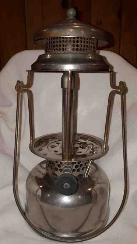

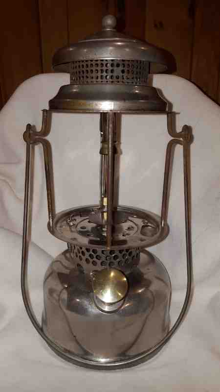

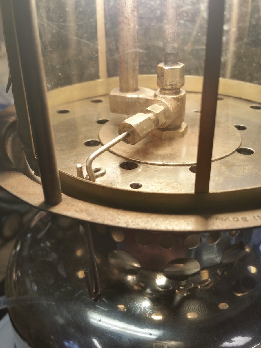

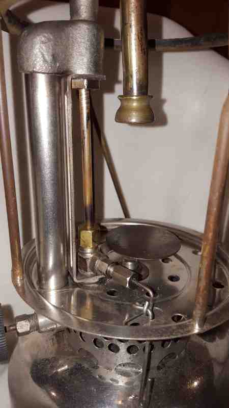

    Recently purchased this and cleaned up. It is a Storm King configured with thin generator for match lighting. Tip cleaner with 90° bent rod. Burns unbelievably well once cleaned up. A doorless mica is on the way for it.
    I cannot find a model number listed for this one in Neil or Terry's work.

    I have never heard of your lantern. That is beautiful.
  4. Mackburner
    This lantern with pricker unit at the bottom of the generator is an instant lighting burner not a match lighter. In other words in theory it needs no preheat at all and you manage the fuel/air mix with the control in much the same way as a Coleman Instant-Lite. We don't have a model number for it because we have no paper describing or illustrating the model. They are not common although I have seen maybe three or four in the past ten years or so. ::Neil::
  5. JRdaSconnie
    Aug 1, 2012
    64
    It may be instant lighting in design, but in my limited use of it thus far I went with match light as the description as it was more accurate from a user's perspective.
  6. Mackburner
    As a user I agree they are not really an instant light but that is the design and has to be how I describe it. What I need is paper to give me a model number. ::Neil::

    I agree not common but not rare either. I have 3 of them myself and have seen about 12 in the last 3 years. Still a cool lantern. Wish we could find paperwork on it.
  8. Mackburner
    More about than I knew of then. They are an interesting beast. I suspect that the Instant Light function was always tricky. If I remember right the valve unit has to be squeaky clean to work well. ::Neil::

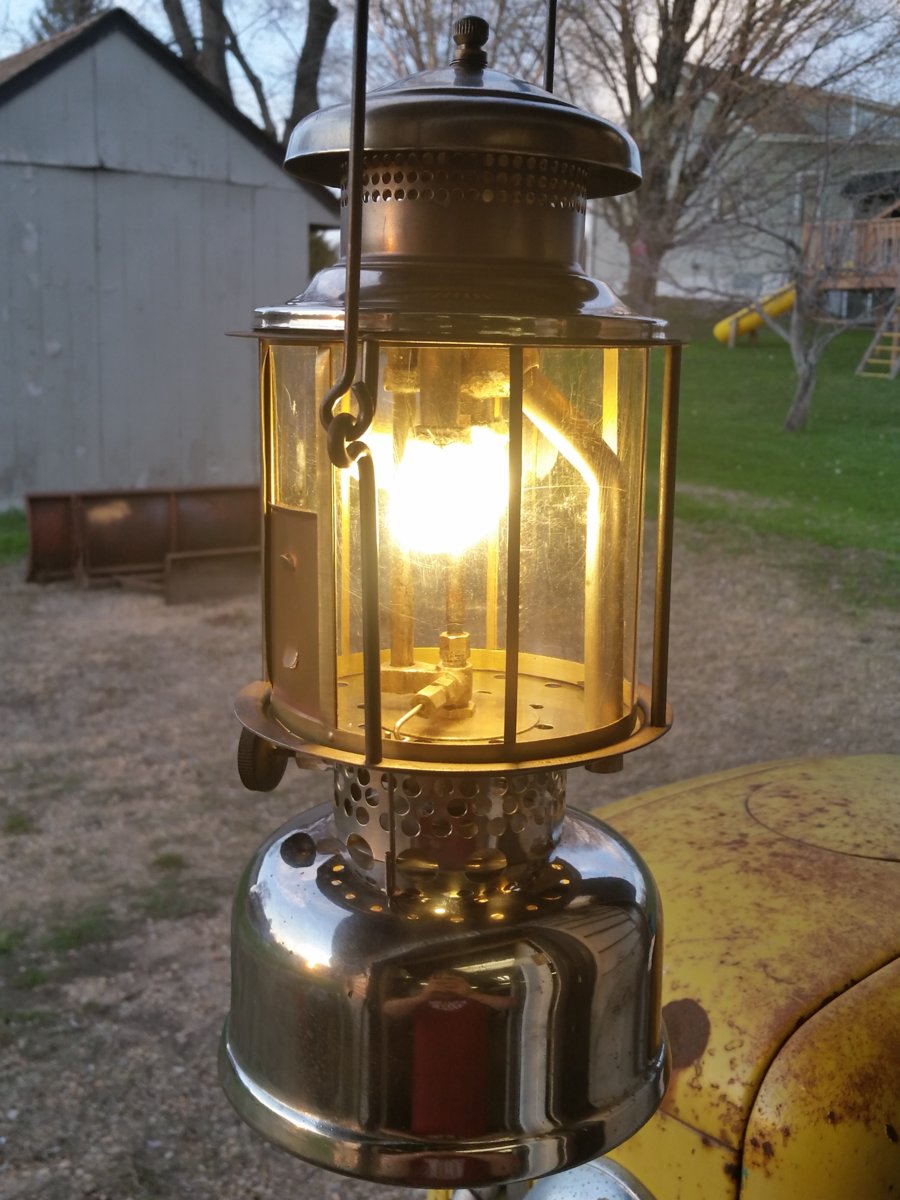

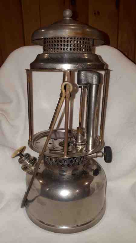

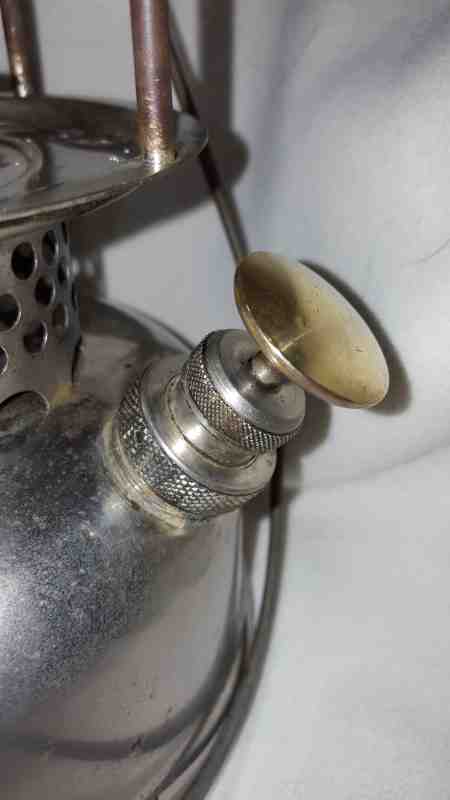

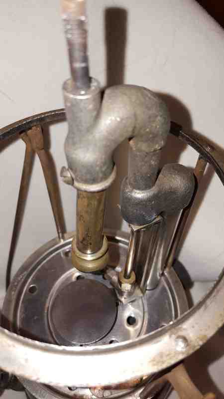

    Here's mine, one of the nicest running lanterns I own. 20190425_195435.jpg 20190425_195319.jpg
  10. Mackburner
    We now know this is a Nulite Model 8 lantern. Made in the 1930s to at least 1942. ::Neil::

  15. WimVe
    3,530
    The vent top, ring with holes, is different between the lantern and the advertisement.
  16. Tony Press
    Tony Press Ukraine Subscriber
    11,036
    Wim
    The original post in this thread by @JRdaSconnie (first set of photos) shows the hood as illustrated in the advertisement.
    The photo shown later by @Dean D shows a different hood.
    @WimVe @Mackburner
  17. Henry Plews
    3,047
    It's not just the hood, it's a different model. Twin mantle burner and look at the air tube.
    Henry.
  18. Tony Press
    11,036
    Henry
    Indeed you are right. I was restricting my comment to the hood because of Wim’s comment about the hood.

  20. Mackburner
    Interesting stuff. The first lantern in this post is a model 8 with a single mantle burner. I have not seen a twin mantle version before and as Henry says that is a different model and one I don't have a model number for. I think for now I will call this model 8(A) until we find its correct number. ::Neil::
