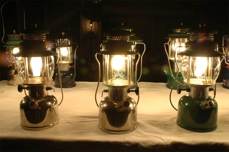

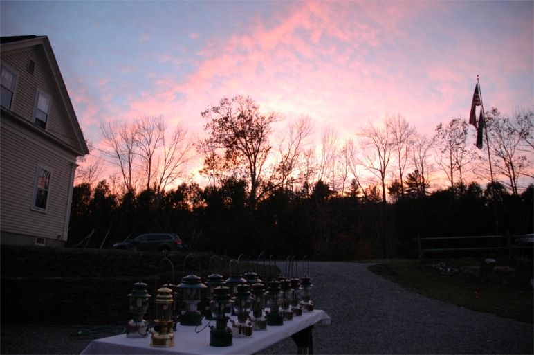

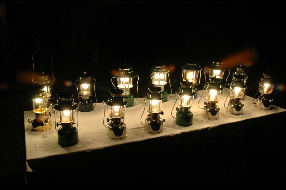

    What a fun thing to do! Don't forget to invite the neighbors and have safe fun with a fire extinguisher nearby. 1295290844-DSC_0025.jpg 1295290945-DSC_0039.jpg 1295291150-DSC_0042.jpg

    Peter - that looks like great fun!
    how did that Pmax clone crashed the Coleman party :?: ;) :lol:

    I dont think so - looks suspicious :lol:

    To these old eyes that looks like the 150version Hipo P-max or Geniol?
  6. David Shouksmith
    Yeah - by the size of it, it would have to be a Col-Max 222 or 333, neither of which I have seen, but if they're anything like mine they'll be chrome plated with a red enamel hat.
    So, I think we have an intruder as you suggest... :lol:

    Good catch Guys! How did you see it was a knock-off? It was an impulse buy many years ago. It’s an American Camper 830/150CP Super (whatever that means). I lit it when I received it and a few days later I tried it again but it wouldn’t incandesce. I then sat on the shelf for a while until last summer I tried again. After several tries and tinkering, including a run with Coleman fuel, it now runs great on kerosene. Now I have a Coleman 249 running well and a 234 that I’m restoring to ad to my kerosene group. Bye the bye, is there a difference between a mantle for kerosene and gasoline? Peter
