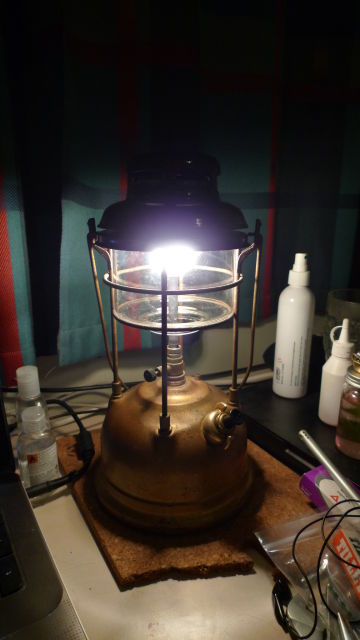

    Hello all
    I was just wondering if there is still being made parts that fit the Tilley X246 Guardsman pre 1960?
    The reason why I am asking is because I wish to buy another Tilley, but I am unsertain if I should buy another X246 or a X246B, which I would need spare parts for in the future.
    I have seen some of the parts to the X246B has the same numbers as on the X246, but do you know of any parts that does not fit?
    How are the Tilley International company doing these days? Are they still making parts and lanterns?
    Here is my X246 that works quite well even if it has just only got a new vaporiser.
