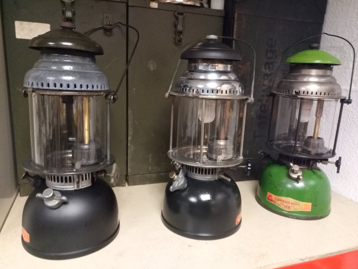

    I now have three lamps that correspond to the Hasag 351.
    Hasag 351
    Mewa 351
    Mewa / Bat 270
    I operate the lamps with a mixture of 15% brake cleaner and 85% grill lighter.
    IMG_20201120_185117.jpg So you start great and run very clean and constant. the carburetor design is also very compatible with petroleum.
