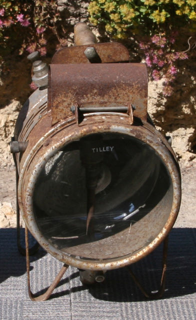

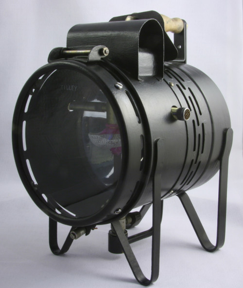

    Picked up this tatty but complete AL-21 at Ardingly Antiques Fair last month - my first inspection lamp :thumbup: .
    This is going to be a user lamp so after a strip down and clean it had two coats of VHT engine paint. Not as pretty as spray gloss, but I used this paint on the wood stove that I took to Newark, so I know it will resist the heat.

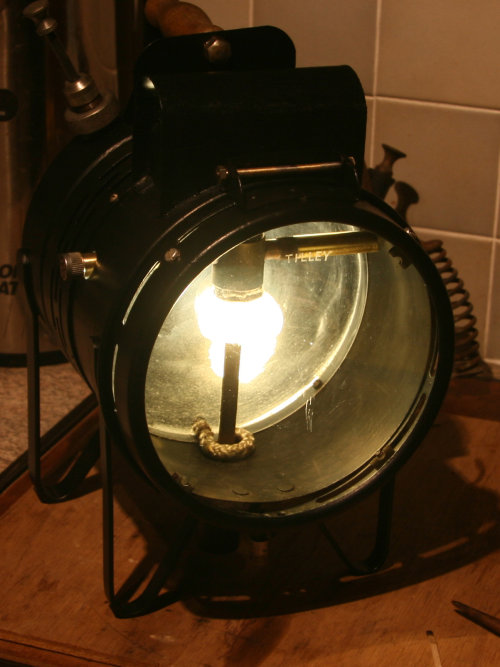

    Not the correct mantle, but it did OK for a quick test run. Also used a coil of woodstove rope as a temporary priming wick. I was a bit lazy and didn't clean out the control cock and fuel tube as thoroughly as I should have so have got a bit of pulsing. Now that I know the lamp is working, I'll dedicate some more time to it tomorrow (4 month old Grandson permitting, who I'm looking after on my own all day!).

    Hello Terry, that's a fine restoration! :thumbup: :clap: :clap: :thumbup:

    Beautiful lamp Terry, it cleaned up very nice.

    Looks fabulous, Terry. Really nice job on the restoration.

    Great job! :thumbup: Did you sandblast the lamp? Are the decals reproductions or did you mask them before painting?

    Stephan - no, I didn't sand blast it. I dismantled it and then cleaned the rust and flaky paint off using a Scotchbrite wheel on a bench grinder. Then used a Dremel wheel to get into the awkward bits. The decals are original and I just painted around them as best I could. The paint was Halfords VHT Engine Enamel Paint. I don't think you can get that exact paint outside the UK - it is an own-label brand from a UK chain of auto parts stores. I can't see the point of using standard auto paint which will just burn off the first time the lamp is used.

    Thanks a lot Terry! Good idea with the Scotchbrite wheel! The one I restored got sandblasted, next time I'll try it your way :thumbup:
