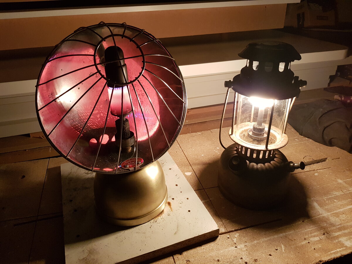

Morning chaps, can I ask what the fount (or tank) capacity is on the Vapalux 300/ Bialaddin bowl fire please. Am trying to do some reasonably well controlled tests for running times/ costs so if any one else has similar info it would be interesting to compare also. Thanking you kindly, Nickyboy
The instructions have 1 3/4 pints (1 Litre). Being an English made product that will be Imperial measure so 35 floz. ::Neil::

@WimVe I'm curious to understand your point. Please see image. The tanks look the same size to me. If you are still confused, please don't reply. If you have anything constructive to add, please reply. The "/" in my post is there for a reason. Am I allowed to test them both at once???

@Mackburner thanks, info greatly received. Am I right in thinking the tank size for the 300 and the bowl fire are the same? Cheers,
@nicky boy I do have a Bialaddin heater, but I think Neil has answered the question as you need. One of the rules of thumb in using these kind of liquid fuelled pressure devices is to fill the tank to about an inch below the bottom of the filler hole (on a flat surface, of course). That allows for airspace above the fuel level to assist in pressurisation and maintaining pressure in use; and ensures that fuel doesn’t leak directly from the filler cap under pressure. Cheers Tony

@WimVe, @podbros. Each has had 500ml of new paraffin into the tank and I'm timing them on my phone whenever I run them. As they are both recent fettles, I'm putting one or both on each night anyway for 20-30 mins. So it will take a good while but I'll work out cost and consumption. The tank size is a separate issue really, I just wanted to get all the facts together. Will post any findings thx.
From the image you are comparing an old Vapalux with a Bialaddin and the tanks are not the same. The instructions for the WW2 period Vapalux state fill with 1 1/2 pints which is 30floz or just a tad under a US quart. I suspect the total volume of both types is near enough the same but consumption is also related to pressure and any variation in air volume and consequent falling pressure in use will make comparisons unsafe. ::Neil::
@Mackburner, just running them as i would usually, to see how much an average use tank costs in each. As said in a previous post, tank capacity isn't really part of that calculation but i suppose I was asking so that I could put a certain amount in when tank is empty and it will be the right quantity allowing for some air also. When the Vapalux says fill with 1 1/2 pints, does that allow for the air that we are always advised to leave in the tank?
Yes the instructions in each case say "Fill with" so that is not the total volume of the tanks but the max fill to allow enough air above the fuel. The lamps are all 300cp and I would expect a burn time of about 6 hours to a pint. The vaporiser for the lamps, lanterns and bowl fires is the same so the burn time should be about the same in each type of appliance. I say "About" because run time will vary as air pressure drops and is also dependant on the orifice size in the vaporiser. It will be interesting to see your results. ::Neil::

So the upshot was basically that in the Vapalux, around 250ml of regular paraffin burnt in 190mins, giving a burn rate of 190/250 which equals 0.76ml per minute. My main aim was to work out the cost of running it though, so I did the calcs on the fuel cost. I bought the paraffin at an elevated cost however from a fancy chandlery so that threw a bit of a spanner in the works! It was 11.69 GBP for 4 litre (!) thus the cost of that 250ml was 0.76 GBP. So for pricey fuel we are looking at approx 0.23 GBP per hour. I've just bought paraffin extra at 2.37 per litre which comes out at 0.59 GBP and 0.19 GBP per hour. I keep my paraffin decanted into 500ml bottles so basically I know I'll get around 6 hours running from one of those emptied into the Vapalux. I hope that has been of interest and also that my maths is sound cos I tied myself up in knots when working out the cost.....!! @podbros @Mackburner @MYN @Fireexit1
