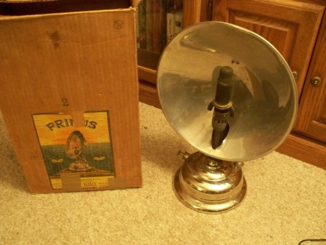

    hello and nice place you have here! I just received this today. 1299997499-000_0496_opt.jpg the valve is really tight. i put some oil down the tube under the burner/mantle holder after unscrewing the top off and removing the jet. an hour later i can turn valve about 30 degree's. felt it (tick) at both ends of turn so i quit. AB =1937 1010 1299997442-000_0492_opt.jpg

    what should i do next? 1299997675-000_0494_opt.jpg I would like to dismantle the valve but need some wise words from you all first thanks

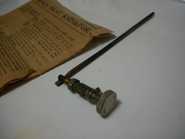

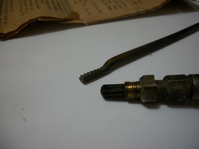

    I just finished taking mine apart.
    I have to upload the instructions still. I apologize for the wait.
    You can see the cleaning needle valve spindle in these pictures. I wanted to make sure that the gears/teeth are in good order. It also tells me how much the heater was used. Which is very little.
    Cheers,
    Jeff
  14. nagant
    Mar 7, 2011
    66
    Don't think these had much use either. had mine going for a couple hours last night while cleaning the garage up. going to go thru it good and do a good cleaning and get some pics. then will put it on the shelf for the season.
