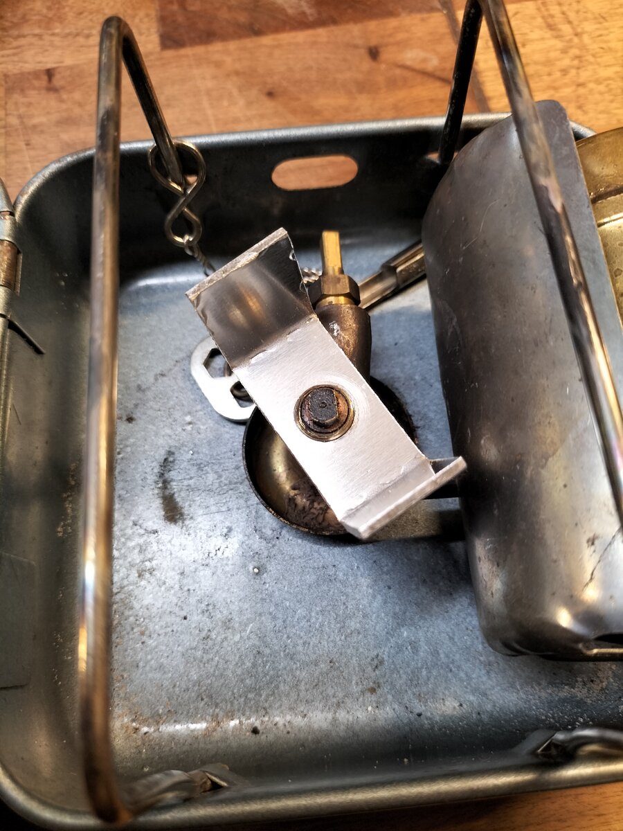

    I've made a discovery! The tap is the same thread that is used on the burner bell of an Optimus 8R!
    As a test, I tapped a piece of 3mm aluminium and it fits perfectly!
    Mystery solved!
