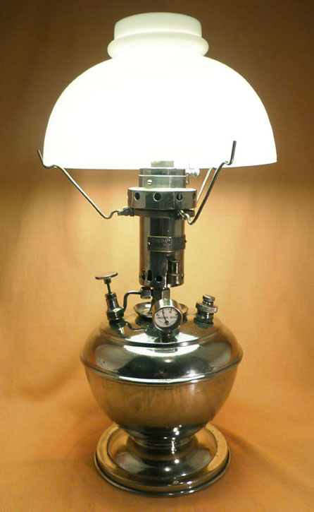

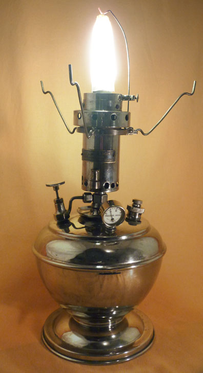

    Hi all,

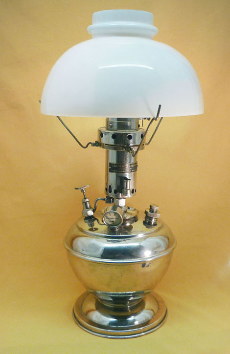

    Santa was nice to me this year and brought me an early Christmas present. I had to do the fettling and clean up myself, but I got a very nice raw material.
    This is a very old, odd and scarce lamp, maybe from the very first years of the 20th century. The brand is Empire Light, and the only information I have managed to find about that company, says that it was present at 16, Victoria Square, Montreal, Canada in the early 20th. This company was probably in some way connected to the Kitson Lighting Co.(1901) GB or the Kitson Light Foreign Supply Company (1902), Willesden, London, as this lamp for sure is a lamp made out of patents held by Arthur Kitson.

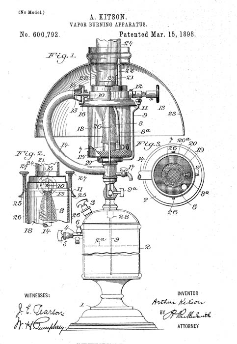

    One of the very first pressure table lamp patents was issued by Arthur Kitson as early as December 1897 (provisional patent). That table lamp patent and others that came the years after had a horizontal, overhead generator, with a mixing tube going back downwards to a nozzle and a Welsbach gas mantle in the centre. Others had a horizontal generator low with the rest of the burner unit with mantle on top, but not the kind of vertical generator as on my lamp

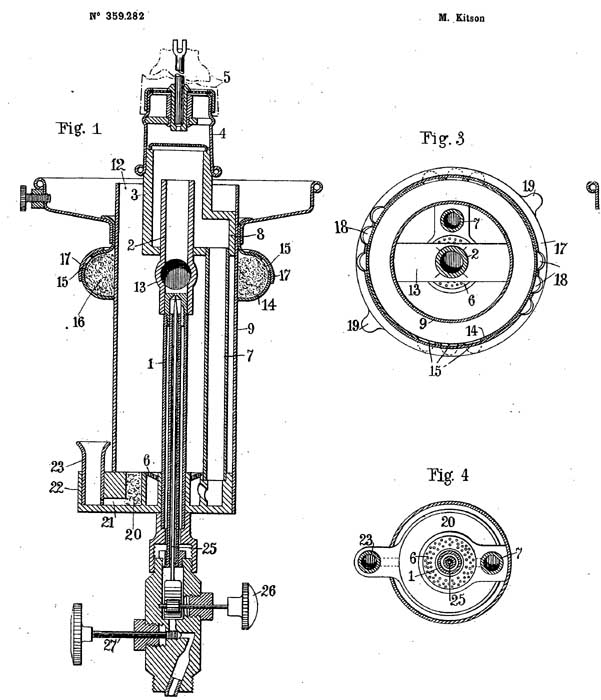

    It took me a lot of research before I could find two patents; one is French (1905) and the other Austrian (1907) which shows the burner on my lamp. The patent show a probable development of the burner as there is a cleaning needle device (control) as well as a centre fuel feed shut of control. The fuel feed on my lamp comes from a device on the upper side of the lamp and support the generator that way. This can be seen in a Kitson table lamp patent from 1901. So……….my guess is that this Empire Light lamp is made around the middle of the first decade of the 20th - 1903-1906.

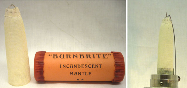

    This lamp came with without a shade carrier, shade and mantle holder. I mounted an 1897 pat. tripod shade holder on the burner unit and a shade that often were used on the contemporary wick table oil lamps as Rayo and Bradley and Hubbard. This shade is also found in the first Kitson table lamp patent drawing, so I believe it may have been the original configuration of this lamp. The lamp looks a bit “top heavy”, but with that column shaped burner unit and a high mantle on top of that makes it necessary to fit the shade at that height.

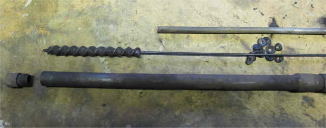

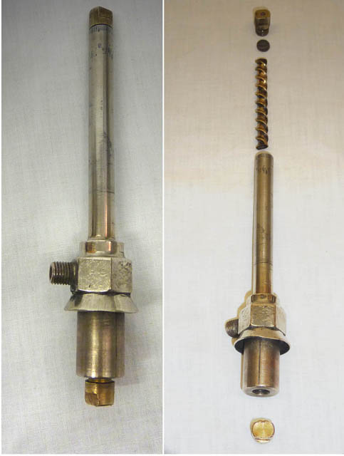

    The burner unit is detachable and is quite unique as it can be put together with the generator by just inserting it. It is also possible to spin the burner/shade unit round the generator.
    The burner unit has a pre-heater cup in the bottom with an asbestos filling. The bottom is connected to the air intake, mixing tube and flame spreader/nozzle by a rod. The whole unit is made of cast metal and should according to the patent be warmed up and maintain heat by the pre heating.
    The nickel plated “bulged” air intake part in the upper part of the burner unit should be filled with asbestos. This for minimizing vibrations and reduce noise when air is sucked into the burner. Mind you that this was important then in the beginning of the century, when the indoor pressure lamps had to compete with the soundless wick table lamps.
    The lamp has an internal tank/fount that is put inside of the nickel plated tank shell but integrated with the connections for the fuel filler cap, manometer and fuel feed unit.
    I’m not sure of the purpose for the cup under the generator, but either a drip cup for the burner unit pre-heater, or a pre-heater in it self, or maybe both.
    The fuel is kerosene/paraffin and the light output maybe 100-150 CP. Any further information of this lamp would be appreciated.

    What a great lamp Conny and top marks for your fettling! :thumbup: :clap: :clap: :clap: :thumbup:
    The lamp is well over 100 years old and it's working like it was new and 100-150cp., would have been an incredible amount of light back then, Jeff.

    Fantastic piece of history and a great lamp to have found and resurected. Kitson is a difficult guy to track down. I have a suspiciion that there were at least two Arthur Kitsons involved in the Kitson business. Either that or he spent 10 years on a ship moving between America Australia and England. The company was called the Kitson Empire Light Co so the name here is as significant as the use of Kitson patents so this lamp surely has to be made by one branch of that large company.
    Arthur Kitson however was not the first or even close. The first pressure lamp was patented by J. J. Riddle 7th February 1865 US46266. OK so not a mantle lamp but it has a reservoir pump and generator. The light was a flare type of course but it is all there just waiting for a mantle to be invented. Then there was my hero George Washington. He invented an upright pressure mantle lamp with a vertical generator incorporating a pricker Pat applied for 17 September 1896 US576523 and then a year later invented a lamp that in operational design was being copied by Coleman and most of the other American companies by 1914. George was simply about 15 years ahead of the competition because before 1900 he had invented all the major design features for pressure lamps that were made from 1910 to 1920 and beyond. ::Neil::

    That little twisted piece in the vapouriser looks exactly like one of many turbulators I have in my wood furnace to force the flue gasses to give away more heat where the tubes run through the water.
    I guess it works in the other direction here, so to speak: to increase the amount of heat transferred to the fuel by forcing the fuel to take a longer route than just straight up through the vapouriser.

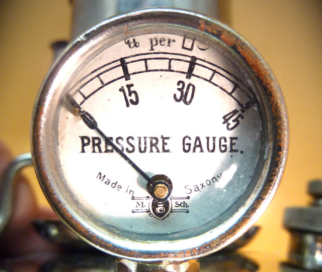

    I noticed that the pressure gauge was made in Germany, so perhaps it's not the original one?
    On the other hand, the text on it is English, so they could just simply have bought in these gauges without having them stamped with their own brand name.

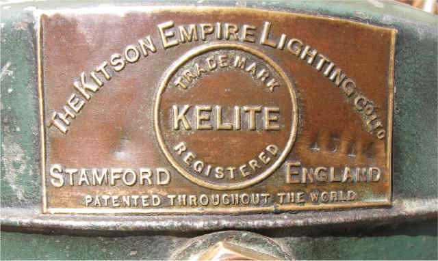

    This has got to be a Kitson for sure look at the wording on the badge it is very similar to this
    Now that is on this lamp i have here
    http://0flo.com/index.php?threads/2505
    Now Neil always says you can identify a maker by the burner but the generator on your lamp is the same as this one in the donut above i had never seen another till your post
    1355848837-IMG_2323_1.JPG 1355848850-IMG_2324_1.JPG 1355848860-IMG_2325_1.JPG
    Looks very similar to me conny

    Christer – I think the pressure gauge is original, possible imported, but has an English text and measures in PSI. In the upper part of the manometer you can see symbols of the PSI, pounds per square inch, that I’ve never seen before. Maybe it is common on the US/GB pressure gauges.

    Yes, I noticed the psi scaling and also the English text as I mentioned above.
    It was just the fact that the gauge actually was made in Germany that made me wonder a bit.
    But it's of course nothing strange that a company buys in ready parts like that, and not necessarily from its own country either.

    Hi Conny yes mine also has a pricker does the spiral in the generator on yours have a hole in to pass a wire through it ?
    The wire pricks the jet and shuts down the lamp by use of the lever on the lamp on the donuts.
    The two green donuts are the only kitsons i have that have a pricker in all the others i have rely on various filters to keep the jet clean?

    Pete, there is no pricker for my generator and no hole for passing a wire through. There was originally a thin 4 cm long pin that was attached to the twirled part, but that pin was broken off and I don´t think it made a big diffrence. Perhaps it was there for keeping it in the middle or upper part of the generator, where heat is most essential.
