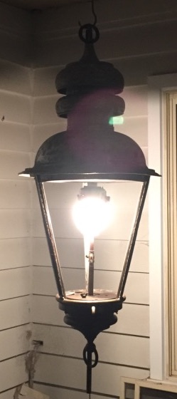

    @Lighthouse , this is the lamp I have.
    Not going yet. I have things to work out yet.
    I did create a Tilux of a sort though. :?

    That looks neat Anthony!
    I must say it's good to see it lit again (albeit with parts from other lamps!). Do you plan on restoring the original Lux burner?
