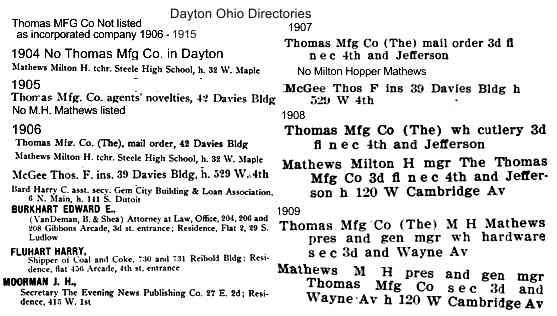

  12. Mackburner
    Milton may have started the business in 1904 but it is curious that he is not listed as living in Dayton in 1905 or 1907 and he certainly didn't incorporate Thomas MFG in 1906. The incorporating directors according to the Dayton Herald 14th May 1906 were Messrs Bard, Burkhart, Fluhart, McGee and Moorman. Milton Mathews is not mentioned. I am suspicious about that incorporation though because the Dayton Directories list the Incorporated companies and from 1906 to 1915 Thomas is not listed. Thomas Mfg is listed as an incorporated Company in the Springfield directories of the period which does suggest that the Dayton Company was never granted a charter from Ohio. The company may therefore have operated as a privately owned company or as an agency of the Springfield Company.
    Milton H.Mathews is first associated with Thomas MFG in 1908 as manager and then as President in 1909. Neil.

  13. Matty
    Mar 22, 2015
    2,586
    Queensland, Australia
    We have had words in regards to your preferred directories method of ascertaining whom was where and what companies were in operation at any given time. Over and over, the directories are flawed. It may be human mistake or in the case of companies it may be because, the companies forgot to or didn't wish to, pay listing fee's. If no fee's were required, human error in compiling the directories is the most likely culprit.
    Correct. However W C Coleman didn't incorporate The Hydro Carbon Light Co, in 1906. I'd be surprised if you thought Coleman wasn't associated with the company. There are reasons why companies are structured as such and whilst Mathews case differed from W C Coleman's, there is a reason nonetheless.
    This completes the circle. We won't be changing each others minds so it is best if we leave it there.
