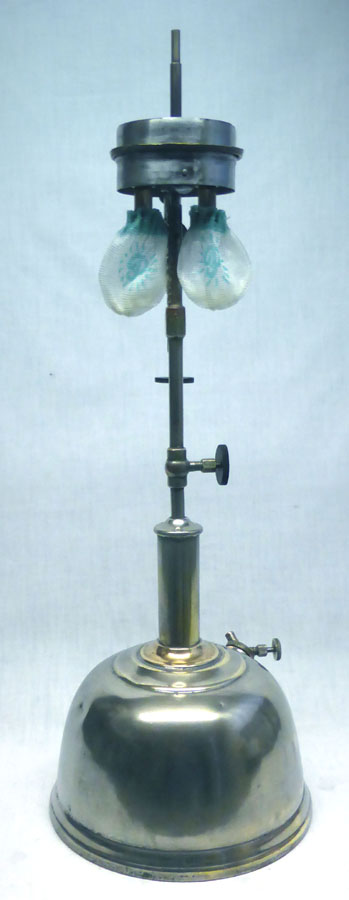

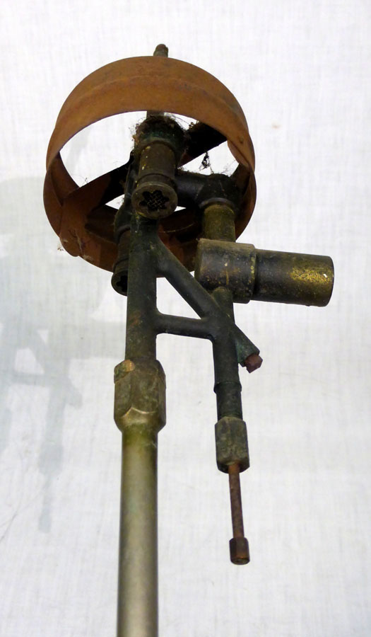

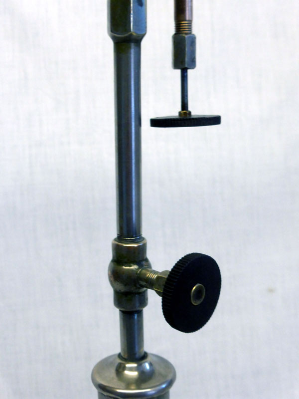

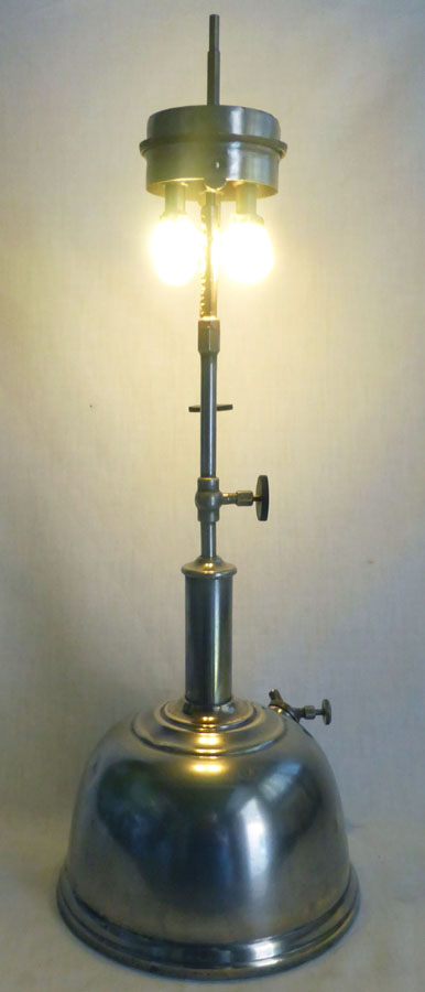

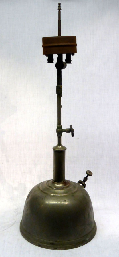

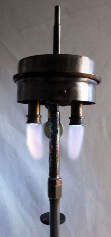

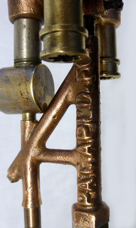

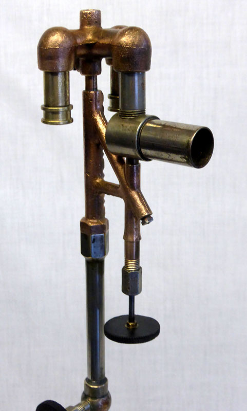

    Hi all.

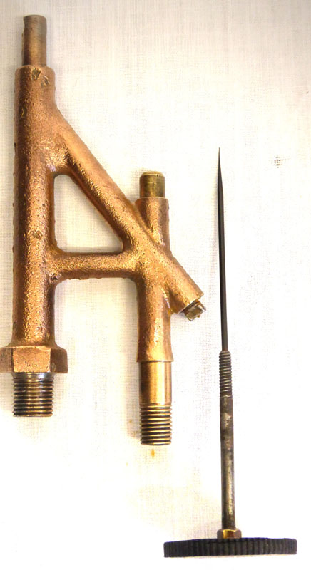

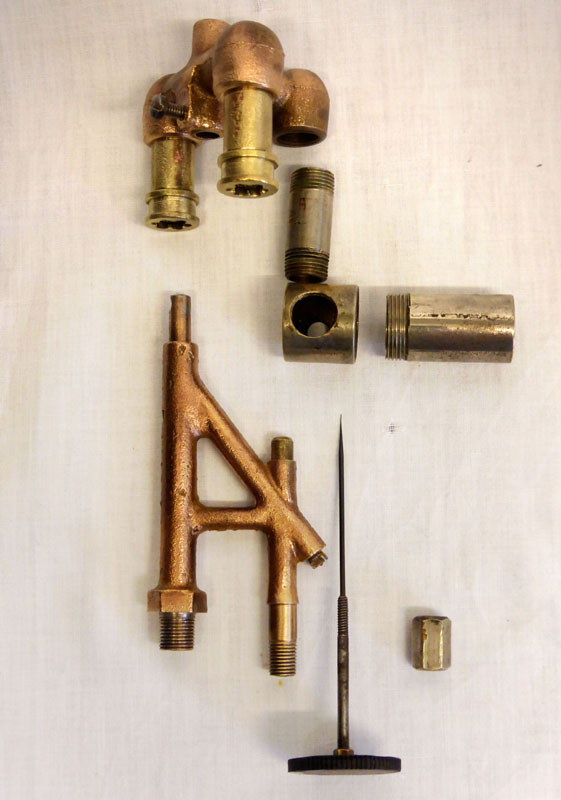

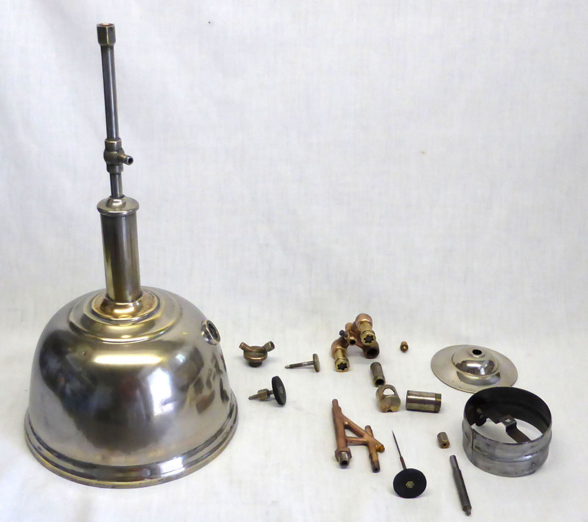

    Here's my restoration of an Economy Lamp Co. lamp from around 1915 - 1920. No markings on the lamp, but this torch lit burner is one type used for Economy lamps and lanterns. The burner casting is very special with an intriguing pattern, and is equipped with a vertical cleaning needle control. This burner is present in a Economy lantern patent from 1915 and is also present on the Economy Model 22 lamp 1919 - 1921. I believe this lamp with a font also used on an early Sun Gas Lamp Co. lamp in my collection, pre dates the model 22 lamp so probably made around 1915 - 1920.
    The lamp came with most nickel plating gone; was missing the cleaning needle control wheel and the heat smoke bell. I decided to try the lamp without a generator restore and it was pretty easy to get the lamp going. Needs a lot of pre heating though.
    I'm glad I can add this scarce lamp to my American old timer collection.
    /Conny
    Economy Gas Lamp Co. lamp.jpg Economy Co. lamp xx.jpg Economy Co. lamp parts.jpg Economy Co. lamp font.jpg Economy Co. lamp fuel filler plug.jpg Economy Co. lamp controls.jpg Economy Co. lamp burner.jpg Economy Co. lamp burner unit parts.jpg Economy Co. lamp burner unit jet and cleaning needle parts.jpg Economy Co. lamp burner unit jet and cleaning needle.jpg Economy Co. lamp burner pat. appl. for.jpg Economy Gas Lamp Co. lamp Bunsen.jpg Economy Co. lamp without shade.jpg Economy Gas Lamp Co. lamp with unlit mantles.jpg Economy Gas Lamp Co. lamp lit mantles.jpg

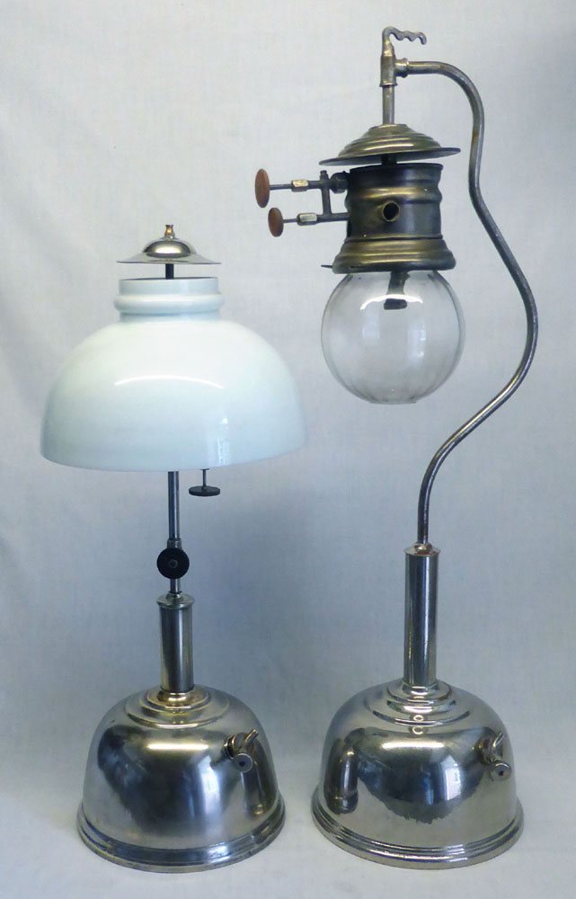

    .... Economy lamp with Sun Gas Lamp Co. similar fonts.jpg Side by side a Sun Gas Lamp Co. lamp (similar fonts).....
    Before restoration....... Economy Gas Lamp Co. lamp before 2.jpg Economy Gas Lamp Co. lamp before 1.jpg

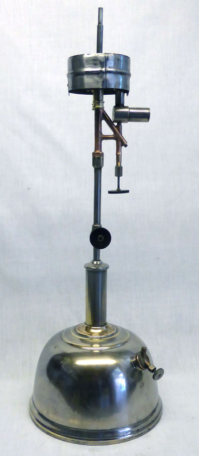

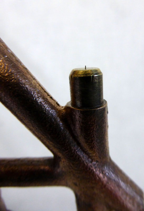

    Hi Conny,
    As always.....awesome. The burner set-up it quite strange, how would the fuel/air mixture flow, might be quite simple, but I'm quite confused by the slanted and horisontal cross on it?

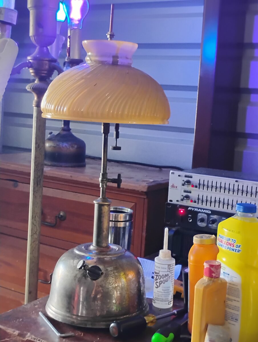

    Is the lamp shade on this lamp original to the lamp? If it’s not, do you know who made that lamp shade?
  9. Conny C
    Conny C Sweden Subscriber
    967
    @Tony Press Tony, This lamp is not shown in any catalogue or ad I know of,
    so not sure what would have been an original shade. The Economy 22 lamp shows a
    dome shade, so I thought it would also be good for this lamp configuration.
    This shade is know as a "Rayo" wick lamp shade and also used on Coleman lamps as the nr 306 shade.
    /Conny

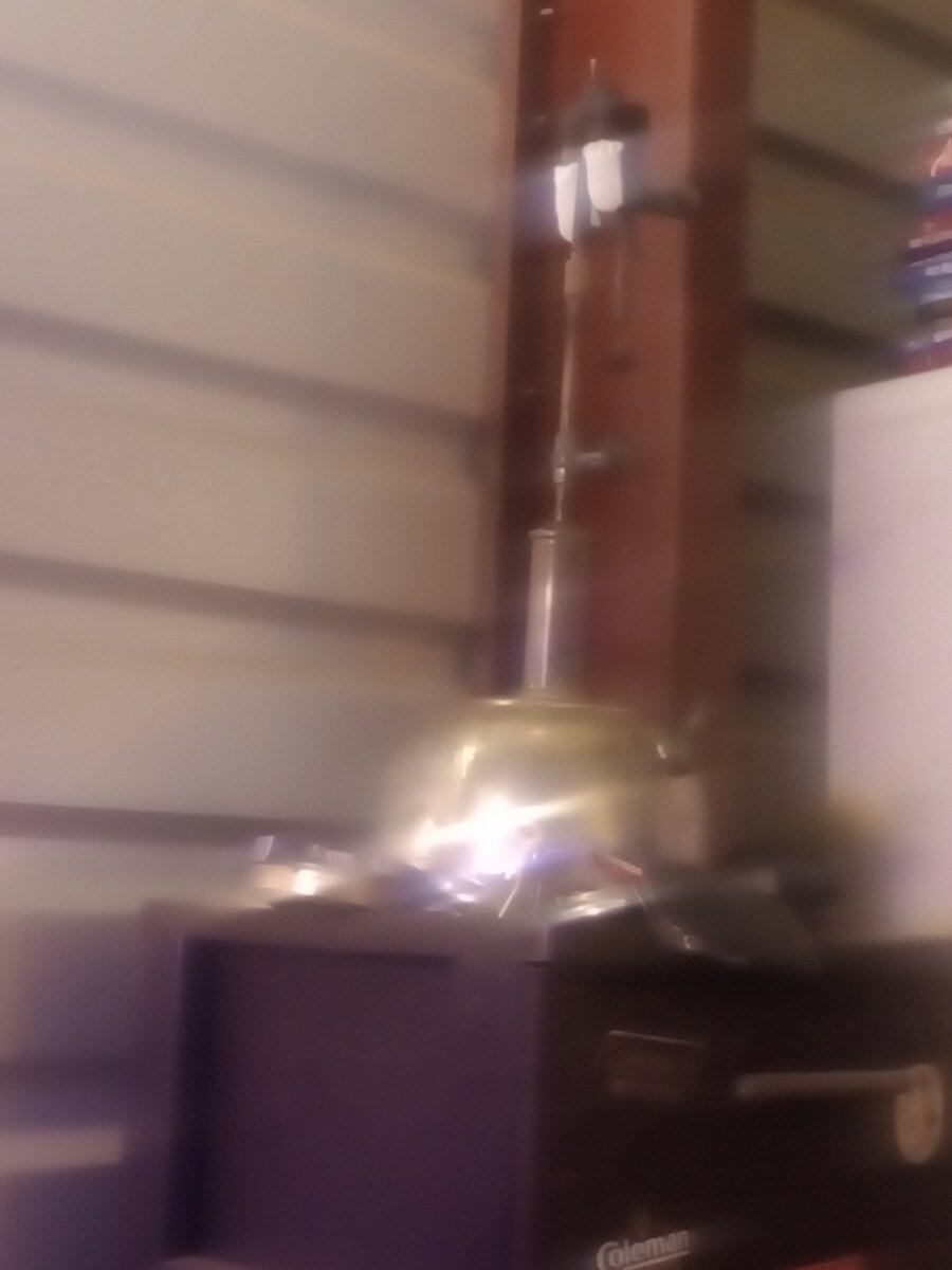

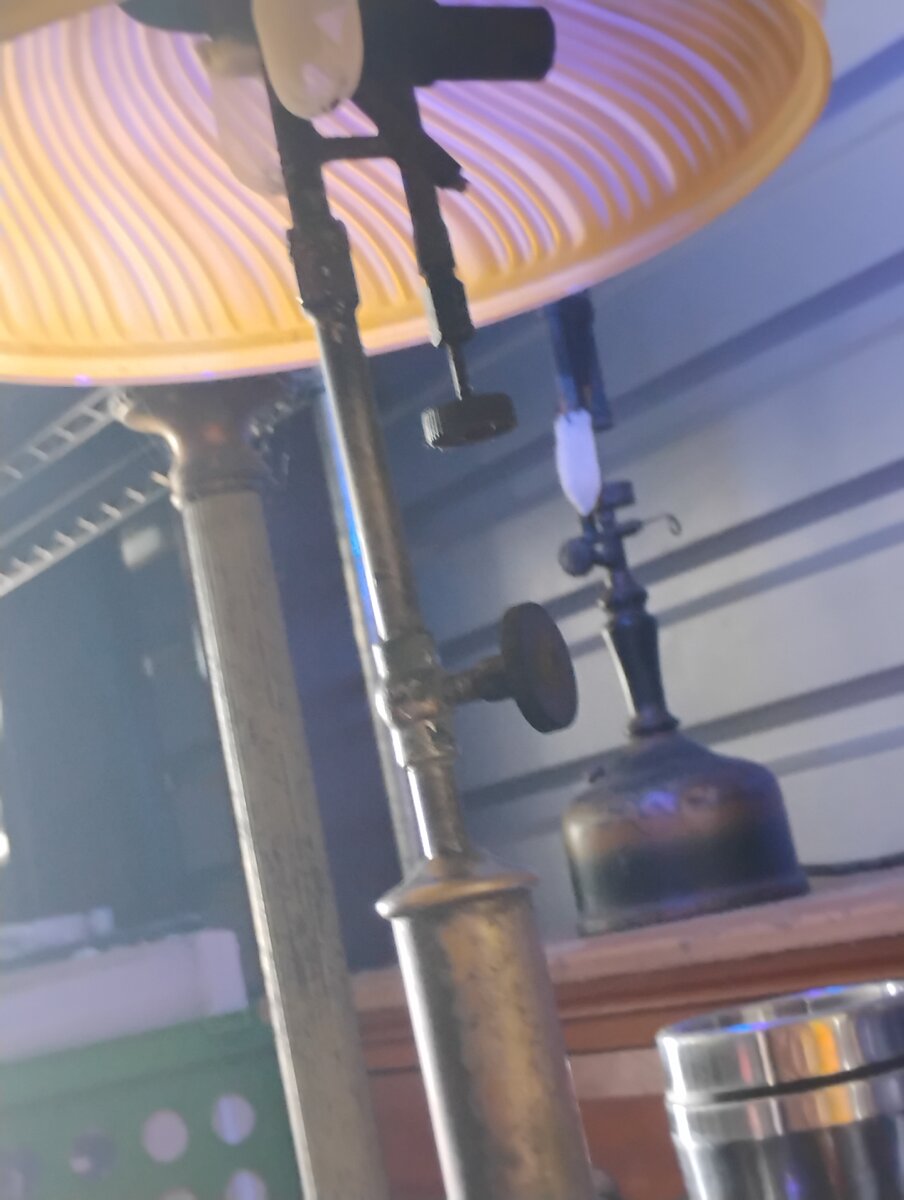

    as well have an econamy model 22 just had a wasps nest or something in the neck ofhe burner otherwise lit right up after tourching it

    here some pics of it it needs a stud shade holder and smoke bell

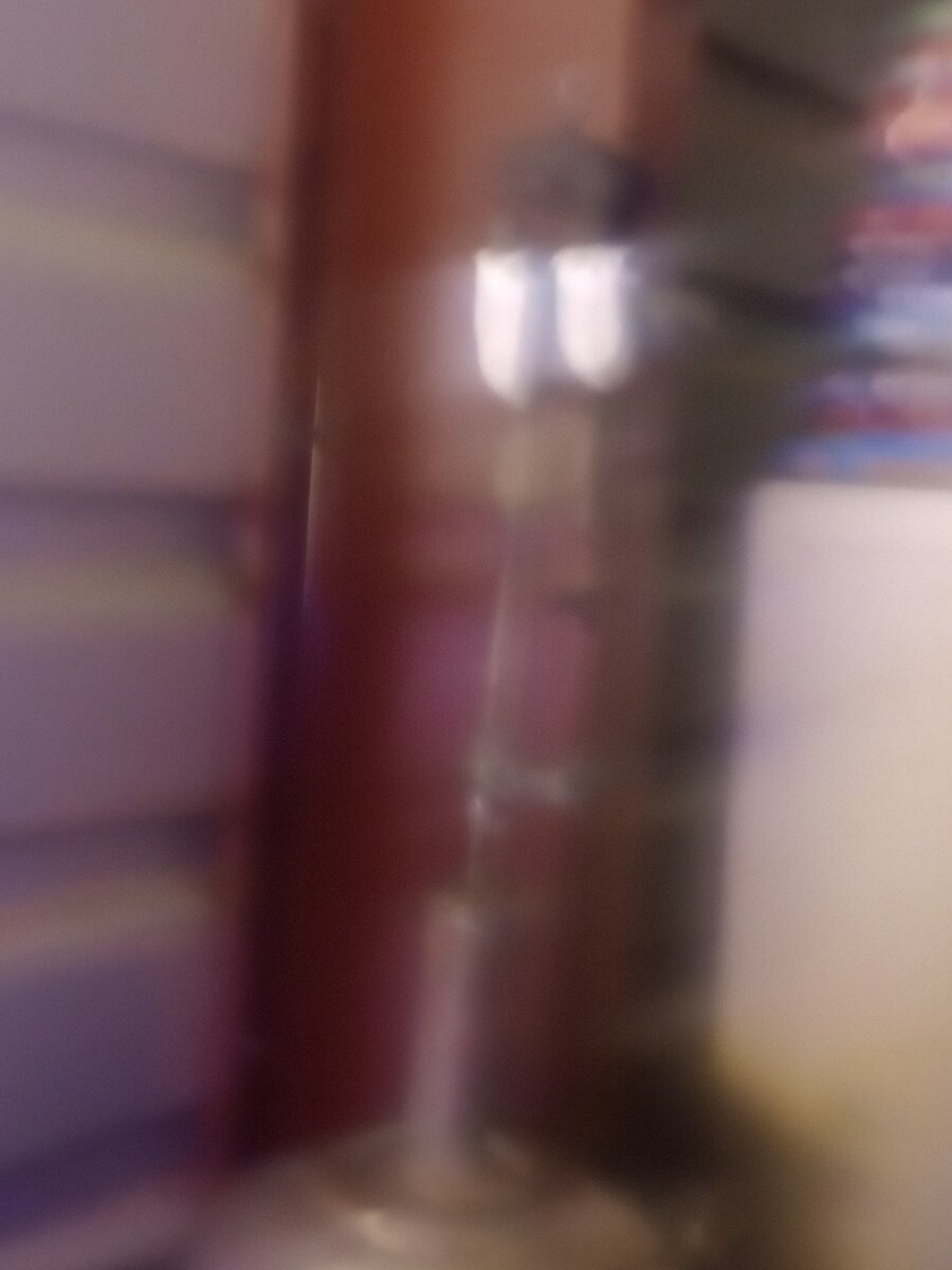

    here is better images of my econamy lamp what about a heat bell for it seems my fount is a little diffrent on the top Conny why don't you light your sunlamp, I would like to see that lit
