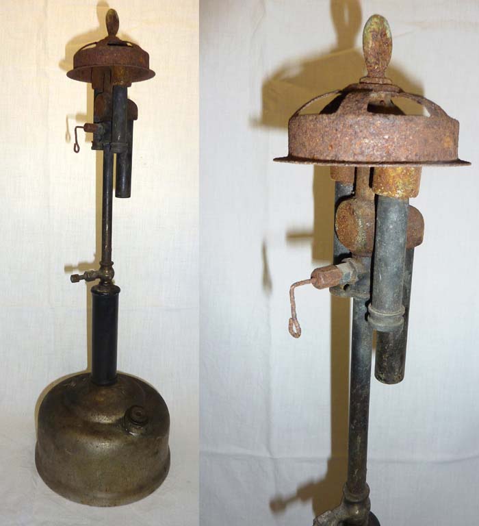

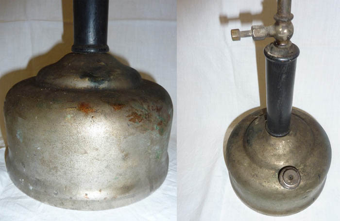

    I got this lamp wreck from England a couple of weeks ago and my initial feeling was not to get involve, not very keen in restoring that one. But this is a rather rare lamp, not seen many, so I thought of having a go and at least trying to get her fired up.

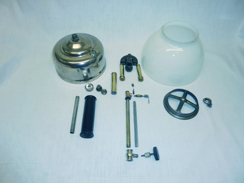

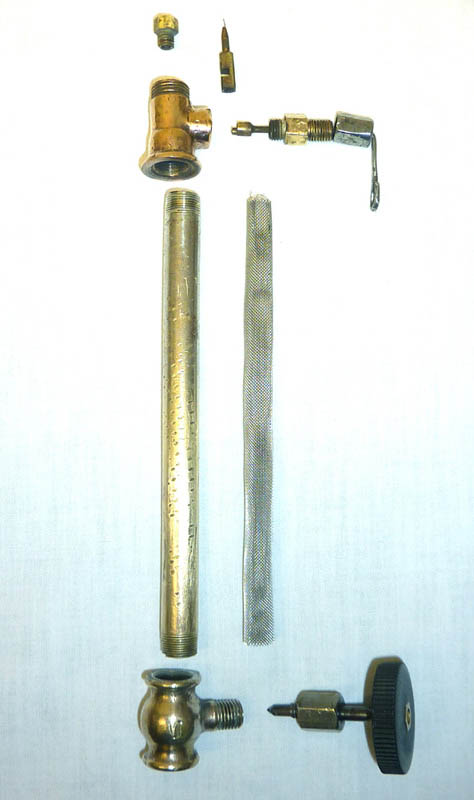

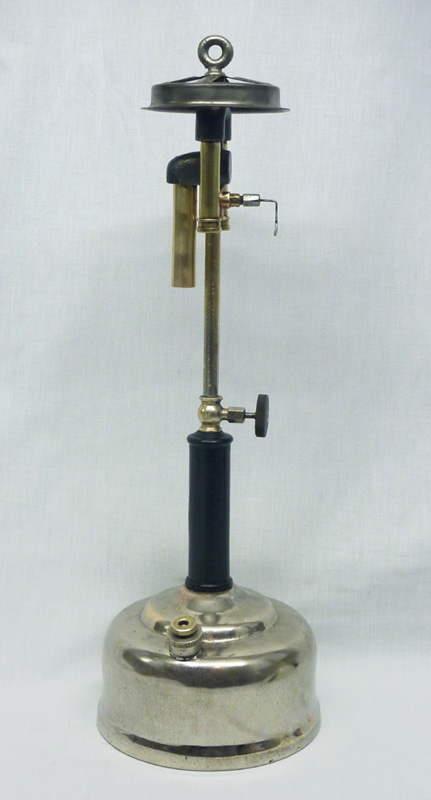

    After a thorough overall clean up, I hade to re-solder the fount to the fuel feed tube, getting a new cleaning needle (used one from another burner wreck) as well as a generator restoration with a new generator stuffing (a rolled steel wire mesh). I had also to find a knob for the positive shut off valve.

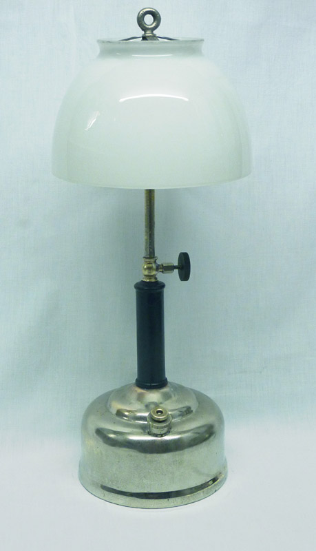

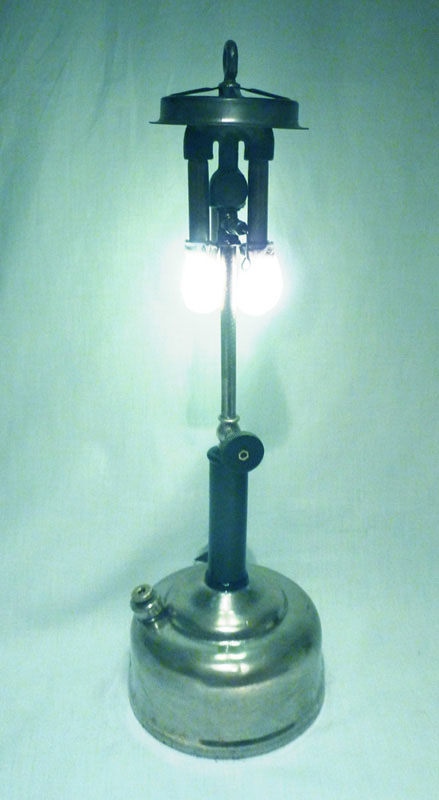

    Assembled all the parts and fired her up and …….ooooops… it worked well.

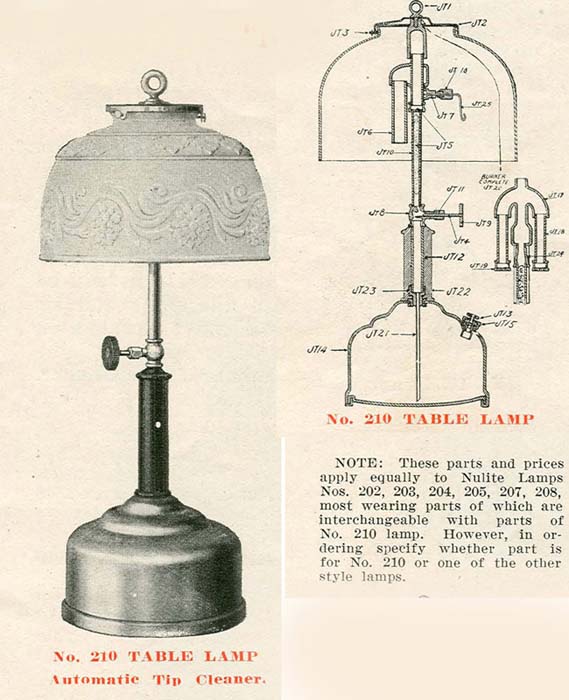

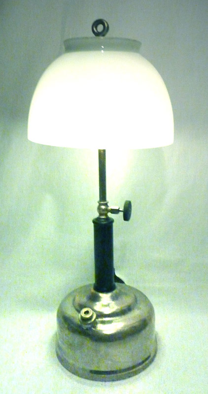

    This is a torch lighting Nulite 210 lamp of 400 CP from the late teens or early 20,s. The 199 embossed opal shade was the original one – see catalogue image from Neil (I believe most of the survivors are in the hands of collectors) - for the 210 lamp, but I found a good plain opal shade that is OK. Turned out to be a good working lamp although it will rest on my shelf now ( not sure I did a good soldering job :lol: )
    /Conny
    1368036422-Nulite_210_lit_mantles.jpg 1368036436-Nulite_210_lit_with_shade_.jpg 1368036458-Nulite_210__without_shade.jpg 1368036484-Nulite_210_burner_parts.jpg 1368036502-Nulite_210_parts.jpg 1368036518-Nulite_210_catalog_image.jpg
    OK then,
    a couple of befores.........

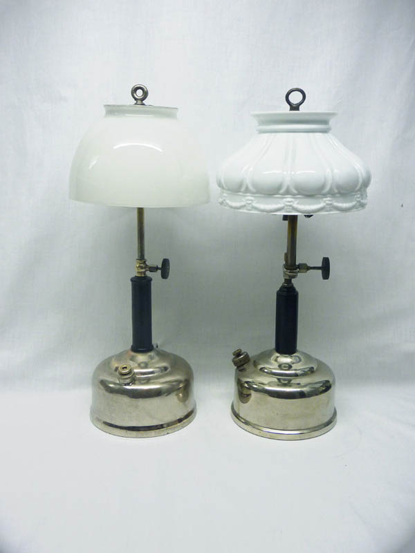

    The Nulite 210 has a similar fount as several other lamps from other makers at that time; as the 121 Utility lamp from Akron and also a Nagel Chase lamp made for Montgomery & Ward - the Superlite lamp (see image below).
