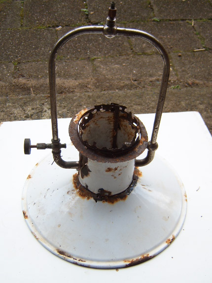

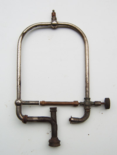

    Thanks to Jeff Johnson's Post 4868 this appears be the remains of the Gloria 90 Gravity fed Outdoor Light.
    Thanks Jeff
    1295758966-Gloria_90_1.jpg 1295759018-Gloria_90_2.jpg 1295759034-Gloria_90_3.jpg
  2. Mackburner
    Colin. Gloria 90 is right. However it is certainly not a gravity lamp. These were supplied either as a Hollow wire lamp like yours or with a tank to make them a self contained light. There is no doubt that is a pressure burner with a supplementary generator heater and should deliver around 500 cp. ::Neil::

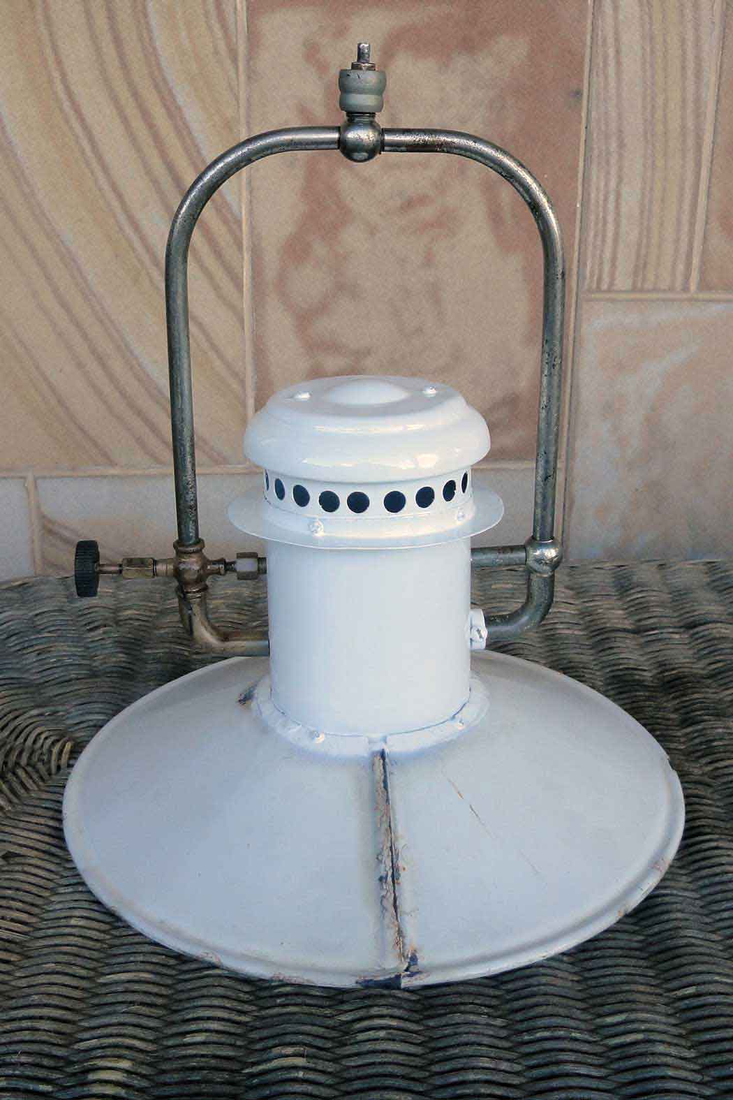

    Well 2 Years on and finally decided to restore this one.

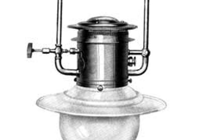

    The only thing I had to go on was what was left and Neil's 1922 American Gloria Catalougue. Nothing appears in the Australian Catalogue.
    Neil's Catalogue.
    .... and the finished Version.
    The Vent is not quite the same but the best replica I could find.
    Colin

    Hi Jeff,
    No Tank, it is Hollow Wire.
    Pleased with the way it came up.
    Colin
