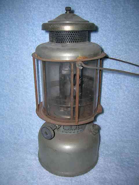

  1. David Shouksmith
    Could someone supply the model number, please?
    This one isn't stamped with a logo or date so I'm presuming it's prior to 1924.

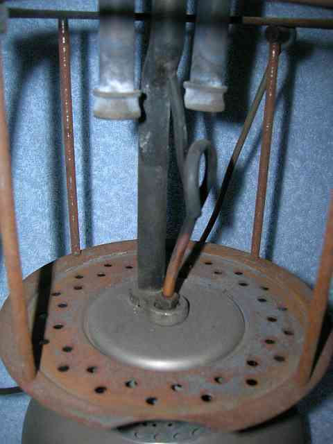

    The bodger seems to have been at the generator on this one:-
    I've a couple of the correct generators in their packaging, but I imagine they're rare now, given that so many of these are fitted with a later generator. So what's to do? - use up my stock of the original generators or replace with the later one - R55, is it..?
  2. Glenn
    95
    David...It is an L327. What is the wording on the ventilator? This looks like it is probably 1921-22. Straighten that Q99 and use it if it is not all plugged up ;)
    Glenn
  3. David Shouksmith
    On one side of the hood it says, "\\\\\\\\\\\\\ Coleman ///////////" - the angled lines get progressively smaller moving away from the word.
    On the other side it says, "THE Coleman Lamp Company WICHITA, KANSAS, U.S.A." The word 'THE' has a horizontal line above it as well as the underscore.
    I forgot to mention that there's a large, raised letter 'H' in the middle of the shoulder of the burner. I've already straightened the generator which does 'pass gas' and temporarily fitted the gas tip to my 252A in an attempt to get that running...
    :thumbup: Thanks for the model number, but looking at Neil's Pressure Lamp Catalogue, is it not an LQ327? - a "re-named LQ; Quick-Lite; 1921-31 w/ no pump. Nickel plated hood. 3 pint fount. First 'Coleman Quick-Lite' in perforations in collar."
  4. furry flivver
    116
    Ariz.
    Hi David: GasPrescue is on the money. Your lantern is actually very easy to date accurately. It is theoretically a 1922. All correct pre mid twenties components, no fount stamping(started in 23',embossed top ventilator(started in 22',deeper bottom plate well and taller version of plate insert. You have a 1922 "LQ"327? The difference between the QL,L, and LQ is fuzzy and overlaps,there could be argument between L and LQ. I am going with LQ because of the precise date of your lantern and company advertising I have seen, and yes I have also seen them labeled L in the ads. So take your pick. As GP said above, straighten the Q99 and use it. If it is clogged PM me and I will tell you how to easily clear it. Or I can post it somewhere on this site, if requested. I have posted it numerous times on CCS. Mike...

  7. David Shouksmith
    Thanks, all...
    Bizarrely, this Q99 is fine - it's straightened up no bother and the jet is clear. It's the Q99 on the Quicklite I posted yesterday that's giving bother with a choked jet. I've nothing small enough that will pass through and clear it.
    If I fitted it into another generator of some sort that was fitted with a pricker mechanism - would that do the trick..?
  8. Glenn
    95
    Yes David....pull the tip, hold with needle nose and heat it with a torch, then run the needle of a 200 lantern generator (if you have) or install it on the R-55 and clean it. Re-assemble and Voila.....good for another 5 gallons or so
    Glenn
