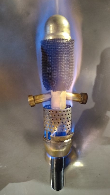

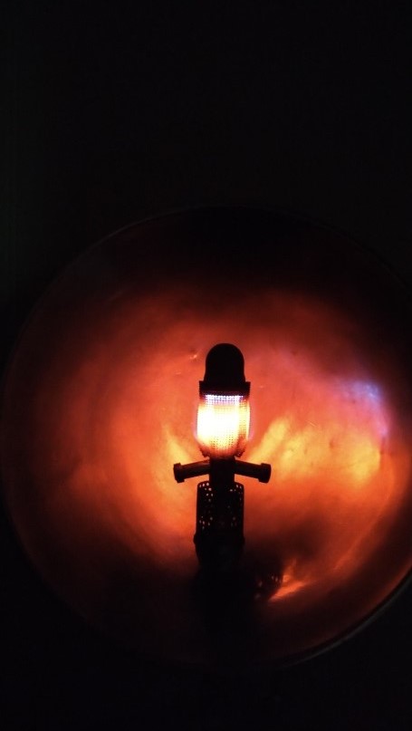

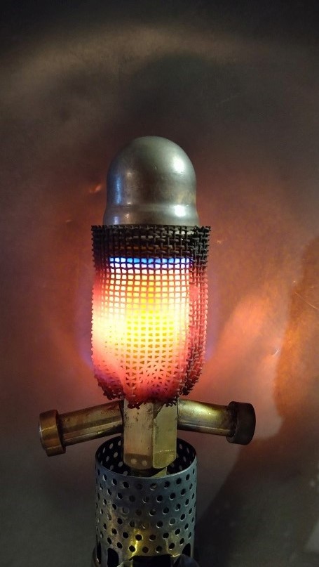

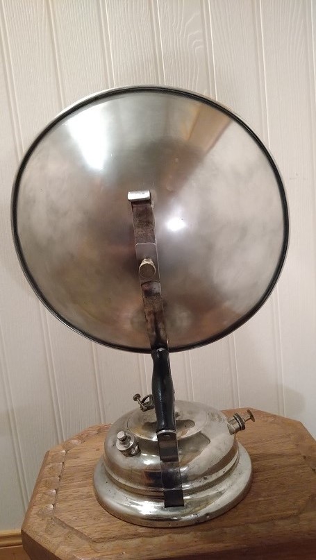

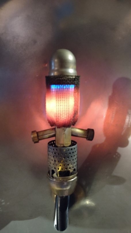

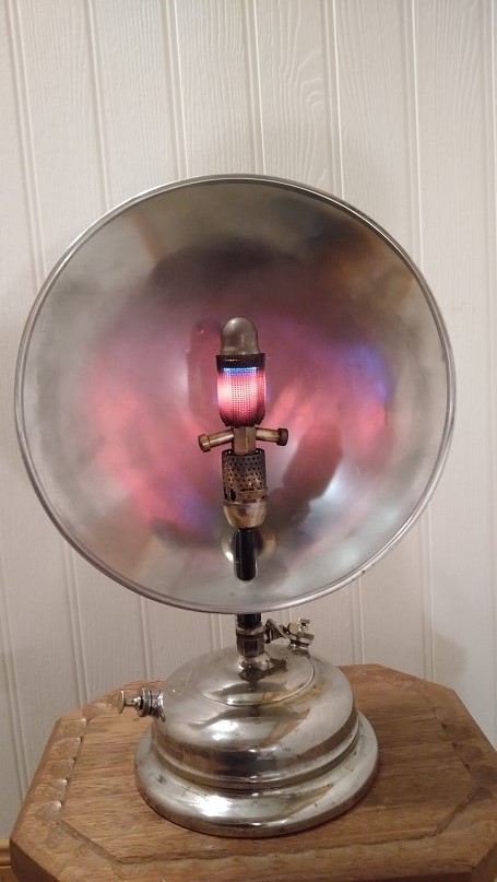

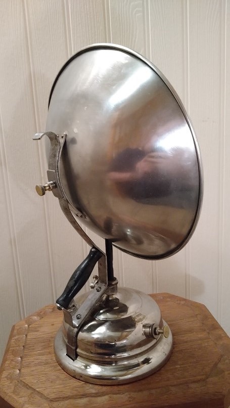

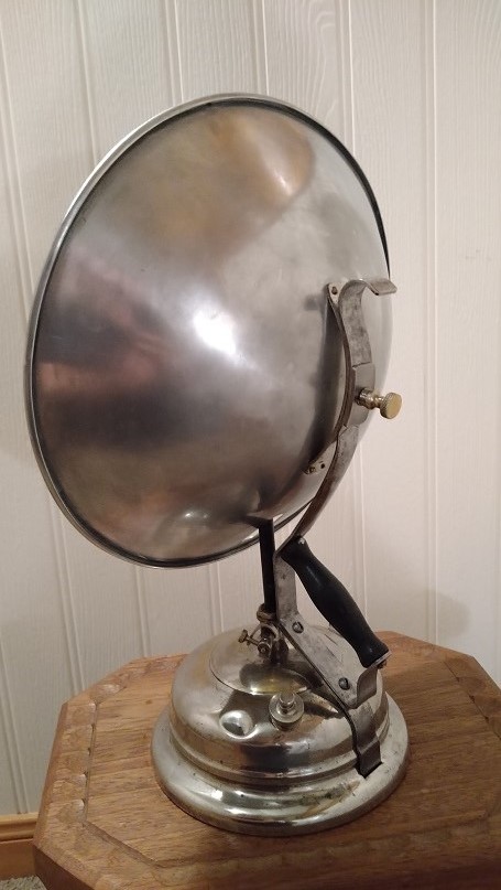

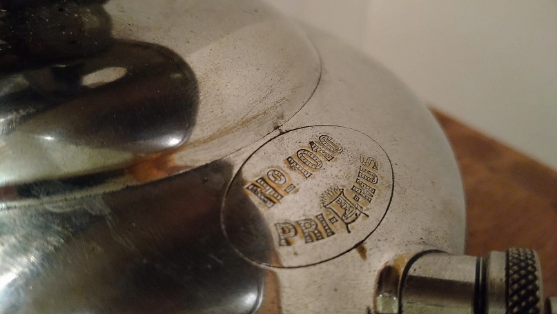

    A 1928 S29 Primus 1010 Heater with an Alcohol/Spirit Conversion
    Aluminium reflector, making it a 1010/2 model.
    Running nicely! :D

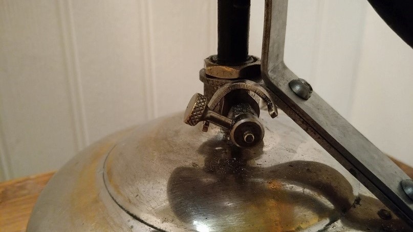

    Early lever detail
    Nice not to have a mantle to burn-in! :twisted:

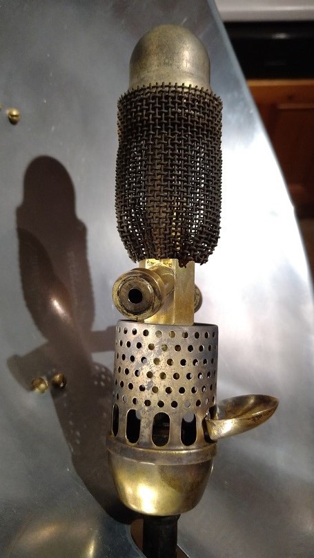

    Pricker rod has the brass gauze present, alcohol jet and the ends of the intake tubes have brass restrictor buttons fitted :thumbup:
    Like most alcohol fuelled beasties, this one has a lot of induction hiss :)
    Missing its wire guard but I can forgive it that :lol:
    Alec.

    @Rangie Out of interest, what size is the hole in the air inlet restrictor?
  10. Rangie
    Dec 8, 2012
    583
    @Nils Stephenson

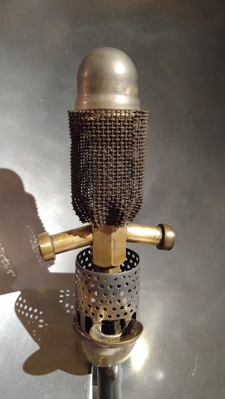

    Here you go, a couple of closer photos.
    The hole in each intake tube measures 4.0mm with the steel rule and Mk1 Eyeball, the vernier says the same give or take a 0.1mm :lol:
    Alec.

  12. podbros
    4,031
    Hi @Rangie .. that is a nice heater :thumbup:
    I like the little lever too !
    Do you know why some of the burners have straight tubes and others have curved tubes?
    Sometimes the curved tubes are longer?
    Many thanks
    pb
  13. Nils Stephenson
    3,385
    The straight tubes were used on the first heaters from 1927 and 1928. From 1929 on they had the curved tubes.
  14. podbros
    4,031
    Thanks Nils :thumbup:
    edit : I must try and get mine to function but it’s missing one of the tubes and the tube is curved.. they don’t look easy to make but I should just have a go
    probably one of those parts that is hard to find like a lot of things :roll:
  15. Francisc Masec Netherlands
    Jul 16, 2019
    194
    Sweden
    I don't think that they are so hard to make. You need to gind the right pipe, make the threads, screw on, heat and bend. To minimise the risk that the pipe will collapse during bending, you can fill it with fine dry sand.
