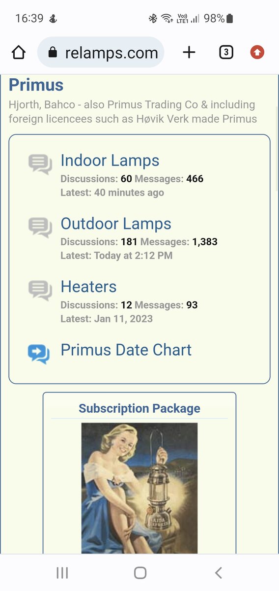

    Regarding the date chart issue... it looks like it's only related to mobiles, and possibly other mobile units.
    It works as it should whenI open the link on a computer, but on my phone it look like below. The chart should show directly under the text "Primus date chart".
    EDIT: I just relalised that if I tilt my phone to landscape mode, the chart suddenly will show up!
