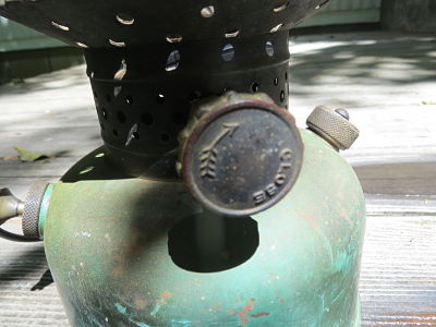

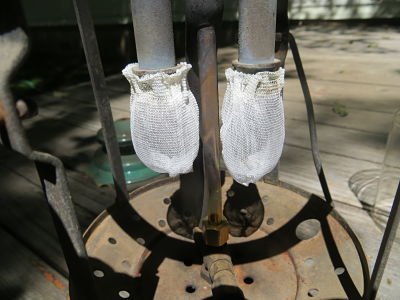

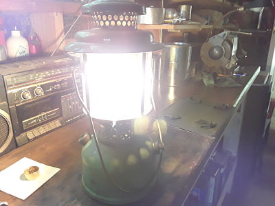

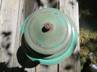

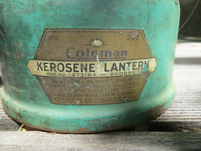

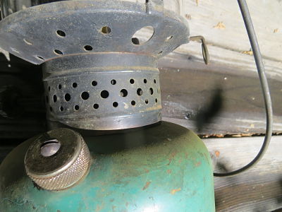

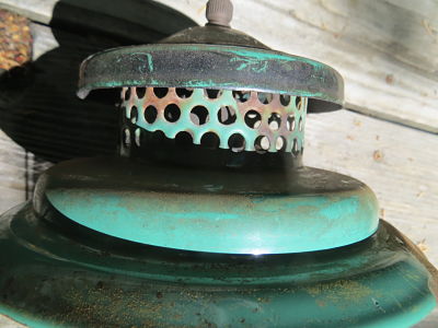

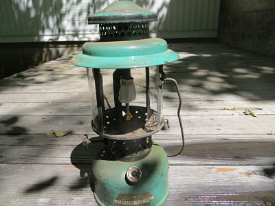

    Just got this, minor fettling to get going. Fount inside was very nice, no loose material. Fuel cap was stuck as was the collar thing holding the pump in. New cap washer, off to the races. Ran on petrol first as I wasn't sure what the generator was set up to burn. After it was running, did the 235 substitute genny build, 220E body, 201 spring, 200A pricker rod and genny tip to try kero. Ran bright and perfect. Need to buy a smaller priming cup and find something to keep it in place so it doesn't slide when dumping fuel out. One of two pricey lanterns I have now. Will post a flame shot as it is on my other tablet.

    A metal cable clip shoved onto the air tube will hold the meths cup in place or piece of twisted wire will also do the job, but a metal cable clip is neater.

    Thanks Jeff, Tony. Good to see you here. Been wanting this model for quite some time, they just go for so much money. Between my three week trip out of state, a canvas top for my pickup and this, spent most of a months income. Did sell one of my motorcycles, so the money is there.

    Thank you Pete, runs very well. Need to find a clip to keep a meths cup from sliding down the genny when dumping fuel.

    Its a 235 so it's a kero lantern and the burner intake air tube will be restricted for kero. It will run on CF but probably better on the fuel it was designed for. It should have a T44K generator or the later equivalent 206A-5891. The gas tip is marked V and is 0.008" dia. These are not at all common so you have a prize. ::Neil::

    From my research, a .006 tip is best, had the "V" on the genny that came with it and ran great on Coleman Fuel. My understanding that size would be too big for kero, went with experts ahead of me. Yes, what I figured before was the pickup is a straight pickup, like slants, QL lanterns and lamps. Easy start up, used a torch to preheat the genny when I switched to kero. T44K gennys are not available, had read they did not work perfect. Experts stated to go with the setup I used as posted in a earlier post.

    Nothing wrong with T44K generators. I have several here on working lamps and they perform well. I've been doing this for 50 years and I can tell you the best way to use a lamp is always the way the manufacturer intended when he sold it. You don't need to try to improve things just treat it right and it will perform for you. ::Neil::
