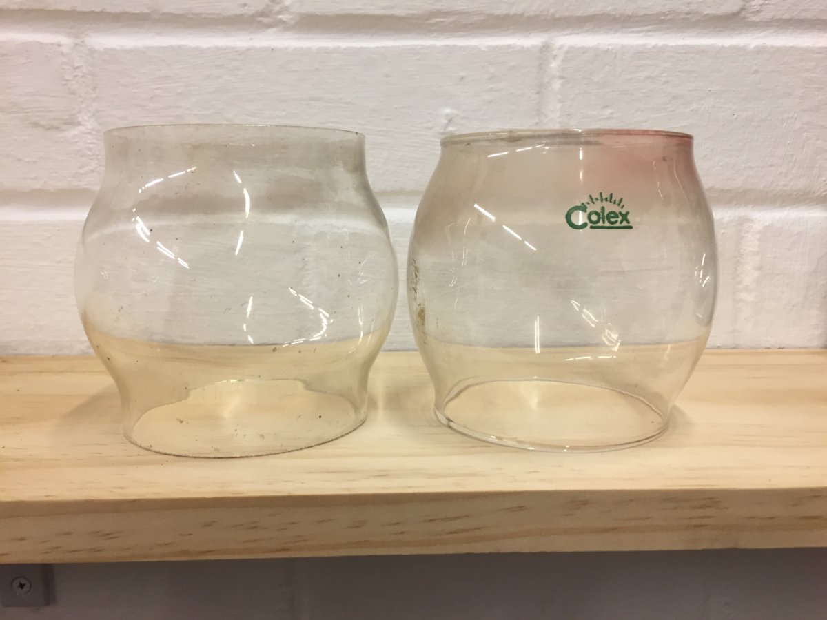

    Second, the glass is a different shape to what I’d normally see. Assuming it’s just a replacement (glass it came with pictured left)

    Does the globe have any markings?

    Maybe the glass is an early Austramax one. The shape seems to be similar.

    I’ve given the globe a clean and inspected it closely - no markings to be found. It doesn’t strike me as being of poor quality, it’s pretty thick and definitely worn on the edges through age (in my opinion).

    The Colex globe you show is sweet! I've seen Colex globes in the #4 size, but never a #550 size. There are a bunch of collectors who would like to own that one...me included!
