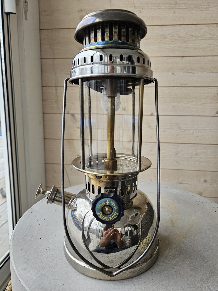

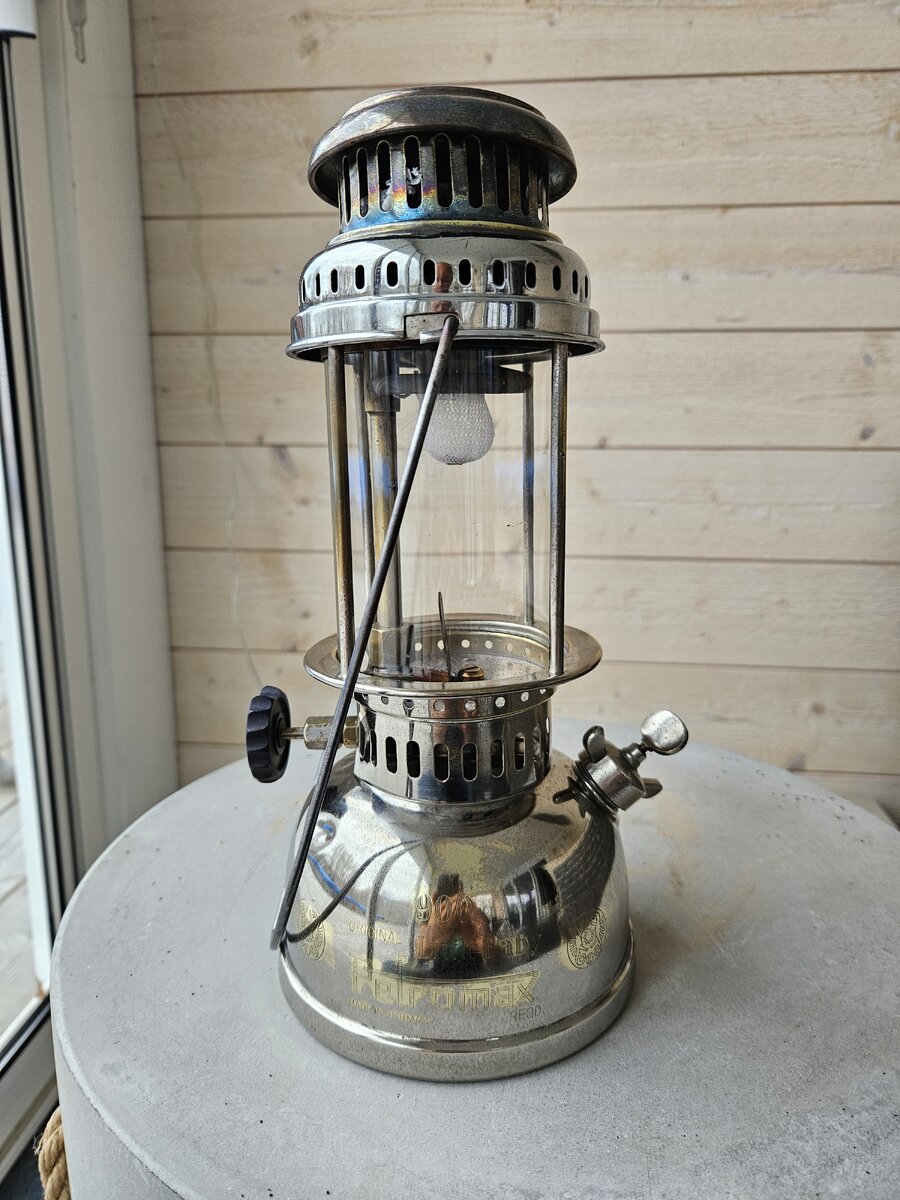

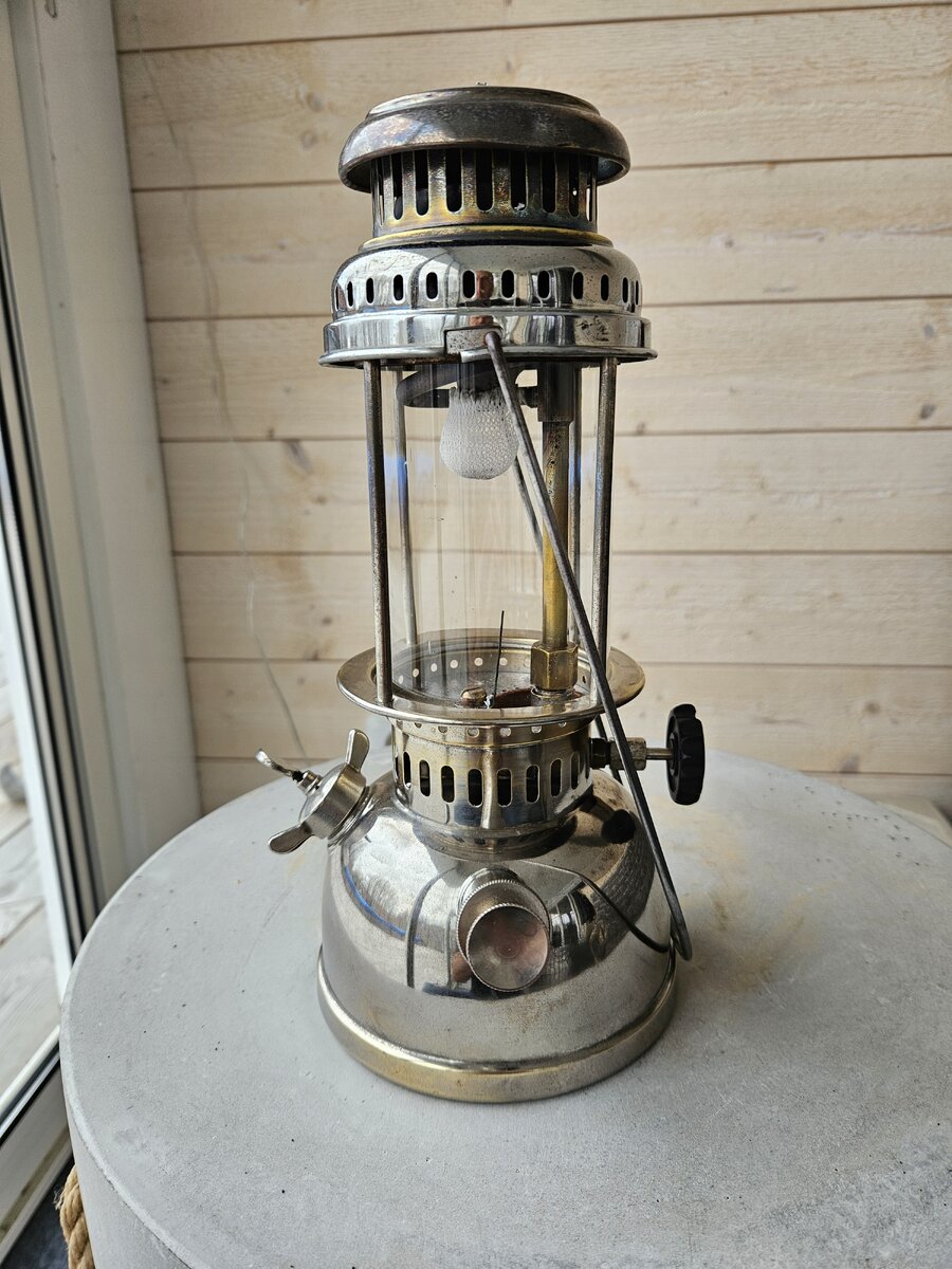

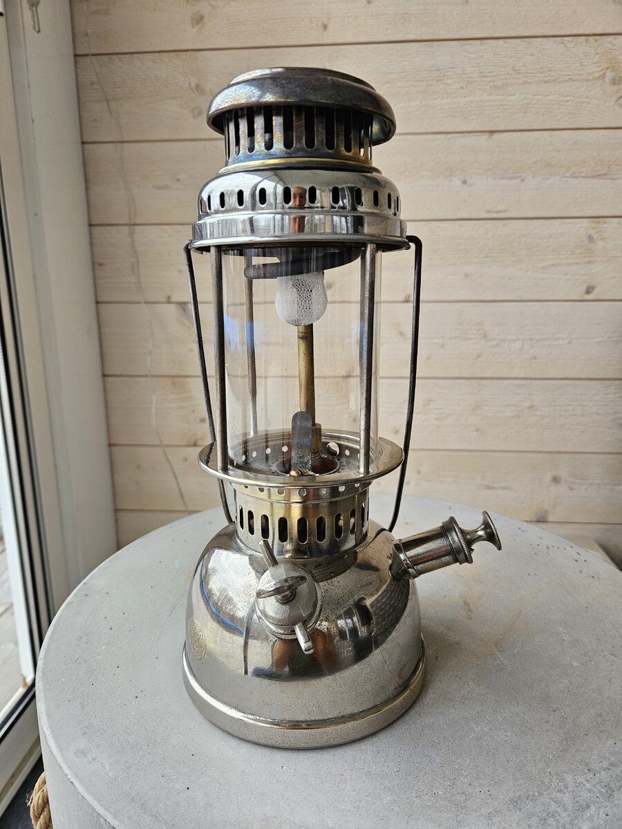

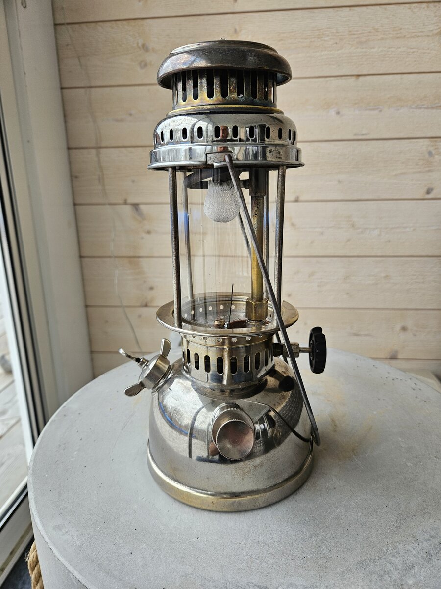

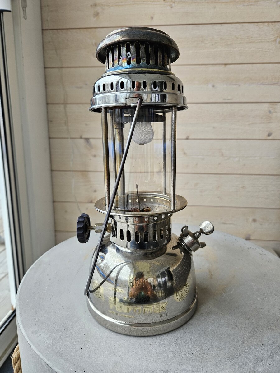

    Here we have one 900 made in June 1938.
    This one runs real nice.
    20241104_130439.jpg 20241104_130453.jpg 20241104_130501.jpg 20241104_130513.jpg

    Very nice, congratulations :thumbup:
    16,652
    It's in fine condition.:thumbup:

    This is a beautiful and cute lantern.
    The raised board in the center is something you often see on old lanterns.
    What purpose does it serve?
    Is it to guide the alcohol flame into the mantle? ?
  6. Tive
    Tive Sweden Subscriber
    455
    Sweden
    Hello ! yes i believe its' there to somewhat direct the flame towards the vaporizer, and at the same time it holds the alcohol cup in place.

    Did you make that blue colour on the control wheel?

    No these wheels are blue, in fact, both the wheel itself, and the insert are blue originally, the main wheel is a very dark violet tone, and the insert is light blue, but the wheel becomes brown when it ages, and the blue insert turns green. What i do is that i clean the insert and wet sand it down to the blue color, and the wheel itself i clean and scrape of the brownish hue with a model knife and wet sand where possible.

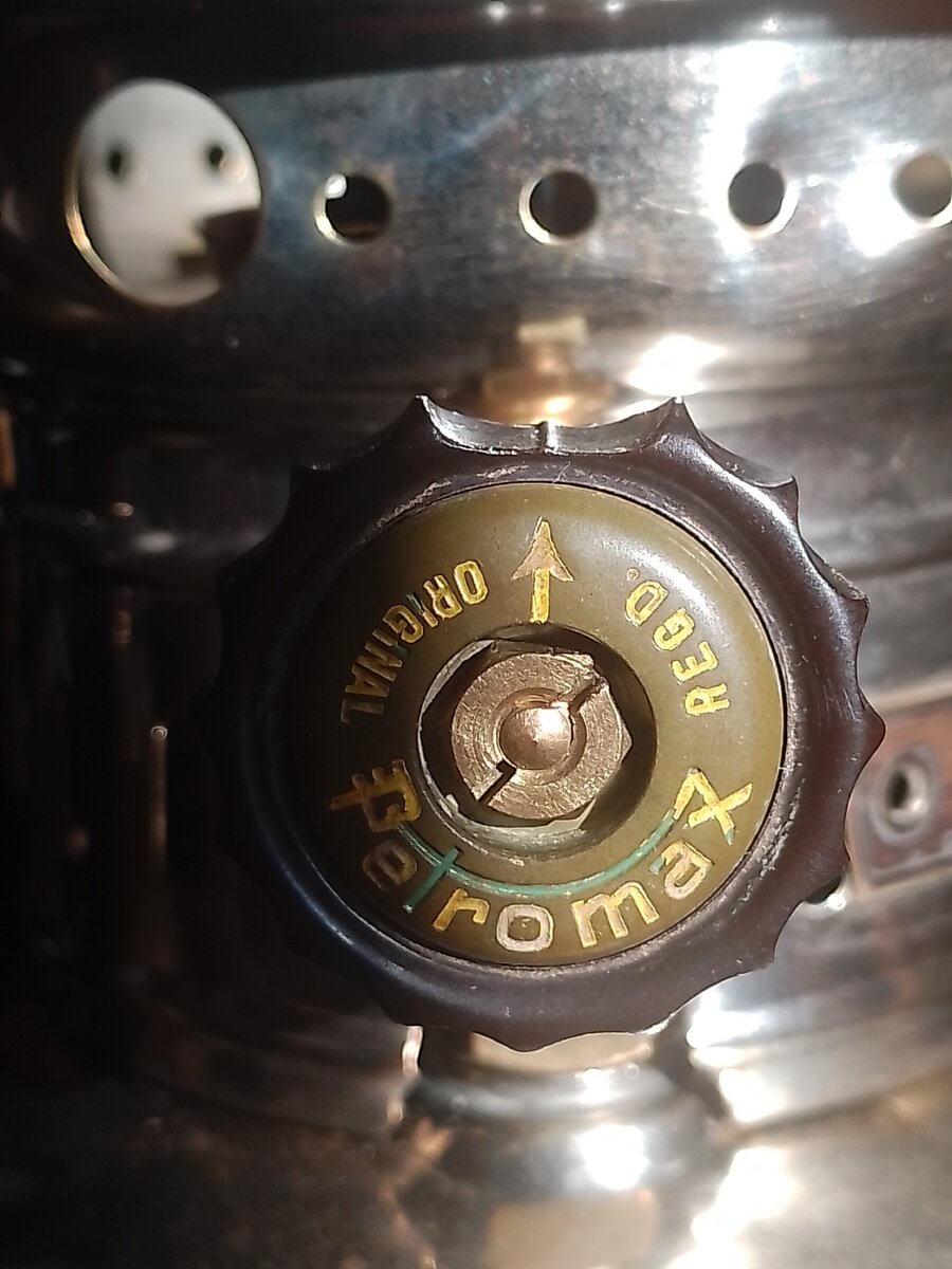

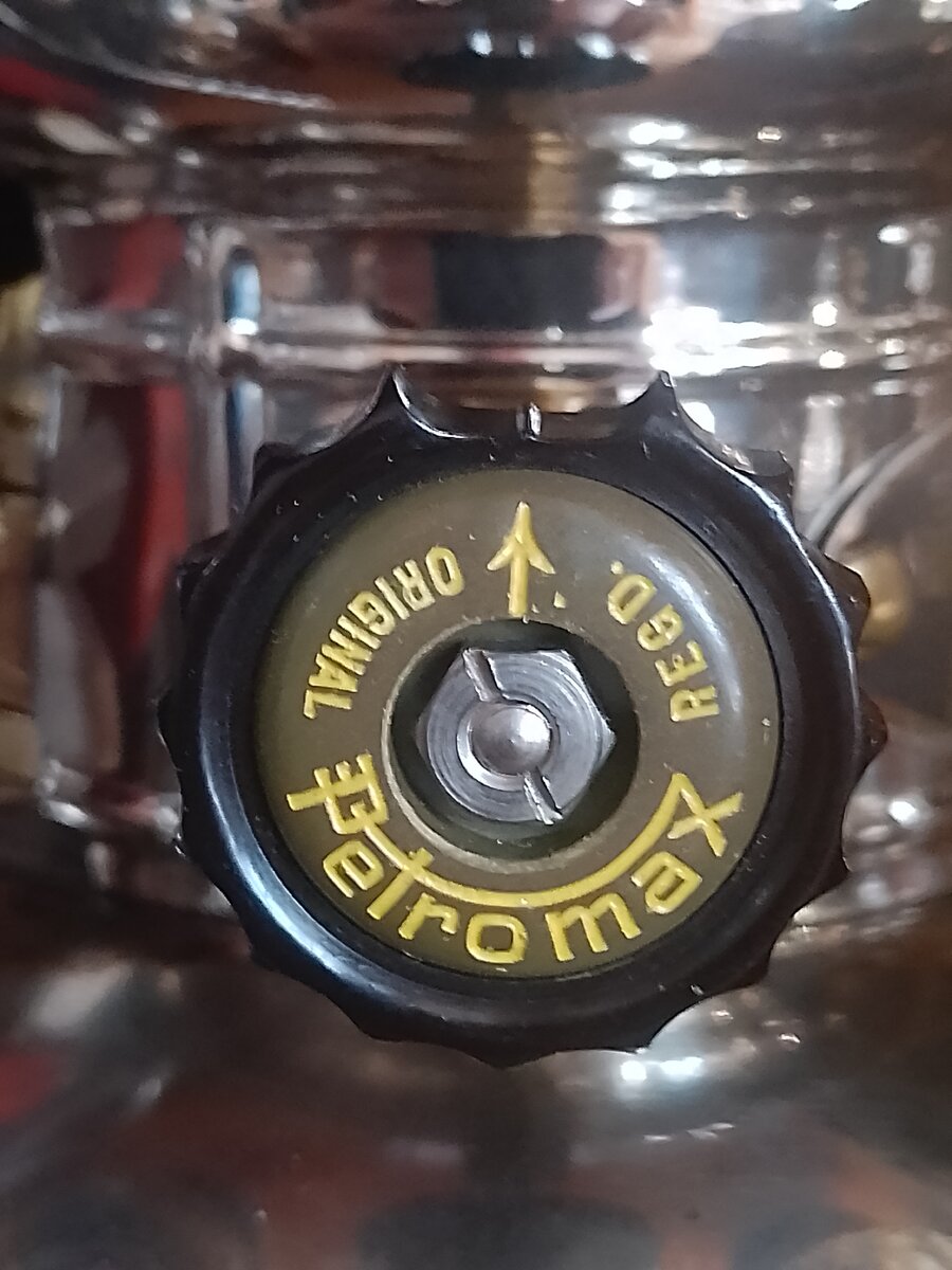

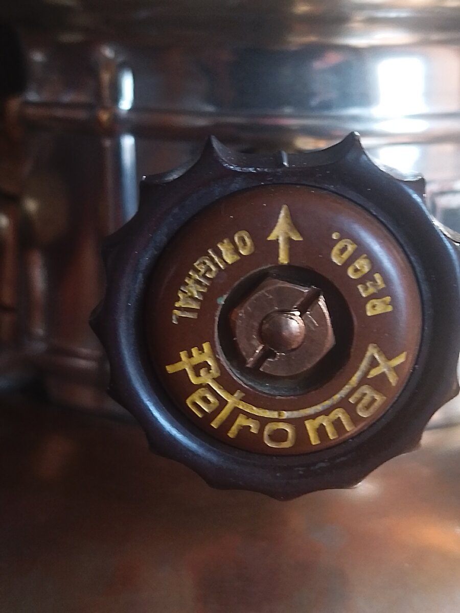

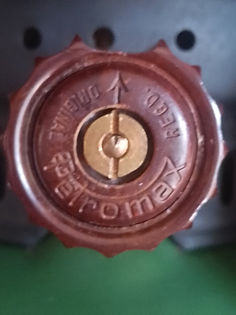

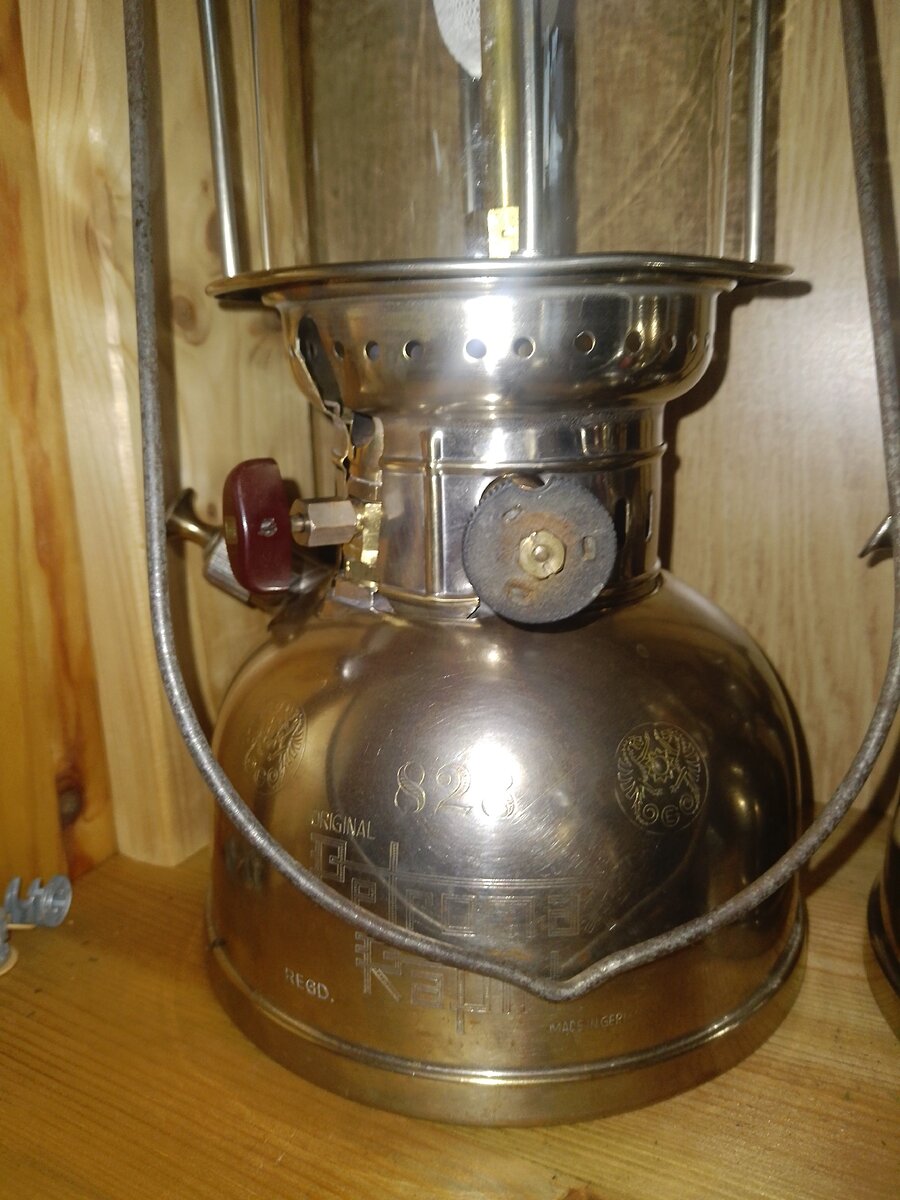

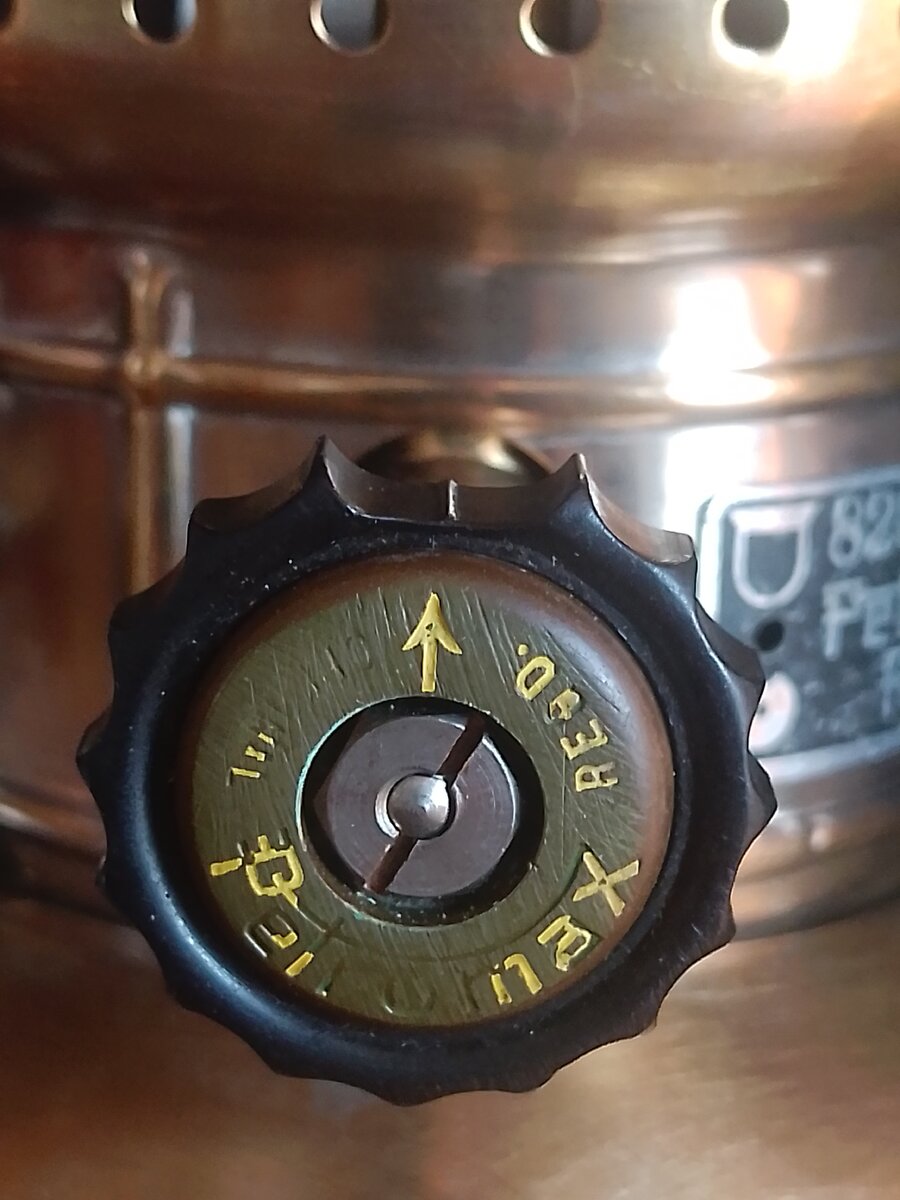

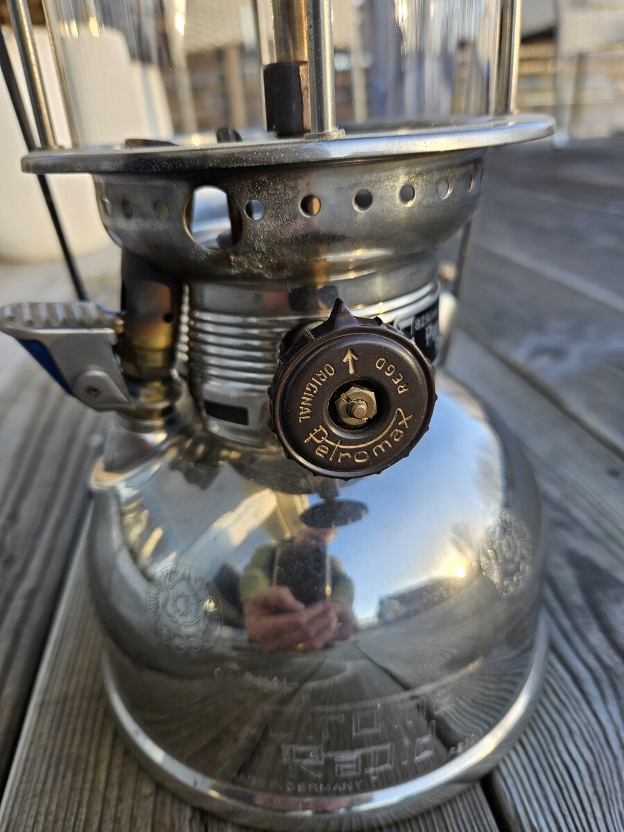

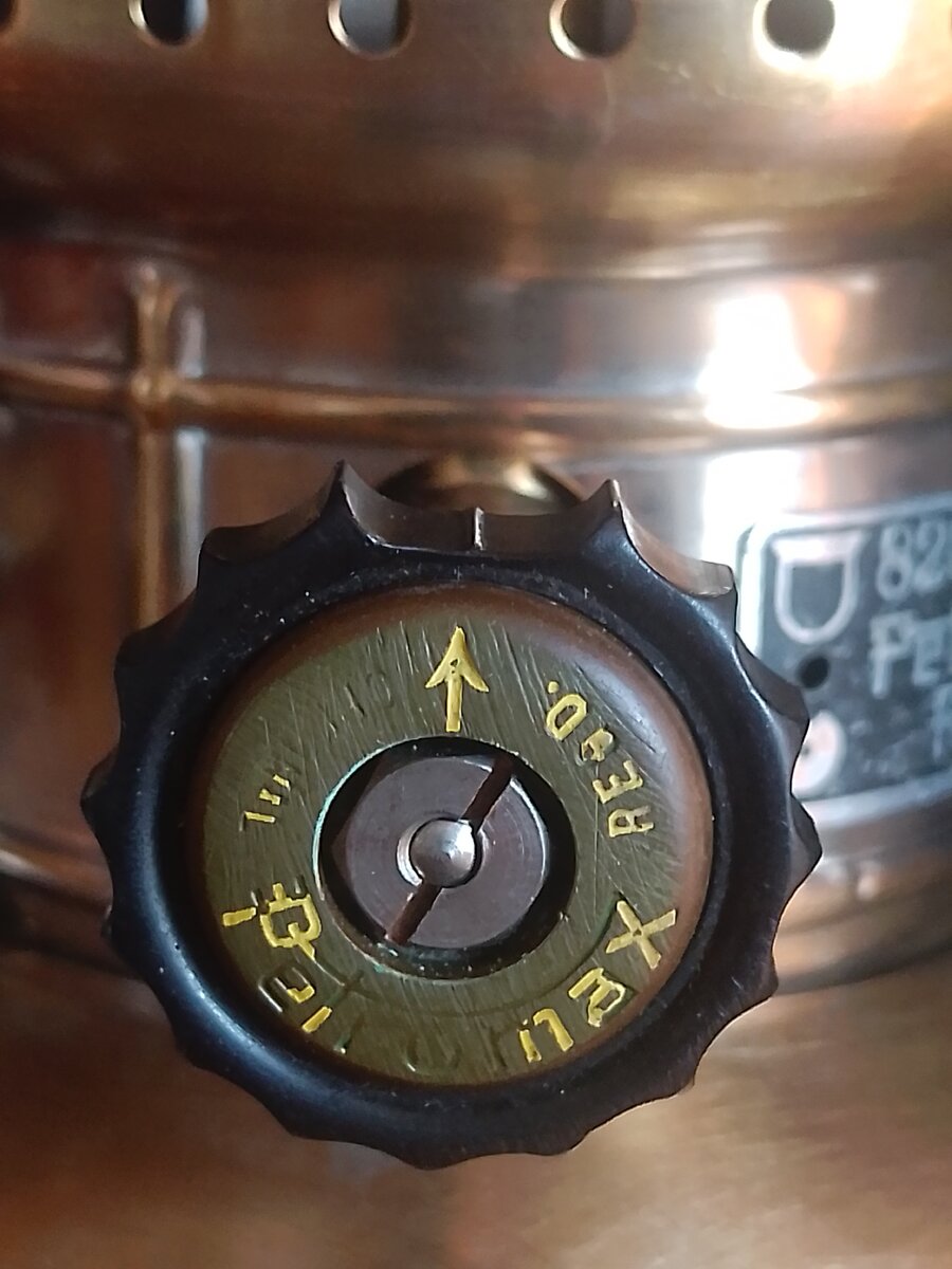

    I have never seen a pre-war Petromax with a blue wheel in Germany.
    Perhaps an export version for Sweden ?
    On my lamps they look like this.The completely reddish brown version can only be found on some 2827s.
    IMG_20241123_110631.jpg IMG_20241123_110835.jpg IMG_20241123_110719.jpg IMG_20241123_110647.jpg IMG_20241123_110621.jpg

    All my Pre-war Petromaxes with this style are blue underneath the green surface, easy to check with a knife or similar on the backside, some are more blue than others, and the all were dark green when i found them, and none of the lanterns were found in Sweden. sometimes you will be able to sand them down into the blue finish, sometimes not ( if you want the lettering to show) it depends on how deep the color change has gone.

    But if you look at it closely, there are chips in the paint on your wheels, and you can see the blue.
    Now I am tempted, should I sand down my only prewar-lamp-knob...
    That blue is mesmerizing.

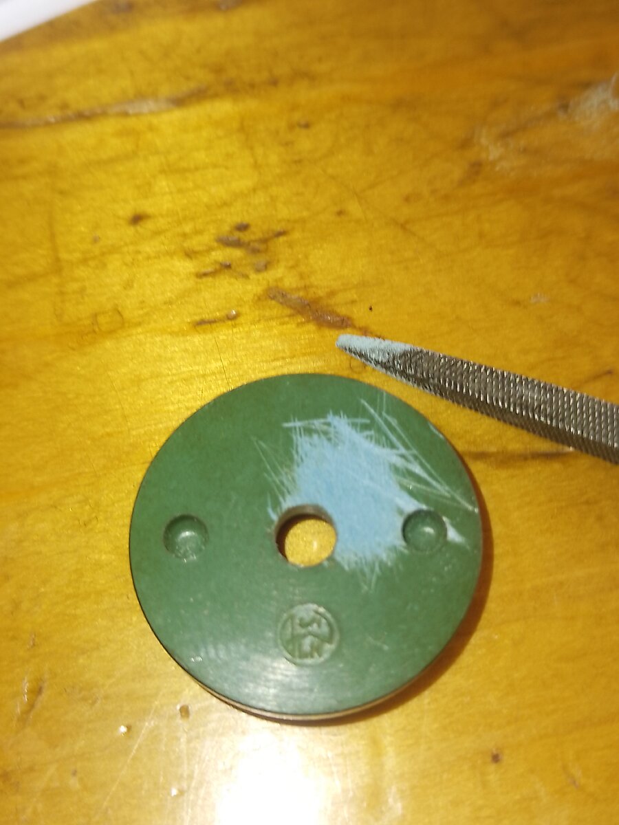

    The advertising brochure in post 17 is well preserved and for me an indication that the wheels in 1939 looked exactly like most of the ones in my collection.
    I was filing on the back of one wheel and came to the conclusion that the color of the material is blue but that they had a green lacquer coating.
    The predecessors and successors of the two-part wheels were the Pertinax wheels.I don't know the wheel from post 14,never seen it.
