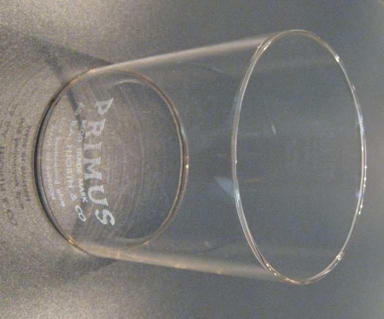

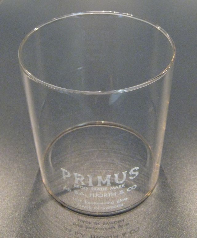

  4. Lightbringer
    Sep 8, 2013
    24
    The original glass can be difficult to find but a none branded replacement glass should not be too difficult. The size is 89 mm in diameter and 106 mm high, same size as the more common Optimus 200 and 1200. Same for the pump leather as I guess you mean. Same as Optimus but almost any 18 mm will fit. Unfortunately I can't help you with retailers outside Sweden so I guess you have to continue to Google around.
    16,675
    Hello Dom, that old Primus lantern on Ebay may be useful for parts and the build quality is good, so they will usually restore.
    Check out the link below to see how well they restore and that is a 200 cp., lantern, so that is the size of mantle to fit, Jeff.

  7. Carlsson
    3,963
    In Sweden you generally think about Fogas when searching for parts to pressure lamps.
    They will probably have the right glass, and other stuff, and will ship abroad.
    Just pop a question in a mail to them.
    It's Conny you want, so the e-mail is:
    conny "at" fogas.se
    There's also a German shop I like myself that got most parts you need, and they pack well.
    The glass is to be found here.
    They should have pump leathers too.
    But I think Base-Camp might have a suitable glass too. And pump leathers.
    Just give them a mail.

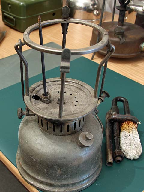

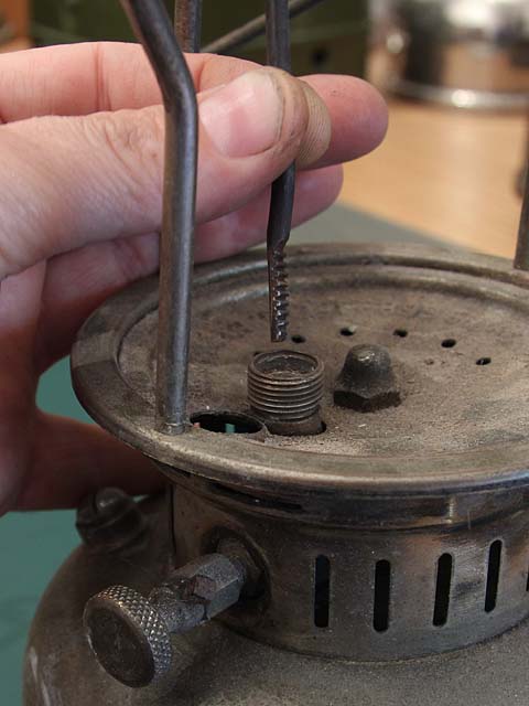

  16. Carlsson
    3,963
    Yes, you got it right.
    The thin point at the very top goes through the hole of the jet to clean it out every time you make a full turn clockwise and then back again on the wheel when operating the lantern.
    In top position-that's when the wheel is to full stop in the clockwise position-you should feel the needle protruding through the jet, but just barely.
    The actual cleaning needle is only the tiny part at the top. It is screwed into the top of the long cleaning needle rod, which ends with a rack at the lower part.
    Some images to show better. The last one show how I just lifted the rod out of the lantern and the grips of the pinion (the inner end of the shaft of the control spindle).
    The needle of yours might look slightly different. Some cleaning needles has a four sided head in brass that holds the tiny needle (shown here. Not for a 991, mind you, but they look similar).
