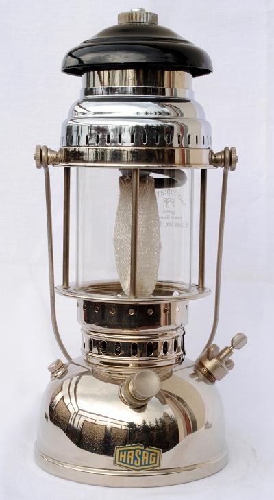

1939 Hasag 42, marked EFAR 608
Discussion in 'HASAG' started by pitu, Mar 18, 2011.
  1. pitu
    Mar 12, 2011
    66
    Hasag 42 lantern, marked as EFAR 608, made for export to Indonesia. Glass marked "Fa. Joseph Rute, Soerabaya". Lantern is in unused condition.
  2. Mackburner
    I think the globe may well be a lot older than the lamp then. Joseph Rute was a hardware business owned by two Dutch brothers Dirk and Gerrit Janssen. In about 1930 they moved back to Holland and then opened a shoe factory and a Lamp store which sold Summit brand lanterns. I don't know if they sold Firma Joseph Rute or if they just closed up and moved. Could be the business lived on and was still selling lamps in Soerabaya in the 1930s but no lamps from that period have been seen so I suspect they did not and that would make the globe an early 1930s product. ::Neil::

  4. pitu
    Mar 12, 2011
    66
    Neil: Thanks for the info. As I know, the globe comes originally from this lantern. Although it's still possible that it was some kind of old stock, that was used after the war broke out.
    Karli: This was my first lantern. It was bought by my grandfather in the early war years, probably 1940, but was never used. It was found on the attic in the early 1990's in original box with spare parts, accessories and papers. Unfortunately box disappeared during the years, but equipment remained.
  5. Mackburner
    Sounds like the globe may have been an original then. Trouble with glass is you never really know if it is though. Has to be old glass but then you have to wonder how that globe got onto a Hasag because Joseph Rute sold Nulite lamps from the US and as far as we know never sold any German lamps. Summit did but not Hasag. They sold Nulite or Standard Licht. Seems odd but then a War time purchase may well have had old stock glass fitted from new. We will never know but it is an interesting piece of glass and perhaps of more interest historically than the lantern. ::Neil::

  7. Tony Press
    I have just seen a photo of a Swiss Standard lamp with “Joseph Rute, Soerabaya” markings.
  8. Jörg Wekenmann
    Jul 11, 2021
    256
    Hi Tony,
    Neil's statement is already 13 years old!
    There is more recent information available.
    Standard and Rute go together, as Rute also sold these lamps.
    But the Hasag 42 with EFAR 608 tank stamping is more interesting! EFAR is one of Franz Racek's trademarks in India. He had Petromax and Hasag lamps manufactured in Germany with his embossing. But he had nothing to do with Joseph Rute.
    I have put a few adverts from Joseph Rute in the library.
    Greetings
    Jörg
  9. Tony Press
    Thanks, Jörg.
    I knew it was old, I was just following through on the conversation.
    I sent Neil the photos of a Rute-Standard donut lamp found in Australia. It's probably here through the Dutch diaspora from Indonesia.
