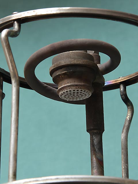

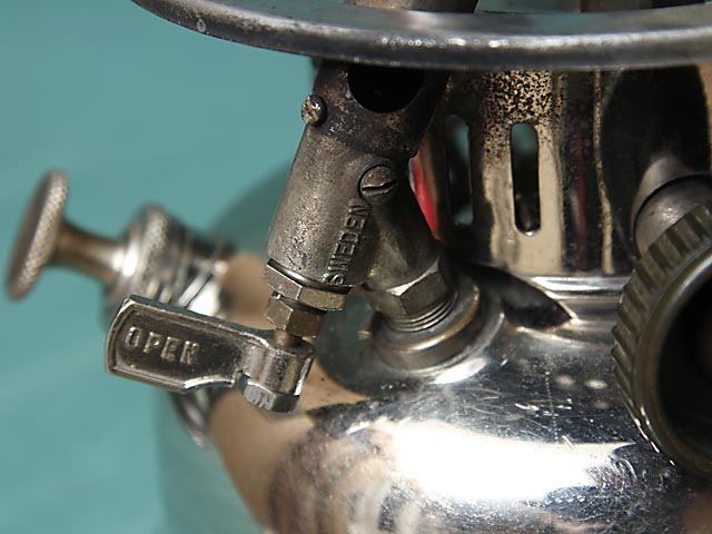

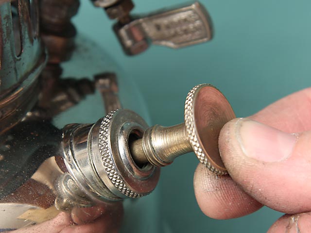

    Paraffin lantern with quick starter of Primus own patent.
    This quick starter use the earlier handle in metal.
    It's a bit shabby, and some previous owner has obviously dropped something on it because it was very deformed. The collar was cracked by the down force, and looked just like how we are used to see Radius 119 collars. :lol:

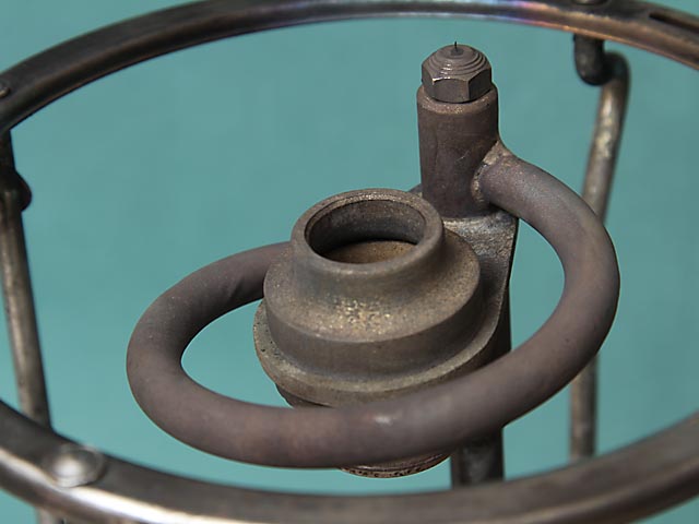

    I straightened the things as good as I could and soldered the collar, but it's still a bit skew. The vapouriser was bent so badly that the cleaning needle rod was totally stuck, but I got it in a decent shape, and the most important thing is that it work perfectly. Just as a Primus should. And the 1081 (and 981) is a bit of a favourite when it comes to actual users due to their low noise.
    Screwdown pump with the larger knob used on these:
    Easily accessed jet and needle without disturbing the burnt in mantle:

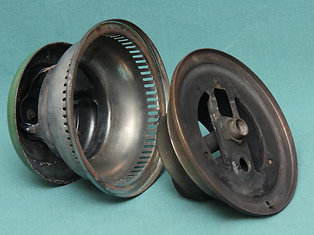

    Hood and inner part with the mixing chamber:
    First version of handle for this quick starter:

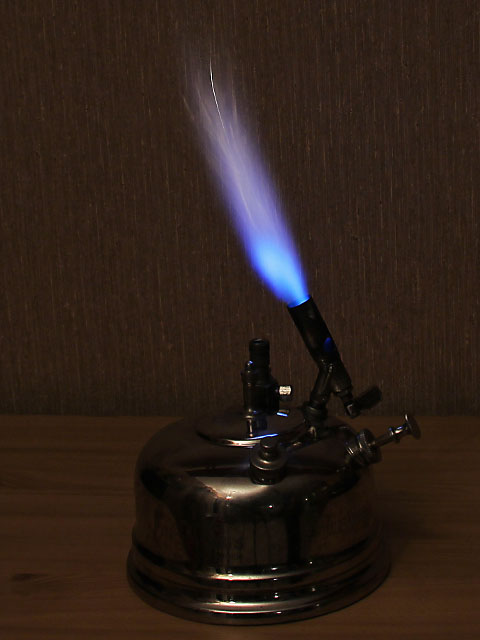

    Test of the quick starter before assembly:

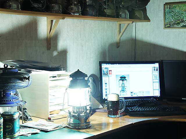

    A well deserved beer in the light of the lantern while writing all this:
    And finally a picture of the lantern before I put it in to a decent working condition again. I'm sure it would have worked here too if the cleaning needle rod wouldn't have been totally stuck (in the up position since that's where it is after turning these lanterns off).:

    This type of pumpknob makes me a bit uncomfortable though, while pumping it you are banging down the tread/coil in the collar for each stroke, but apparantly nothing happens. They use this princip also on other models ex. the 1051 as you surely know.

    Claus, I fully agree about this pump type, and I have also expressed my discomfort in pumping with this type in earlier posts.
    And that's also the reason why I use a "standard" Primus pump when I actually use the lantern, as the observant might have noticed from the pics above.
    I see no reason to have a lockable pump. If it is rising from the tube you got an NRV problem and should deal with it.
