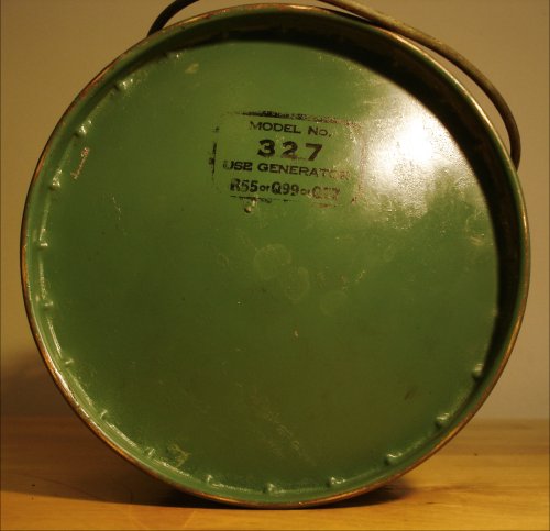

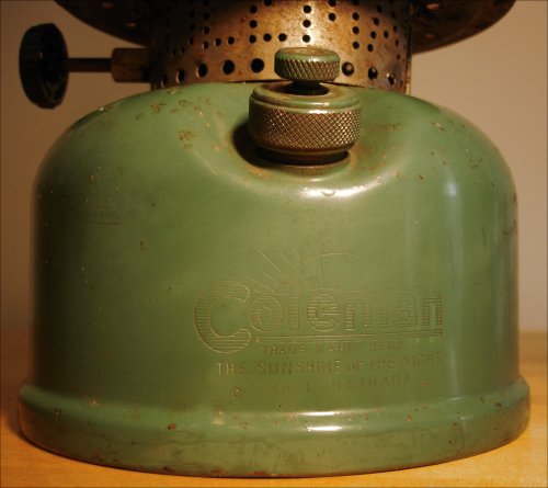

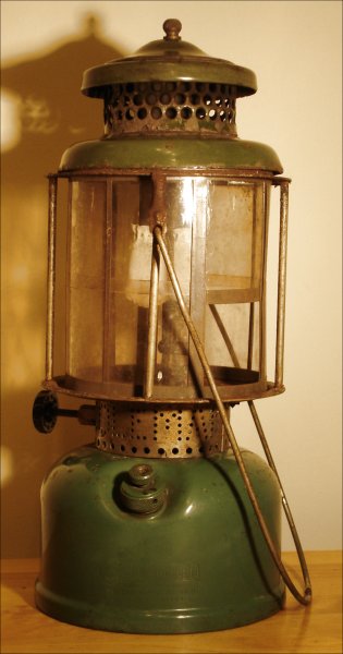

    I bought this as it had a decent mica globe, although it is missing the lighting door. I have it running on a 75% Kero 25% CF blend.

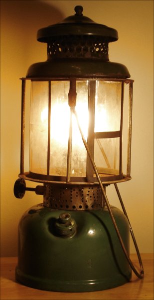

    Hello James, how would you rate the light output on that mix? Jeff.

    Wow that's a "late" date for a 327...
    Is that kosher, or could it have been
    serviced by Coleman with later parts..,
    like a fount?
    Looks like a good lantern!
  4. Mackburner
    The date will be correct. Coleman Canada made this 327, 427 and 427K at least to 1943 and possibly up to the end of WW2. I don't think I have see the 327 before but I know of maybe three 427K models in captivity dating to 1942 and 1943.

    It's pretty bright, but I think it would be brighter on straight CF.
    16,889
    Thanks James and will you be trying it on just Coleman fuel for comparison of the light output? Jeff.

    By the bent curves in the bail the ventilator is incorrect.
    Late 1930's and early 1940's model 327 Coleman Canada 'Signal' designated lanterns used a wider brim 'Mountie' style vent.
    The style of vent as on the lantern wasn't in use after about 1936.
    Interesting to see a late 327 export model, scarce in Canada.
