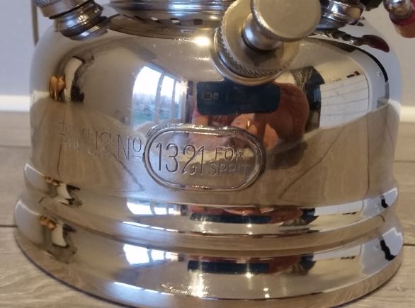

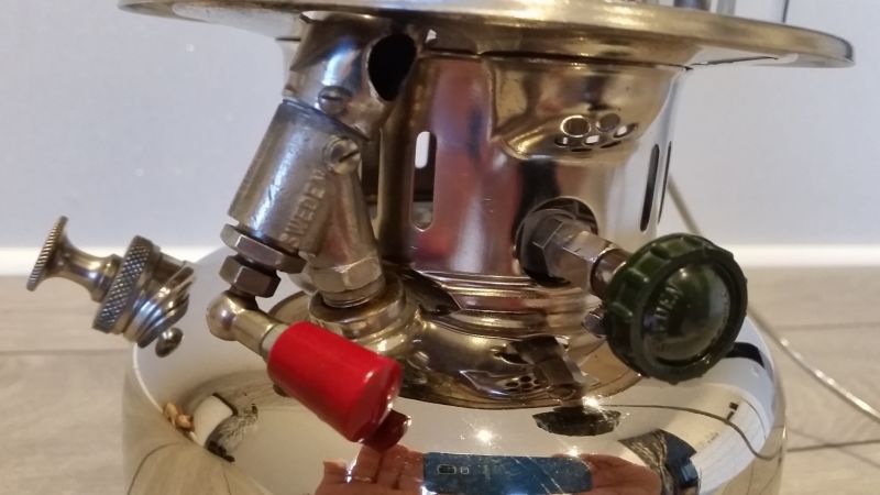

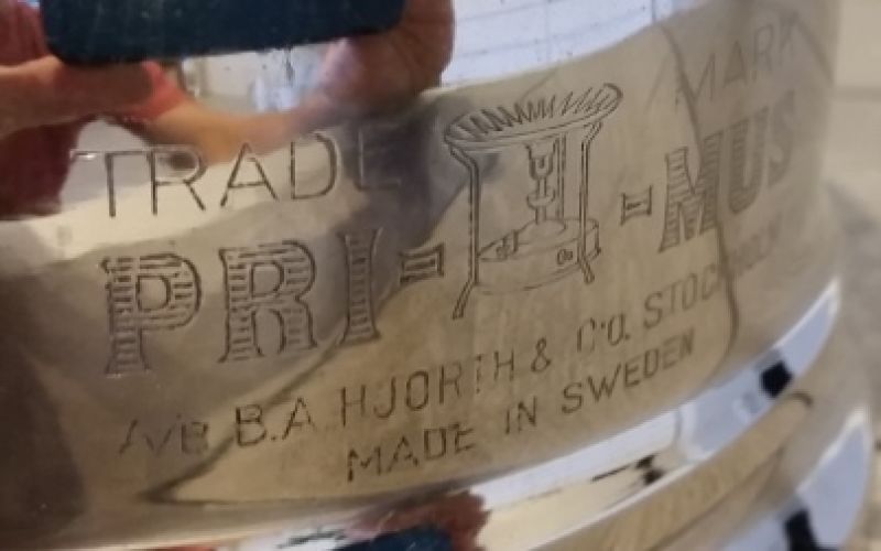

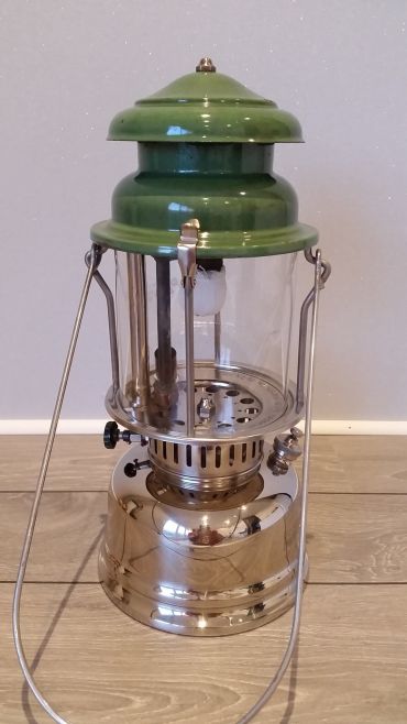

    Hello everyone !

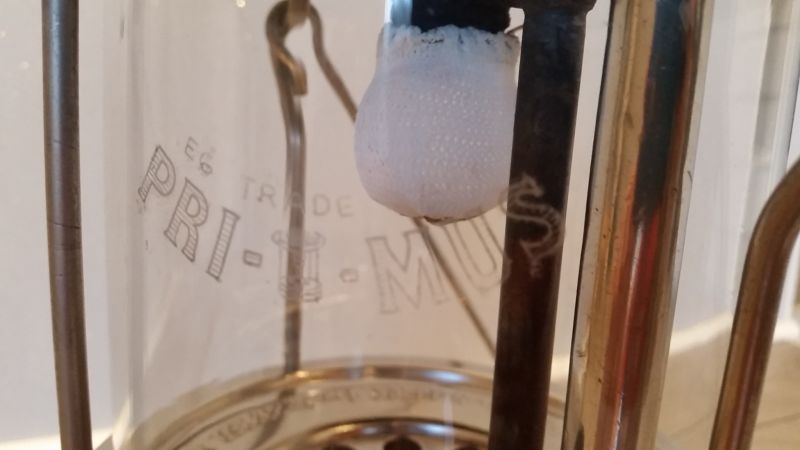

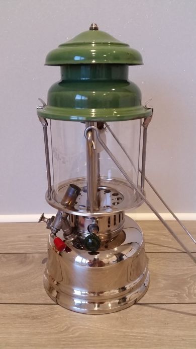

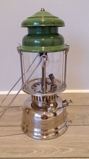

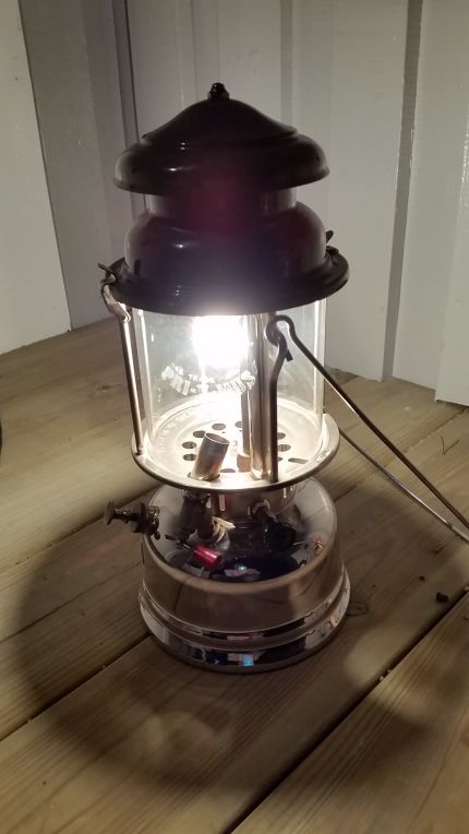

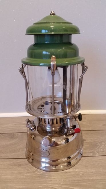

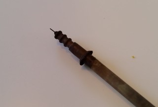

    This nice 1321, stamped AI on the bottom was manufactured in 1944, and is an alcohol fueled lantern. the burner system is basicly the same as on the 1020 kerosene model, but with a brass restriction in the air tube and a large hole alcohol jet. further more the rinse needle rod is a two part one with a mesh screen. The 1321 looks very much like an 1020 but is infact quite different, the glass stand is different and unique for both the 1321 and 1320 as they have more and bigger air holes in the bottom. and the fount used on the 1321 is actually from an 1081, as the 1020 never had a quick starter.
    1483477887-Primus_1321_1_opt.jpg 1483477902-Primus_1321_2_opt.jpg 1483477971-Primus_1321_3_opt.jpg 1483477989-Primus_1321_4_opt.jpg 1483478007-Primus_1321_5_opt.jpg 1483478032-Primus_1321_6_opt.jpg 1483478050-Primus_1321_7_opt.jpg 1483478070-Primus_1321_8_opt.jpg 1483478088-Primus_1321_9_opt.jpg 1483478104-Primus_1321_10_opt.jpg 1483478123-Primus_1321_11_opt.jpg 1483478142-Primus_1321_12_opt.jpg 1483478166-Primus_1321_running_opt.jpg
    The glass cylinder on this one is unusual in that way that is was made in France.

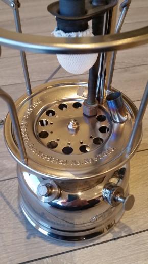

    Nice one Frederik. It's good to see it is still set up for alcohol.
    It is interesting to note the base of the globe cage. I had always assumed it used the same cage as the 1081 as it also has the large holes, but the small holes are in a different position. I wonder what difference it made?
  4. Tive
    Tive Sweden Subscriber
    455
    Sweden
    Yes you are right, the 1321 base seems to be a 1020 with extra holes, but the 1081 base is totaly different, 981 & 1081 is the only ones with holes on the outside the collar, Frederik
