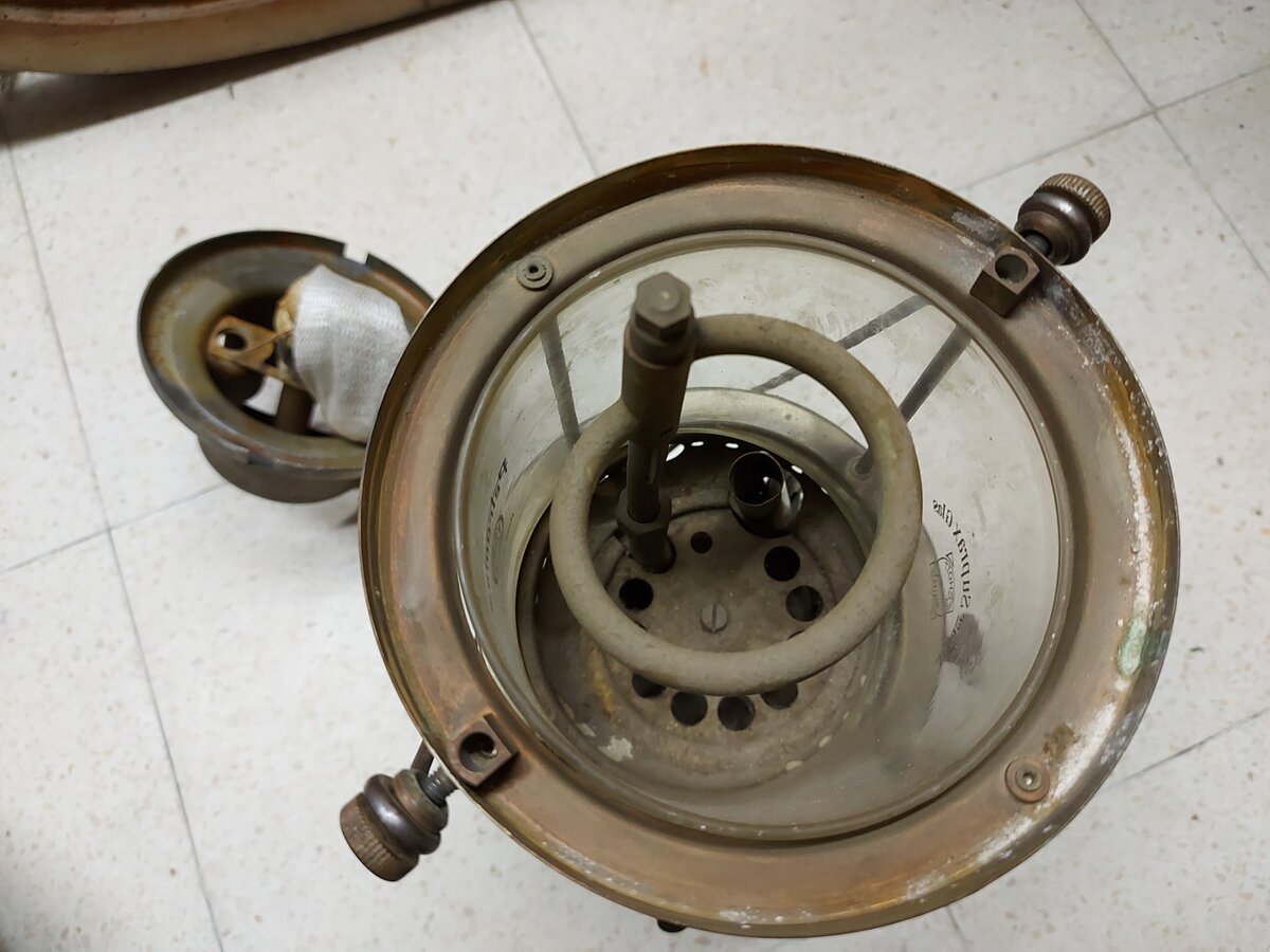

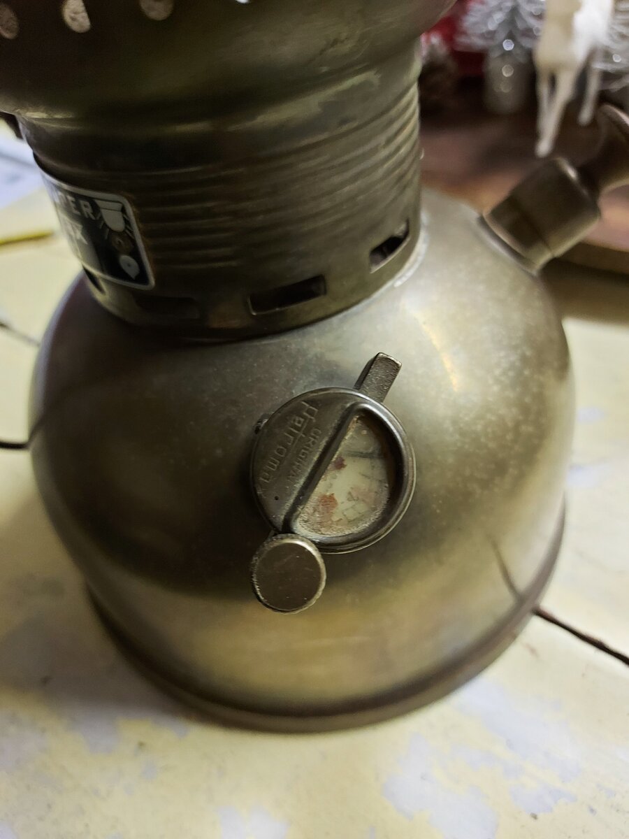

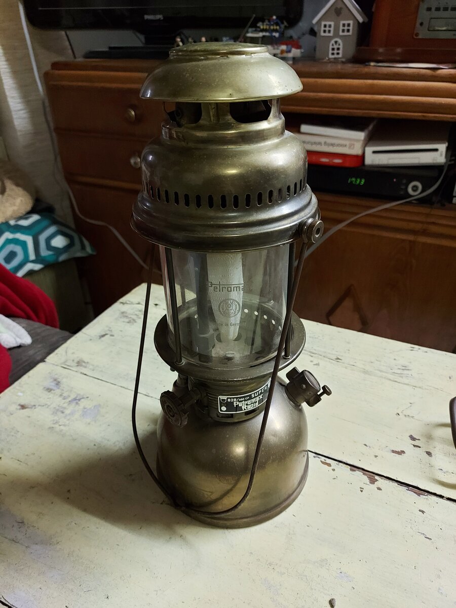

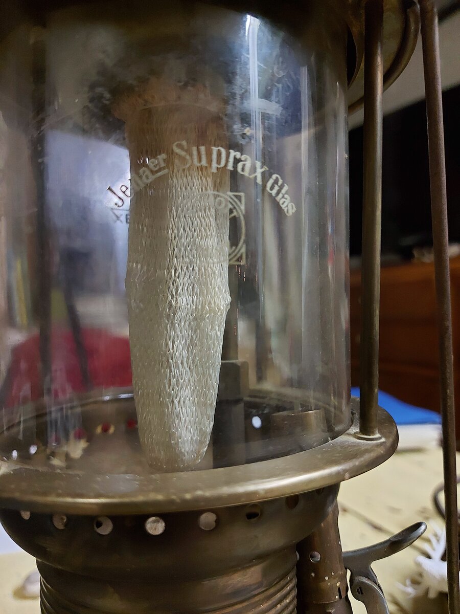

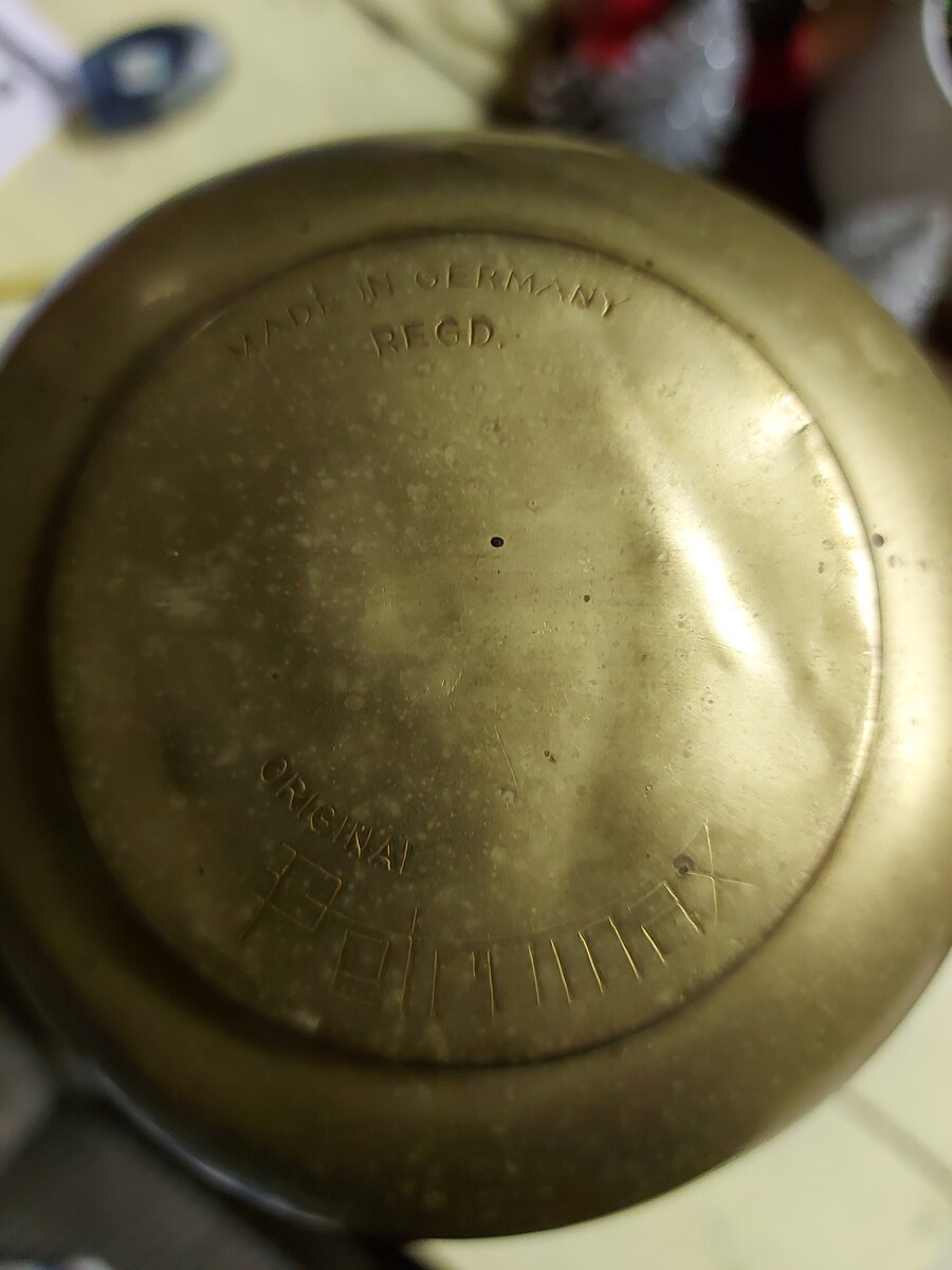

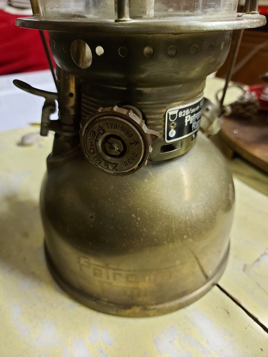

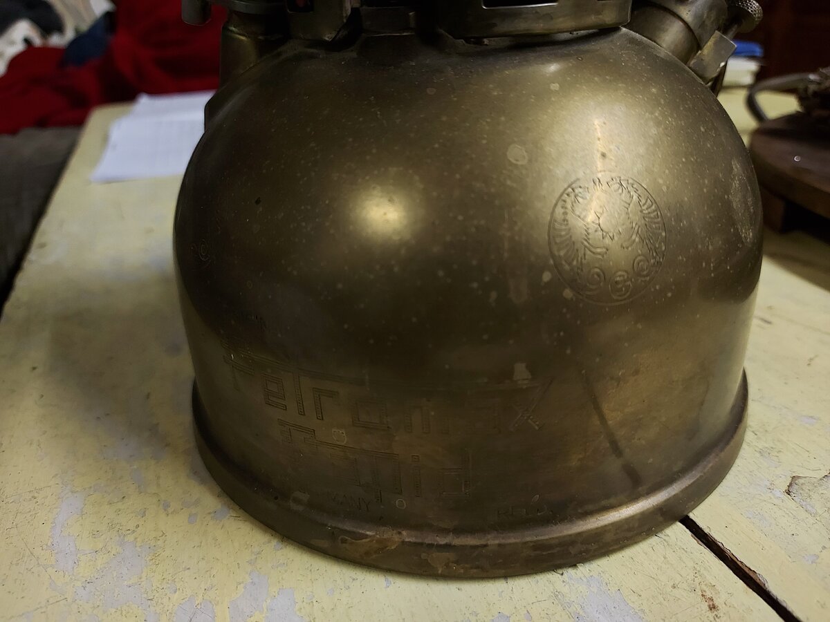

    I just bought my first Petromax, a 828/350 super which I believe is a 1953.
    Can anyone confirm this and point some things out how to identify the year?
    At the bottom it very hard to see but looks to be 4/3 scratched.
    The lamp doesn't work at the moment but want to refurbish it.

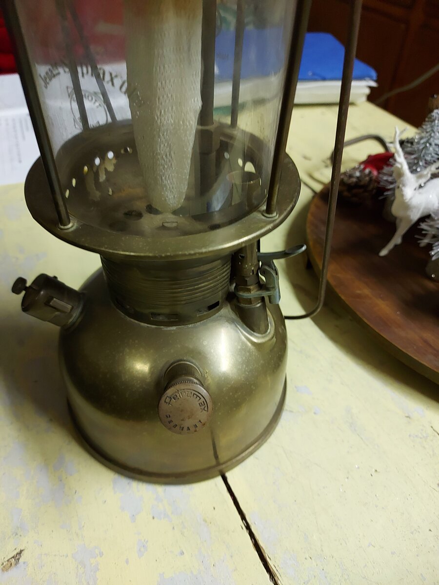

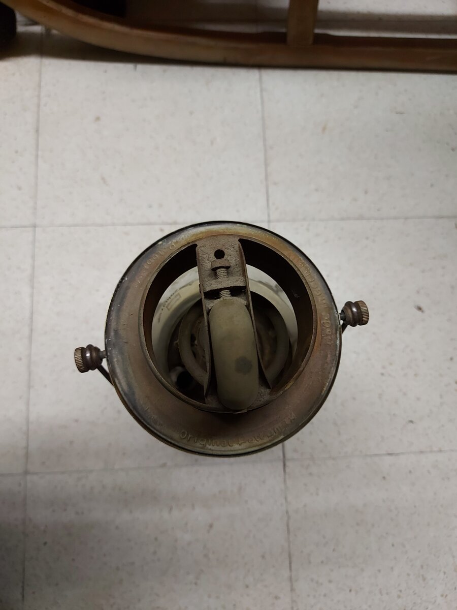

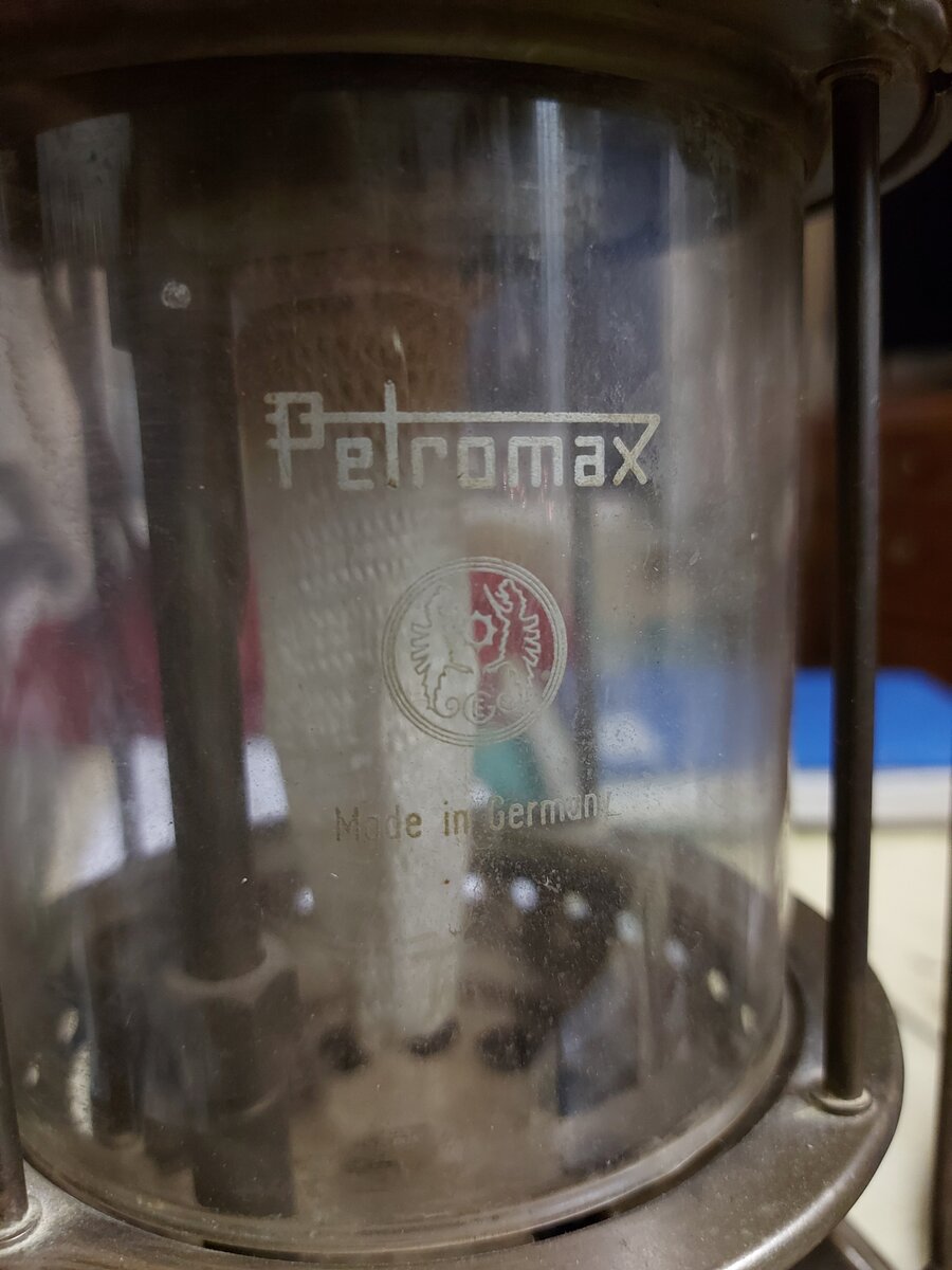

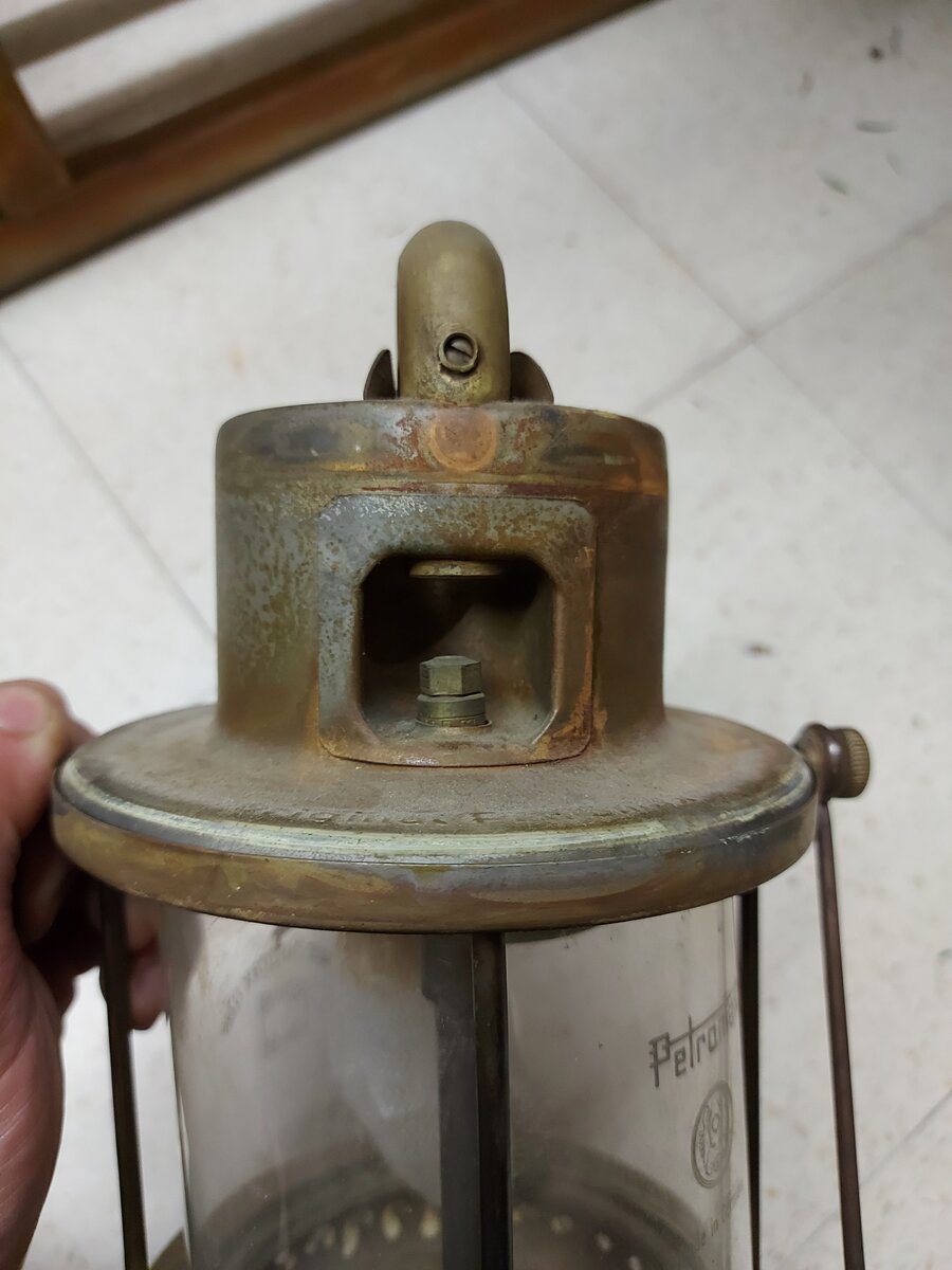

    Some more photos
    20211210_170506.jpg 20211210_174154.jpg 20211210_174207.jpg 20211210_174300.jpg

    Hello @Wälderer , and welcome here!
    To me it looks as if the design of the globe cage and the inner chimney doesn't fit the type of preheater. That kind of lever was already used before the WW-II and shortly after, until it was replaced by another design in 1954, as shown in patent DE 951204. But at this time, the holes in the base of the globe cage were still looking like upright oblongs, and not like lying rectangles (and horizontal grooves) as at yours. That type of globe cage is earliest described in patent DE 1023431 from 1956, which was truly associated with the rare types with the "Sickentank".
    Nevertheless this is a fine lantern and will certaunly function perfectly after a good service. Here in the forum there's plenty information on how to do this. Good luck, and regards,
    Martin

    I would clean the lantern, buy a spare globe to use and keep this one safe.

  7. MYN
    Most of your lantern could be from 1953 plus/minus one or two years. The hood is likely from the early 1950s just before it transitioned slightly into the latest design (around mid-50s to present day).
    The preheater (diecast zinc?) is supposed to be the 1930s /pre-war design. There might be some surplus of such a part during production or it could be a replacement from an older lantern.
    The cage/frame is not from the early 50s but is a later design (late 50s, throughout the 60s till present).
    All in all, its a great lantern. I think all parts are still the original German Petromax.

  10. Wälderer Belgium
    Nov 28, 2021
    4
    Belgium
    Thanks for the replies. Apparently it seems there are a few odd things on the lamp. I don't really mind as long I can get it running, I like the lamp as it is.
    An extra thing to mention is the body has the E&G markings.
    One thing I had to ask is the regulating wheel. Isn't it supposed to have a stop on the closed an full open positions (as my pressure stoves have)? I can keep turning it around and the needle moves up and down.
  11. MYN
    Yes, there is the E&G logo in your lantern. The last of the 'E&G' (Ehrich & Graetz) marked logos on the founts happened to be available on the production units till as late as the early 1950s if I'm not wrong. Perhaps 1952 or 53. The later ones have only the 'G' - for Graetz(the company responsible for the production).
    The lantern pricker operating wheel/knob is not an actual regulating or shut off valve. It does not have a stopping end. You can turn it round and over 360°. It merely operates the needle assembly for cleaning the jet/gas tip and also to open the spring-loaded footvalve at the lower-end of the fuel pickup tube.
    'Needle-up' position coincides with foot valve shut and fuel flow interrupted. 'Needle down' position indicates foot valve open and fuel is released to the generator/vaporizer and burner.
    You do not regulate or control the lamp's output with the pricker control wheel. Its supposed to operate at fully-opened. You should only reduce output by releasing and lowering the fount pressure.
