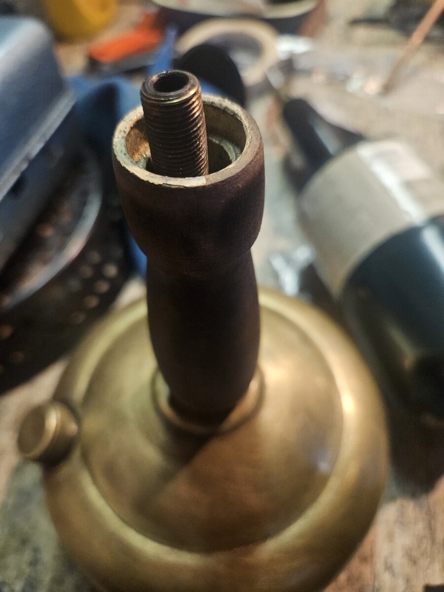

    I notice the wood handgrip is actually upside down, so while you're waiting, you could turn it the right way round. :)

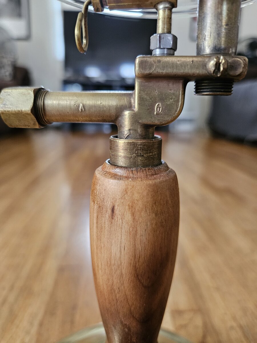

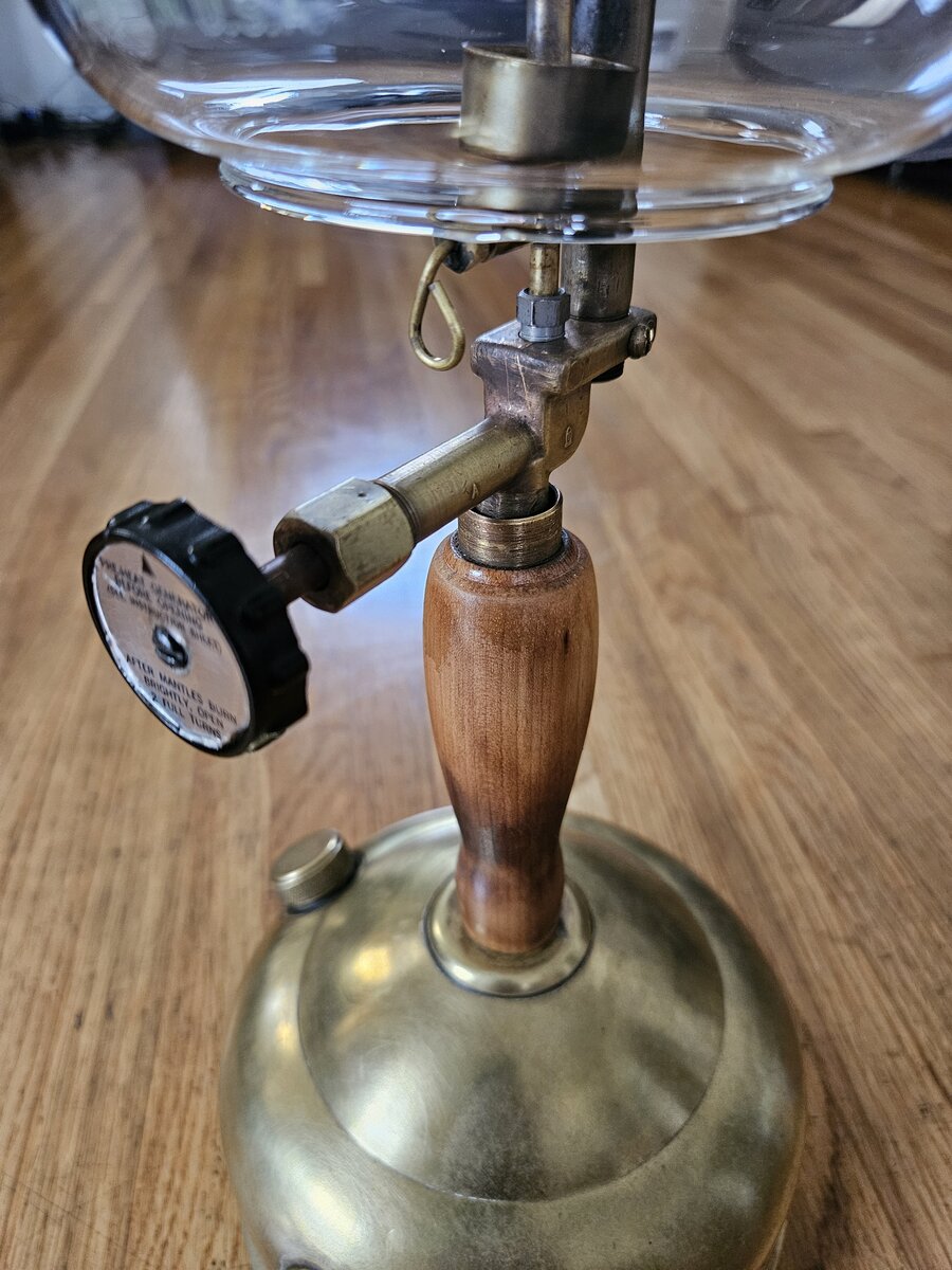

    @Henry Plews I can't get the handle to install the other way. Here are some photos
    @ROBBO55 ok so I'll order one of those...found a bunch of them online.. Thanks!
    Looks like it is working! No leaks!

  13. Henry Plews
    3,033
    The circular "nut" doesn't have to go down inside the wood. Have a look at other examples of this model in the lamp reference gallery, a good example can be seen in this post by @Tony Press
    Coleman 159X (Canada; Ja picture 8 is a close-up.

    @Henry Plews ok that did it! I had the nut upside down. I have it squared away now.

    I was kind of waiting on advice but then I just figured I'll give it a try and see what happens. What I got was a clean running lamp with no issues that I can tell. I've had it running in my garage for about 45 minutes while I grilled bbq for the wife.
    Today the globe comes and today that @Reese Williams showed me a link for. Once I have that on (may need to straighten out the clips that holds that globe as mine are a little bent) I'll get another photo. Here is a photo of it sitting on the kitchen table

    Oh..... This is really cool. Can't wait to see how it looks at night. I'm curious how I'll start it without flare ups. Probably remove the globe before it
    I really like it...

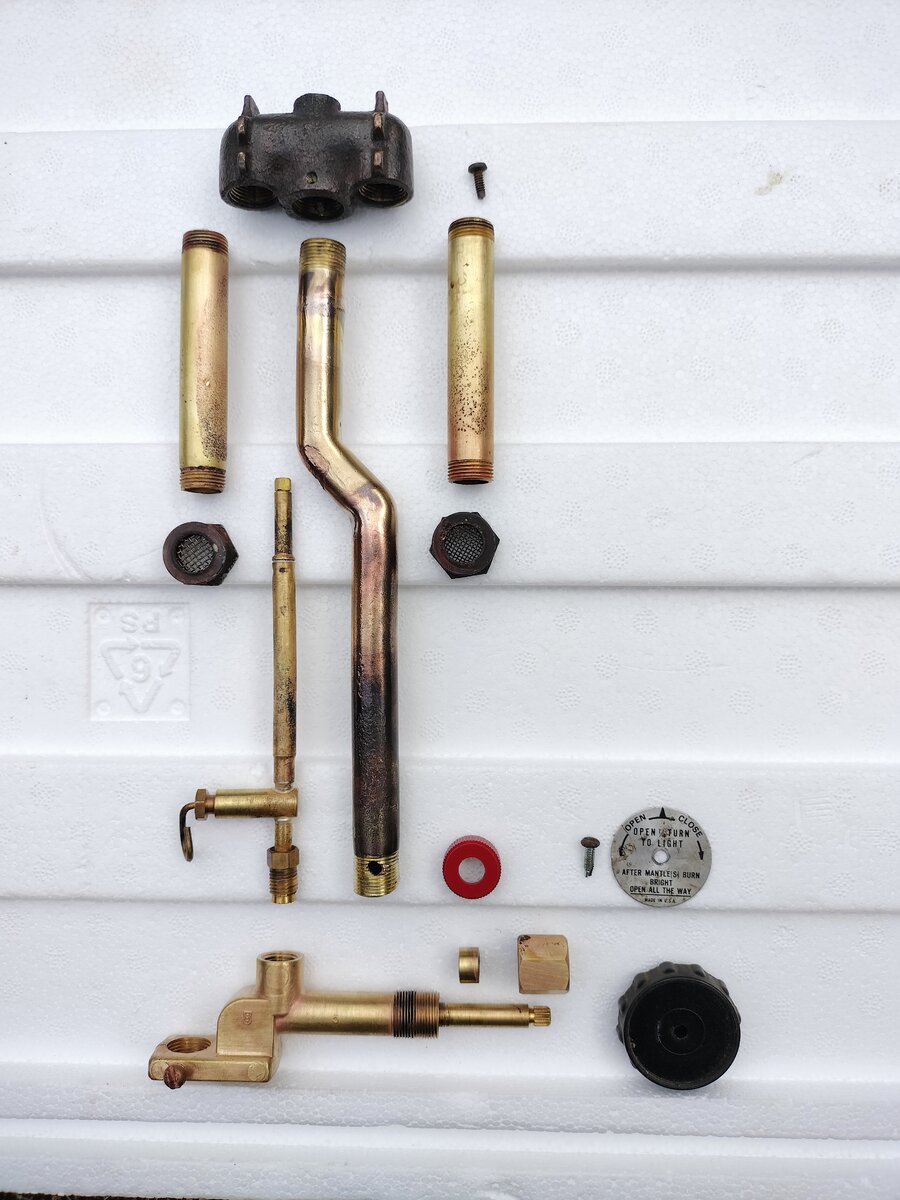

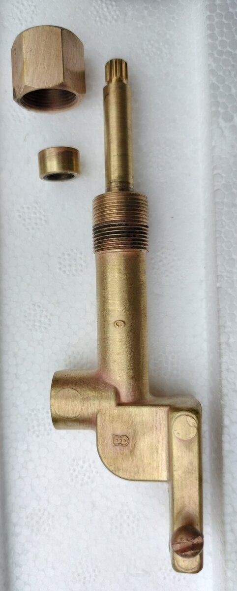

    México
    Nice you got back to life this lamp again but your lamp is using a Leacock burner that you could use a Q77, Q99 and R55 generator and there is a updated burner that uses the 220/228 style generator I believe the part # is 220E5891
  22. podbros
    3,999
    @Pancholoco1911
    could it possibly have a Leacock control tap + casting and the burner top part + tubes from a Coleman or is that how they looked originally?

  24. Pancho
    Pancho Subscriber
    Nov 26, 2019
    507
    México
    @podbros no, that burner is not Coleman from factory.
    I have a few burner like this and the newer one that takes the t44/220 generator.
    I was looking for picture in my phone but no luck, these particular burner came in Leacock 100 lamp and Leacock 100 wall lamp. Newer style came with the 107SS lamp and 107SS wall lamp. You can still buy the newer burner but no new lamps like the 107

    Looks like the air tube and burner are Coleman but your valve body is not. Here is my Leacock 100 lamp. IMG_3979.jpeg IMG_3980.jpeg
    your air tube has the two dimples on the back and can burn kerosene.
