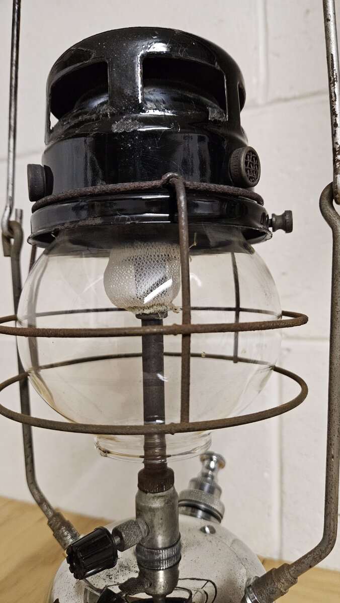

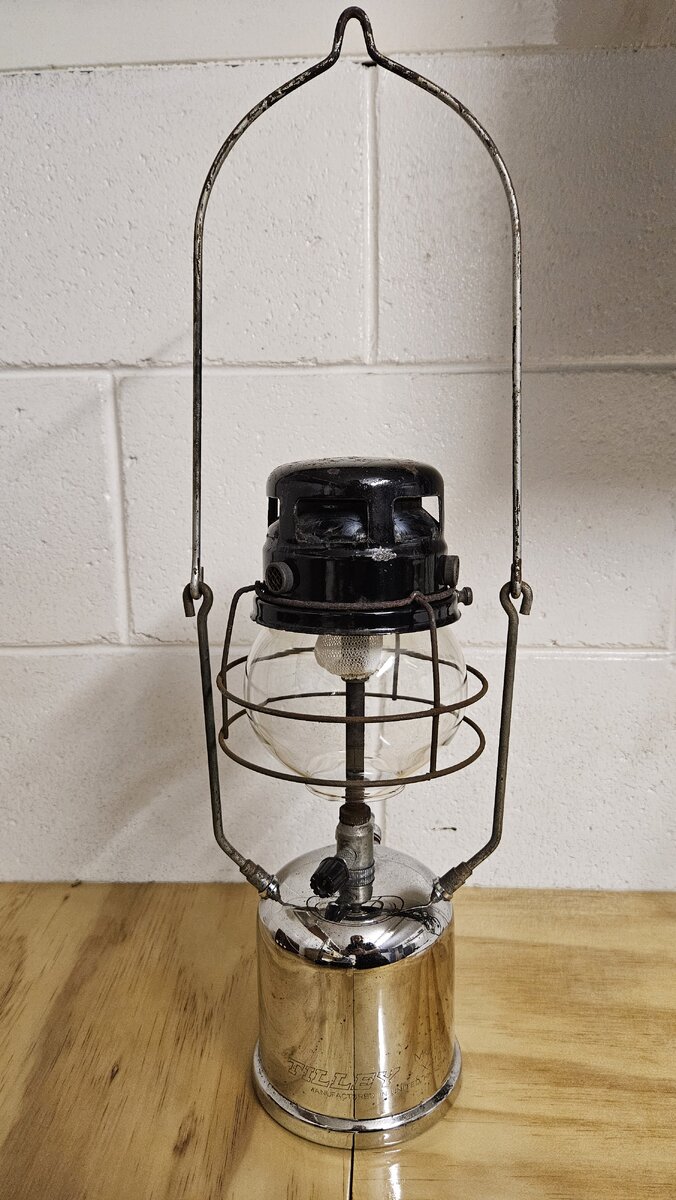

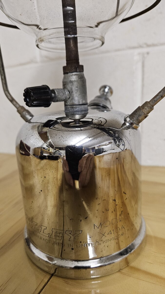

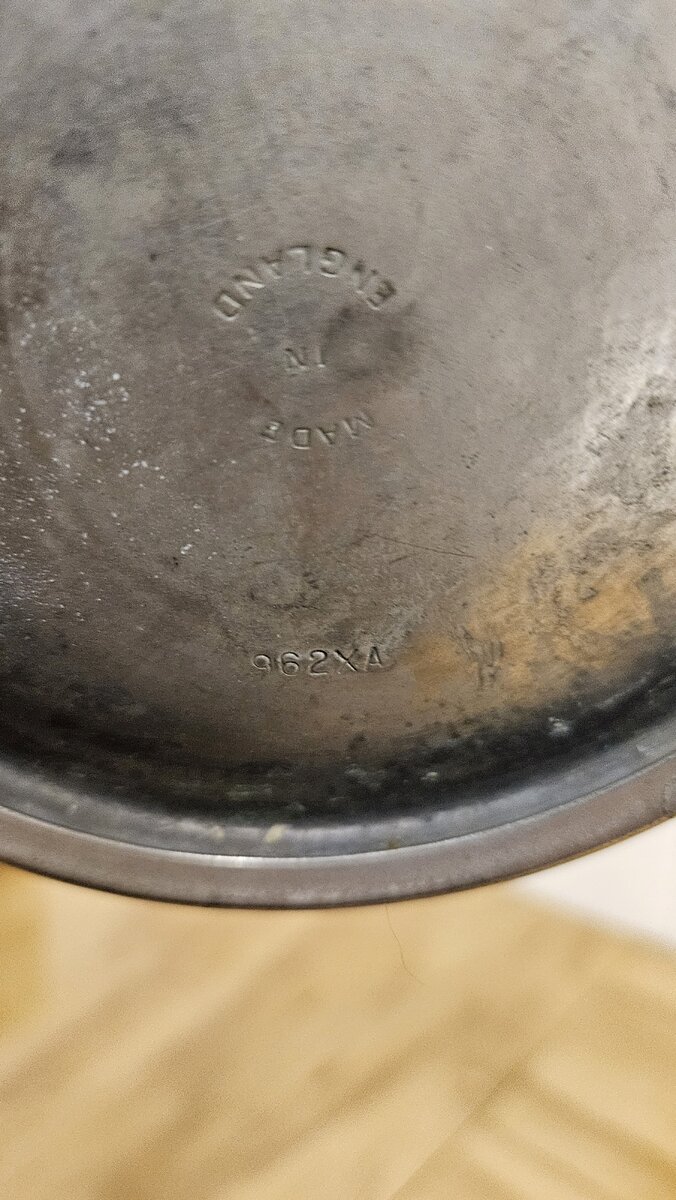

    Here is my X410A Ive had sitting around for a while, have given a cleanup and fired up for the first time.
    This one appears to be made in September 1962 I'm not mistaken.
    20250303_011809.jpg 20250302_171829.jpg 20250302_171637.jpg 20250302_171626.jpg 20250302_171554.jpg
  2. David Shouksmith
    Have you got a 606 fitted to that? :-k

    Yes it appears so after measuring it. Kind of a mystery why it had been changed, as this lamp appears to have had little use.

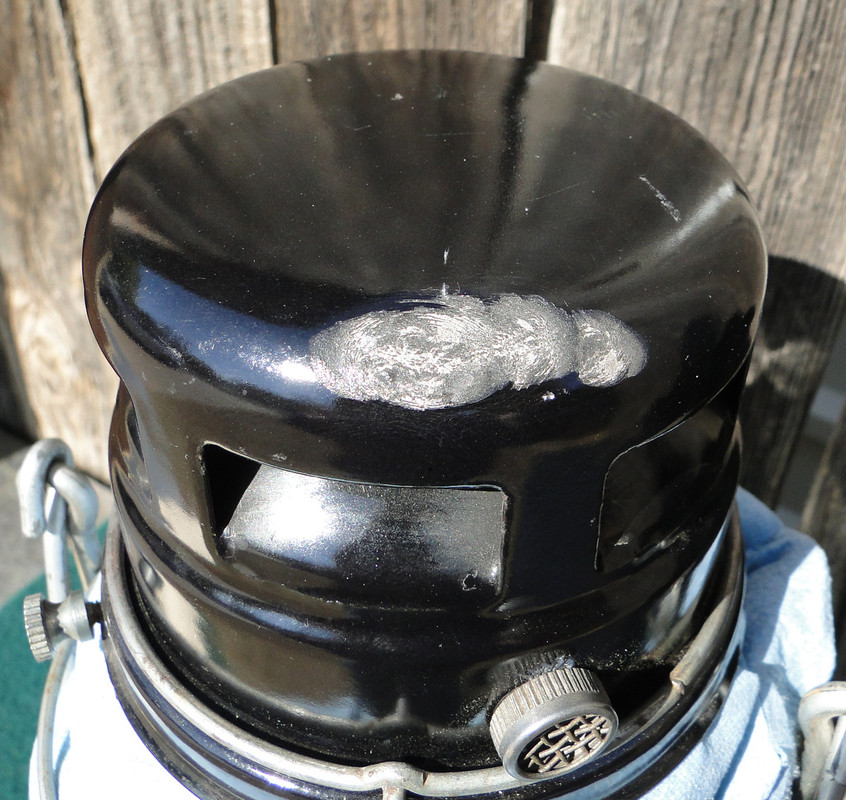

    Looks great! IMG_6476.jpeg I have yet to try and lit mine.

    Wow, New in Box. It looks unfired, I'd be tempted to keep it that but if you do decide to light it, the insect screen is upside down which will make it difficult to fit the alcohol torch.

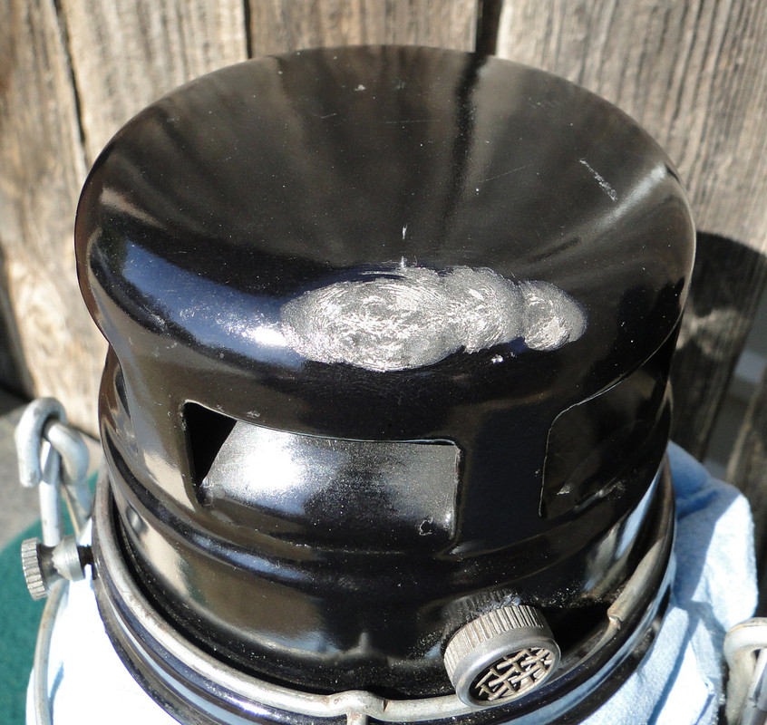

    To be honest I have no inspected the lamp yet, has a chip in the enameled hood and this is how I bought it from a fellow collector over CCF IMG_6490.jpeg
