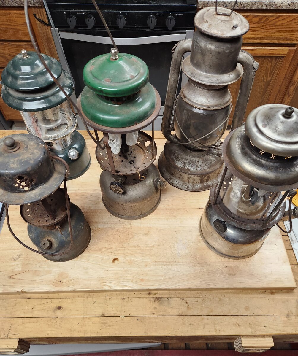

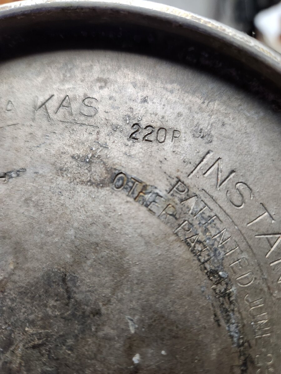

    My haul today, but I have a question about the 220. I thought it was a 220B but the bottom shows a 220P. Any ideas?

    That is a light strike on the “B” making it appear as a “P”.
    Even the “228 B” was stamped “220 B” in the 1930-34 era.

    Tony I do not see a date on it, should it be under the Coleman sunburst?
    I was thinking a light strike also.

    A light strike would make sense - but it does not really look like one. I do not believe there ever was a "P" - "proptotype" ? pure supposition.

    I will defer to @coleman54, a recognised expert I this field of Coleman variation identification, but… what would it be a “prototype” of and why?
    Mistamping, wrong stamp, or a damaged stamp would seem the most plausible explanation.

    Tony, thank you. As a newbe at this it just sparked thinking it was a Yunicorn.

    Now knowing where the date is, it's a Jan. 1933.
