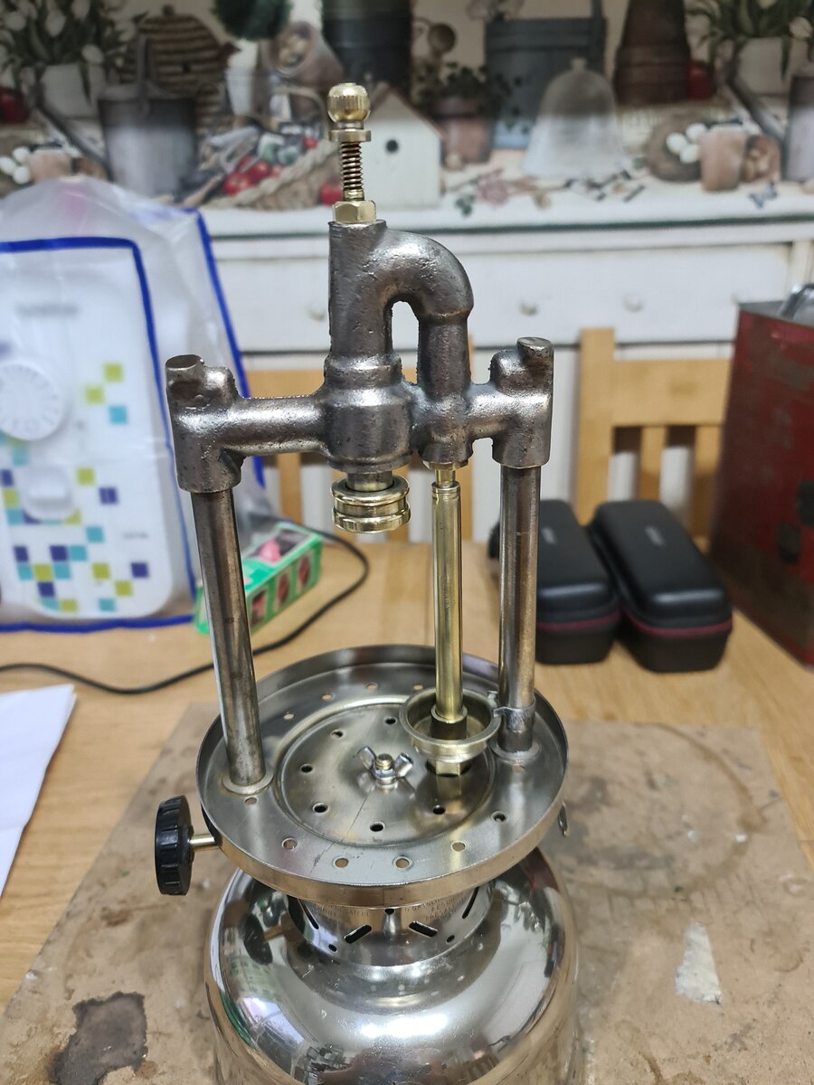

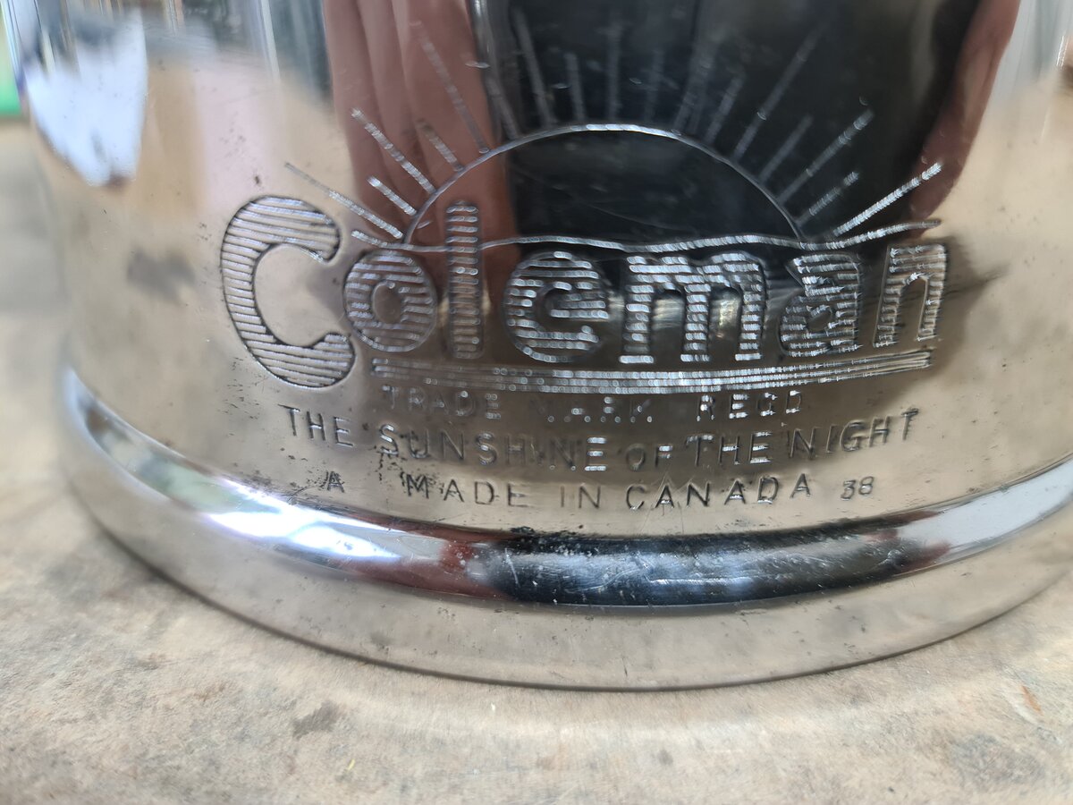

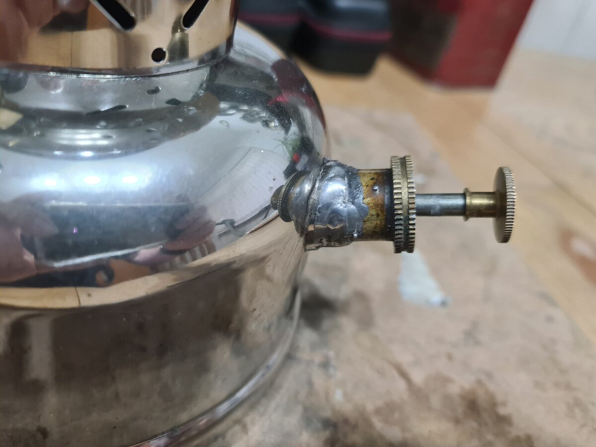

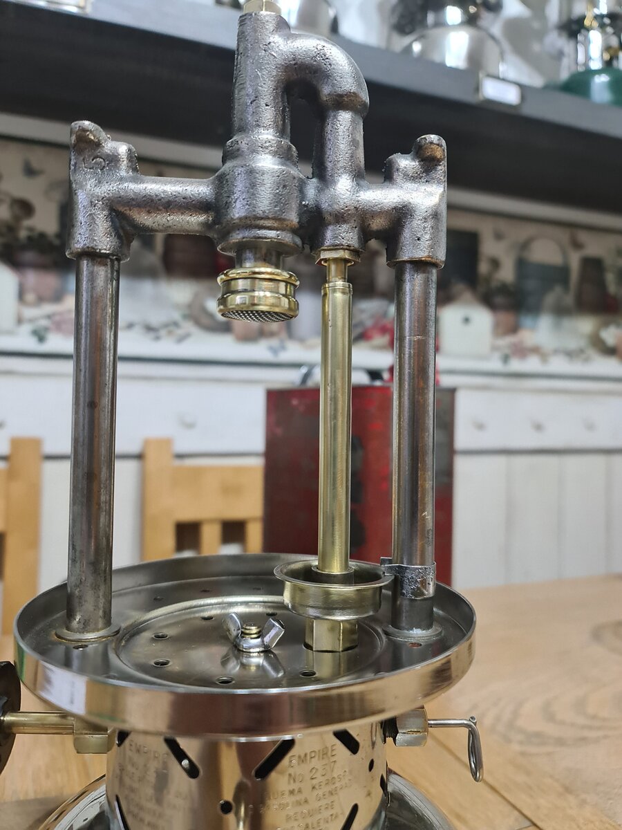

    237 Canadian A/38, 1st quarter and year of production. I found this in India, the pump tube had been cut out and replaced with a Primus Pump Tube and Check Valve. The bottom half of the original Coleman pump tube is still rolling around inside the fount. 20210615_213432.jpg 20210615_213438.jpg 20210615_213458.jpg 20210615_213545.jpg 20210615_213612.jpg 20210615_213701.jpg

    I'm quite surprised on what happened to the pump for a lantern that doesn't appear like it had been used that much over the years.

    That was one I was using for testing. It has an original 3 piece. The pump was a botch job. I replaced the pump shaft with an original Coleman and had to fit a 427 pump cup due to the narrower diameter of the Primus pump tube.
