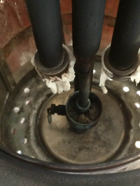

    I'm going to stick my neck out, here, and suggest L327. [-o<
    It's Canadian in origin and dated 9 35 so September 1935 presumably.
    It's fitted with the later generator (R55?) and there's a priming cup, too - surely that can't be correct, can it..?

    Can't be a 327 because it has a pump. It is a 427 but a special made in Canada as a kero lantern. So it is "The Mountie" model 427K. These were made at least up to 1943 and may have comntinued to the end of WW2. Not a common lamp and a nice find. ::Neil::

    I think its a 427 of some sort because it has the pump. No 327 ever had a pump. Someone put a pre heat cup on it so they wouldn't have to use a torch to pre heat. Its harder to match heat an R55 unlike the Q99.

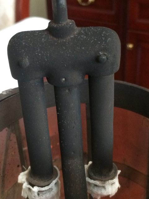

    You can tell a kero Quick-Lite by looking for the two small dimples in the upper air intake tube. Coleman added a restrictor inside the air tube and locked it in place with two dot punches.

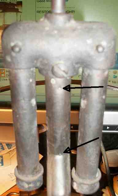

  18. David Shouksmith
    OK, I can't understand why I didn't find this before - I just looked in the same place and it was the third lantern I picked up. ](*,) Anyway:-
    There are two dimples - one just below the screw-head and a lighter one directly below the first one, on the bend. It shows as a white dot on the image (both arrowed).
    Are these they? [-o<
  19. Mackburner
    Yes those are the two dimples used to retain the inner tube restrictor for the 427K kero burner. That burner is unique to Coleman kero lamps in the 1930s and 40s. No question you have a nice and fairly rare lantern. ::Neil::

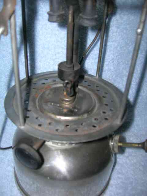

  22. David Shouksmith
    I had a look at this earlier. The 'not building-up pressure' issue was probably due to the filler cap washer which looked like someone had begun to burn it out and given up half-way through. It was easy enough to get the rest of it out but I've no replacement and busy with other things at the moment... :doh:
    What's the correct mantle? - when we get that far...
    Edit: I replaced the filler cap washer with one I made from nitrile and the lantern held pressure. However, turning the control cock and/or pricker didn't produce the satisfying 'hiss' I was expecting.
    When I removed the generator, the pricker was sticking through the jet but didn't move up and down when the wire loop was turned. I think the pin wasn't engaging in the eccentric block and wouldn't be engaged despite some fiddling. I managed to find a new R55 and fitted that. Now it makes all the right noises at the right time from the right places. :D/
    Too late to fire it up now so that's a job for tomorrow when I sort out some mantles...

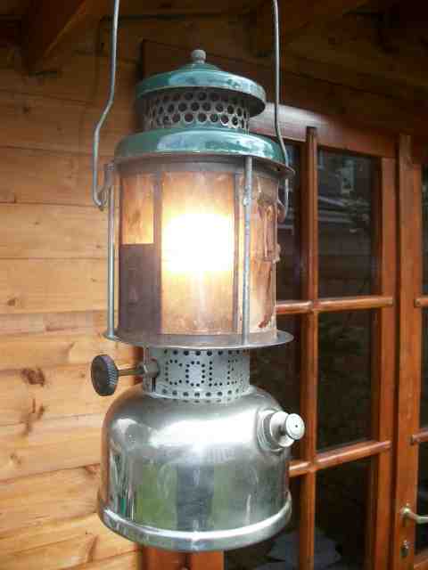

  24. David Shouksmith
    I fitted No.21A mantles and flushed the tank with kero - nothing untoward came out. I refilled the tank and primed the lantern, burning off the mantles at the same time. I gave it about 10 pumpstrokes (should probably have been more) and opened the valve - et voila!
    It lit immediately and without fuss. I gave it a few more pumpstrokes but it's just settling down in the pic and broad daylight with a semi-transparent mica globe don't help - far too windy here at the moment to run it without the globe.
    I'll let it run for an hour or two and then light it again tonight, maybe with a glass globe if I can find one to fit.

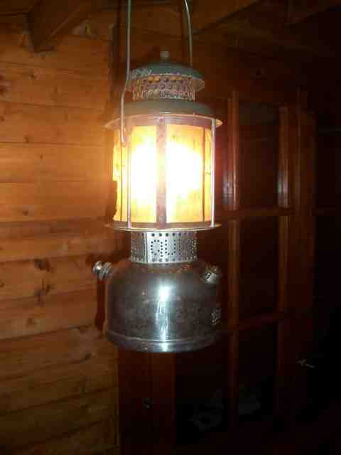

    Update: Aaaarrrggghhh! - it developed English Black Mantle Disease after about 30 minutes, limped along for another 10 minutes before I turned it off. I suspect it doesn't like modern British kero. I might try adding 10% panel wipe if I can find any...
    Further update: I tried adding 10% panel wipe to the kero. The lantern was much happier and didn't develop BMD. Still a bit of a halo around the mantles when pumped up hard - maybe this is a Coleman that doesn't like high pressure.
    Even further update: I tried to increase the panel wipe to 15% but my hand slipped and I think it's operating at about 20% now. It's burning much better:-
    This, taken with flash, doesn't really do it justice - the yellowing is mainly due to the dirty mica windows.
    Whilst this, taken without flash, flatters it a bit.
    Overall, I'd say it was putting out around 0.5 Carlsson units i.e. 250cp. Not too bad for a 78 year-old lantern... :thumbup:

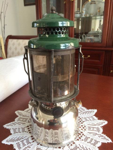

  26. adelcoro
    293
    Canada
    427K!!
    Early model
    First one I ever see what a small ventilator
    what a great treasure you have in your hands !!
    congratulations

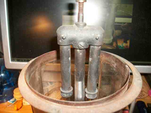

  27. adelcoro
    293
    Canada
    David found an identical 427K here in Canada
