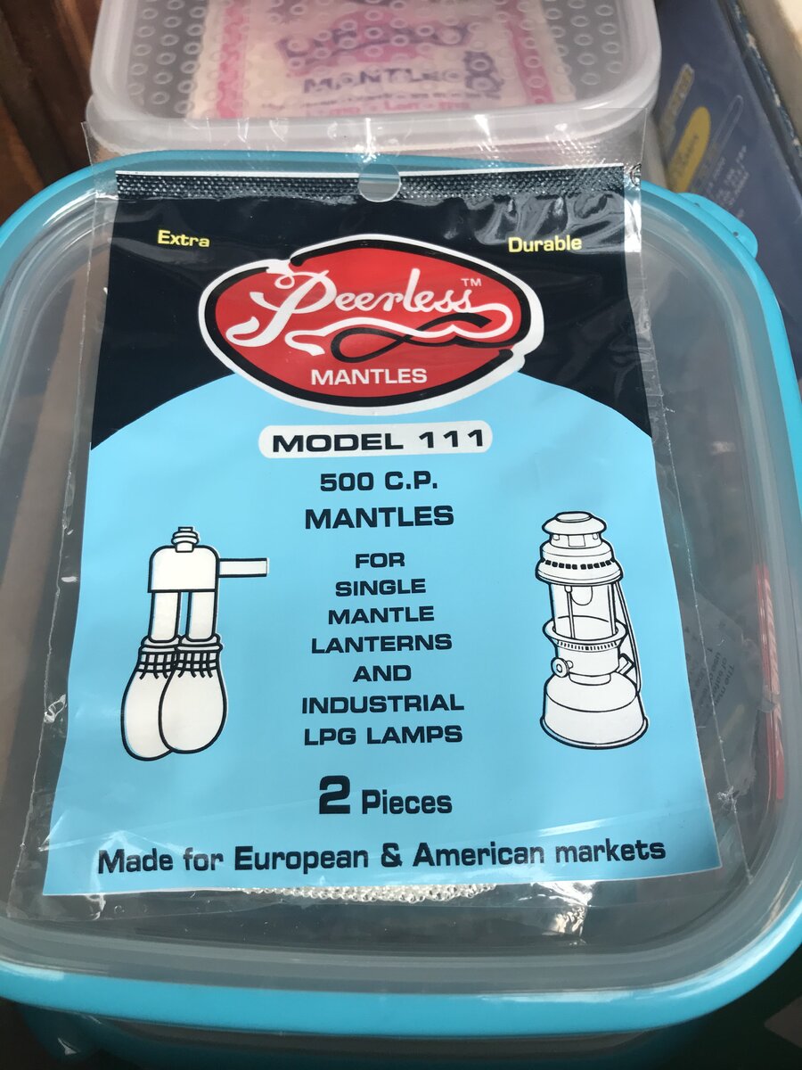

    If you want higher quality mantles buy from justmantles.co.nz.

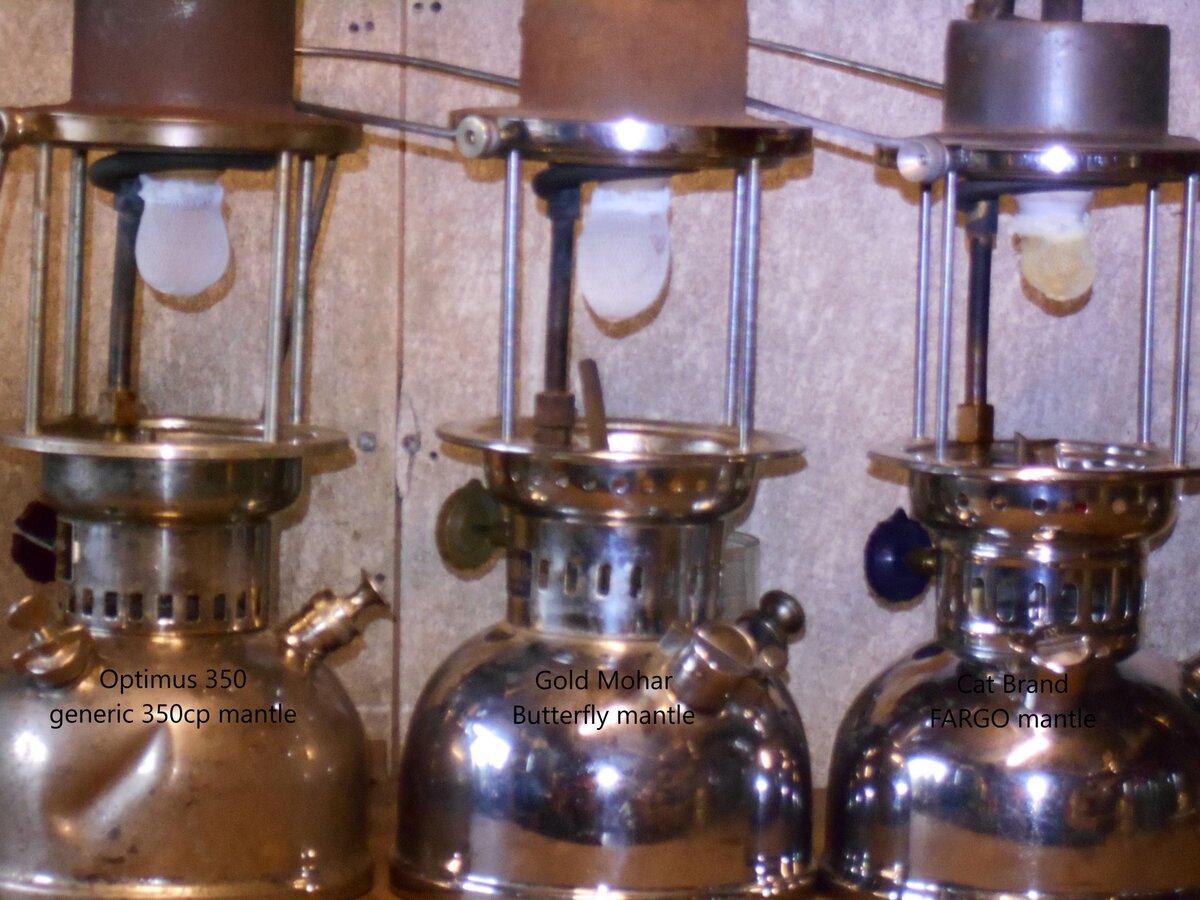

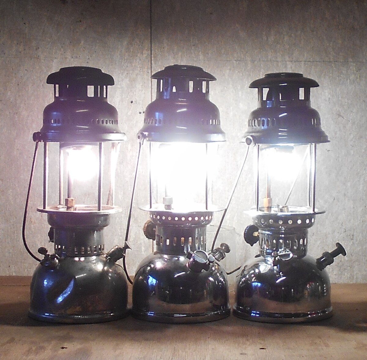

    Fargo mantles are bright and are certainly cheap enough but although rated 300 / 400 c.p., they shrink to a size usually seen on 200 / 250 c.p. lamps.

    I have used Anchor and Butterfly mantles from China that are readily available on ebay and I have found them reasonable. But Peerless from justmantles.co.nz. are a better quality.

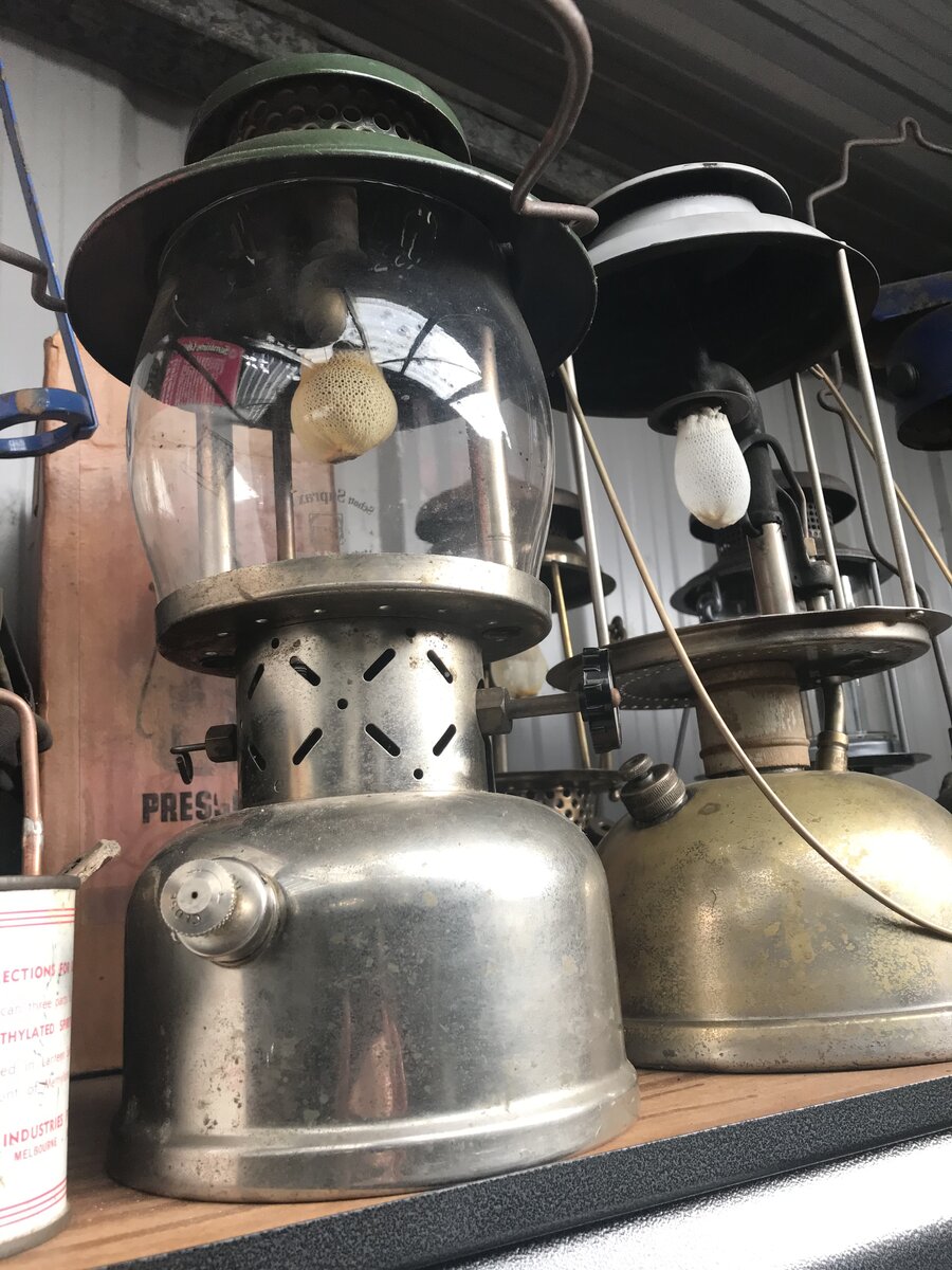

    Henry’s advice about the Fargo mantles is right. I have used them on a range of lamps and lantern, including Coleman 236s. The do have tendency to blow a hole on first lighting on the bigger cp lamps, though.
    This Coleman 236 is doing well with the Fargo. I used the Fargo to test after fettling, but when it breaks I’ll replace it with a Peerless 111 from Justmantles.

    I wouldn't say light output is reduced "dramatically", the Fargo mantles do give out a decent amount of light, but they'd give out more if they were larger i.e. had more surface area.
