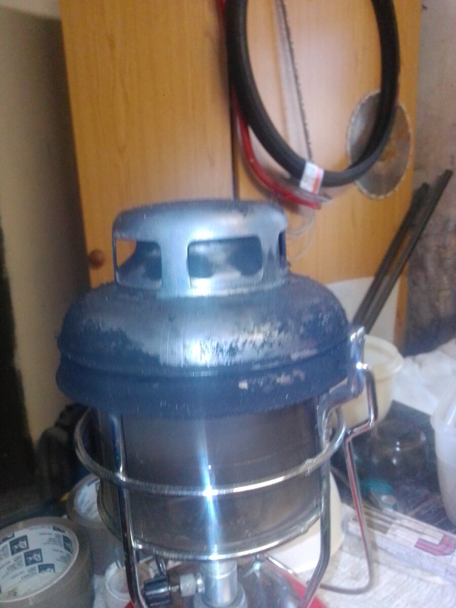

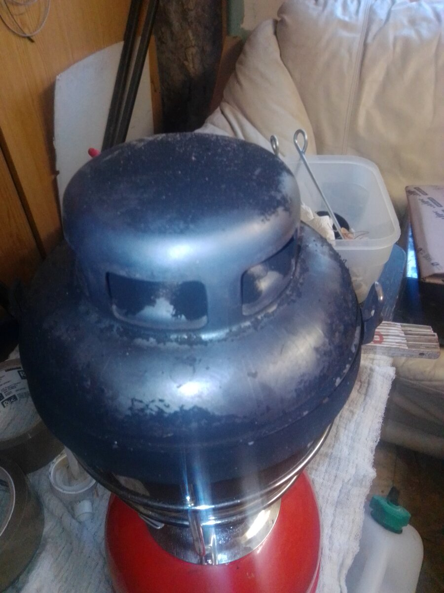

    Quod erat demonstrandum.....
    Enamel is not Acid (Citric) resistant..... Colour is not heat resistant....
    Regards and happy easter.....

    unable to figure out what you want to tell us.
    Erik
    Tony Press Ukraine Subscriber
    11,036
    @Erik Leger
    My take was:
    QED: Thus it is proven... that:
    1. Citric acid will attack the enamel on Tilley hoods; and
    2. 850 degree enamel paint does not withstand the heat of a Tilley lamp,
    but it is open to interpretation.
  4. AussiePete
    I read it as a failure on both counts.
    So the search for a heat resisting, or impervious, paint to a lantern’s heat goes on. This has been a worldwide quest of us lampies for as long as I have been a member.
    It’s no accident that the manufacturers used vitreous enamel for their hoods, why?
    Coz it works.
  5. ColinG United Kingdom
    4,815
    As you said Pete, the search goes on!
    The main problem with heat resistant paint is what we consider 'hot'. Most applications for heat resistant paint appear to be automotive (engines and manifolds) or possibly domestic stove related. While these are certainly hot, the temperatures generated by pressure lanterns are in a completely different league. The fierce white heat generated by the burning gasses as they pass through a mantle can exceed 1000°C and while this diminishes by the time it reaches the vitreous enamel coated hood, it's still far, far hotter than engine components.
    Apart from vitreous enamel, metal plating is the only other surface treatment that can withstand such extreme temperatures that pressure lanterns produce. This is why hoods are either bare metal (as with early Vapalux and Bialaddin), vitreous enameled as is the case with Tilley, Coleman and many others, or nickel/chrome plating that you find on Petromax and their clones!

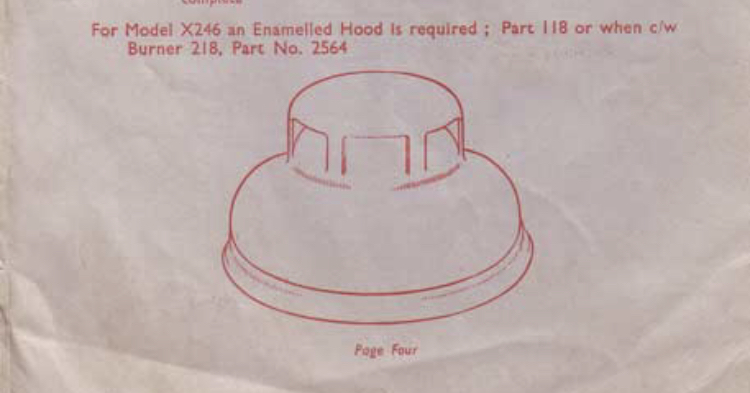

  14. M.Meijer
    608
    Netherlands
    @ColinG
    Colin, you mentioned:
    However, after a (bare) brass top for just the E41 model, this same shape was produced already in grey vitreous enameled steel even before the Vapalux 300 model came to light. So save 1940/41 alle subsequent W&B lamps had enameled steel tops.
  15. M.Meijer
    608
    Netherlands
    Re-reading my comment on Colin's remark, I realise we use a different vocabulary. A 'hood' is to me, like the atire, something you can use or not, and not an intrinsical part of - in this case - a lamp. Like a 'shade' or 'top reflector'. That hood usually sits around the 'chimney' or 'ventilator' (venting hot gasses and above the burner) which is topped by a 'top'. The latter is often of different metal and finish than the chimney, and it is the top I am refering to. Colin is right when refering to the unit above the lamp cage. Mike
  16. Tony Press
    11,036
    Hood —>
  17. M.Meijer
