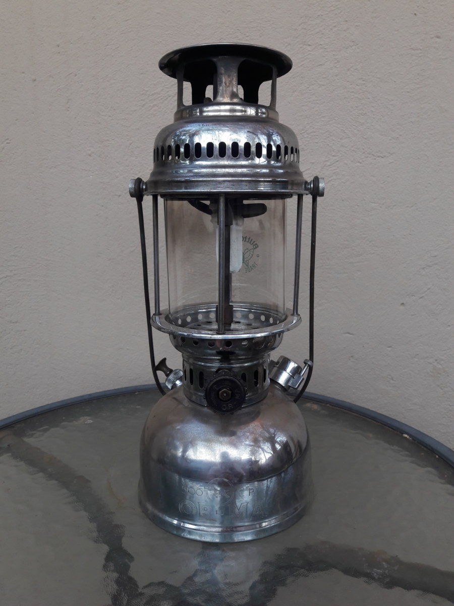

    Firstly the OR-MA 500CP with the attractive horse emblem had been fettled by the previuos owner. Although it was fitted with a Butterfly globe, it was a runner. Having a brass fount means it will last for many more years.

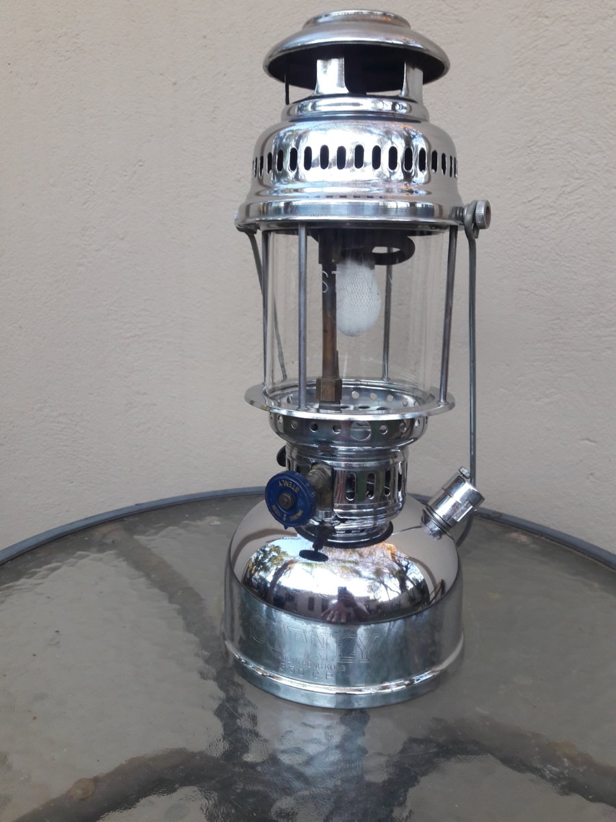

    The 350CP Stenly cleaned up very nicely, and a new cleaning needle was all that was reguired. Nothing fancy here, even the original STENLY marked globe looks like there was no graphic design involved.

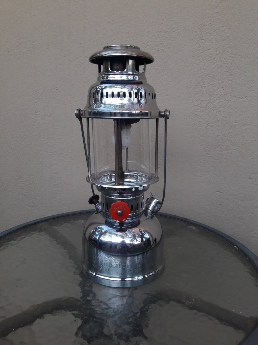

    The Anchor, although steel and not brass, was well made and the Chrome finish held up well. After giving it a service, I noticed the flame 'hunting' or oscillating. I found the tip of coiling brass or copper wire around the cleaning rod on the forum. This resulted in proper and even fuel heating, thanks. A Good and even burn was achieved aftet that.

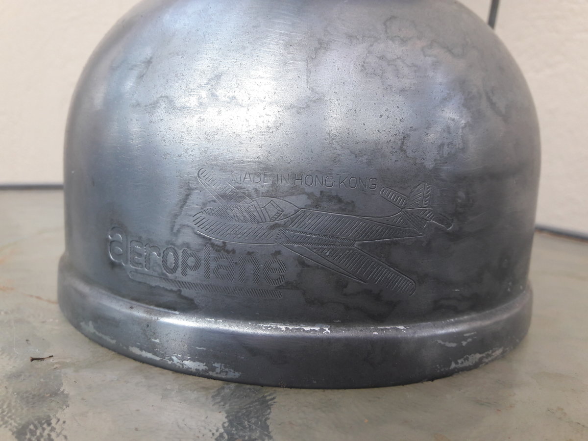

    Lastly I got the Aeroplane. I was excited about the graphic on the fount, but that was it. The chrome had peeled of like paper, and the steel underneath, although not rusted is very unatractive. I might still spend some time on it, but for now it goes to the back shelf.

    It's difficult to know what you could do with your Aeroplane lantern. You could spray it silver perhaps... you can get fake chrome effect sprays that don't look too bad. Otherwise, you could use a different colour altogether but the raw steel will need protecting long term. What's the plating like on the rest of it?

    I have thought of spraying the Aeroplane font red. The frame rest/collar also lost sime of its chrome but it is not so bad. Since I don't have any red in my collection of 16 lamps yet, and think some colour would be fun.

    I was going to suggest red! Red and chrome would work well. I sprayed two of my Bialaddin's red and they look great!

    Your Or-Ma, Stenly and Anchor appeared to be quite well-made. From the looks of them alone, I would guess that they are comparable or close to the quality of the original Petromax from Germany.
    I'm not so sure about the Aeroplane though(besides taking any accounts on the peeled chrome).

    How about Nickle Plating it.

    I haven't checked in recently, apologies for the late reply. The fount is definately steel, but the one I have had no rust.
