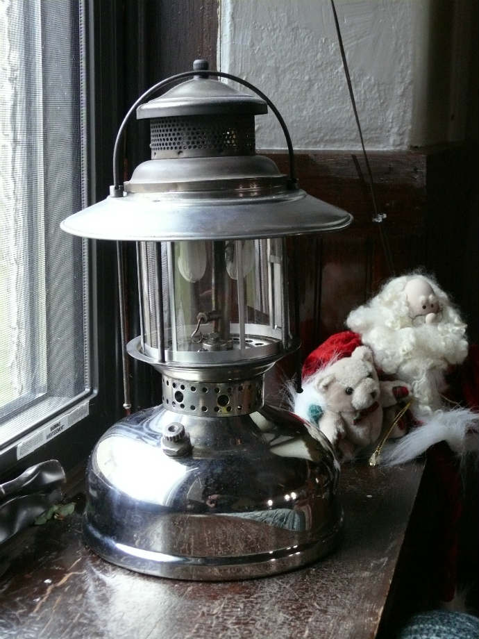

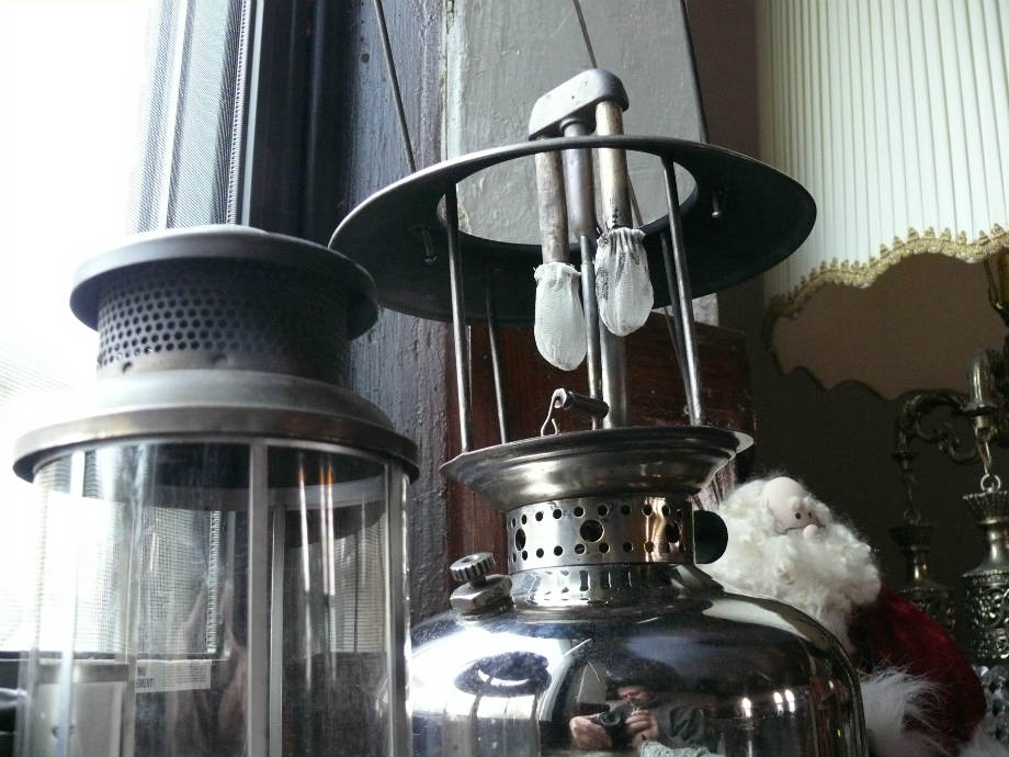

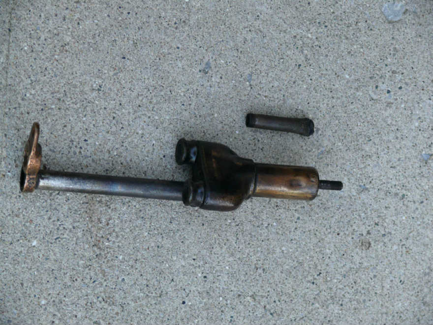

    Any help or advice about the burner set-up in these is most appreciated. Pic 3 shows a typical AGM burner... under the dome at the top is the small threaded pipe that is crimped closed. The pipe has a small needle size hole in it.
    Can't get this burner to work using coleman generator(s) ](*,)
    Fount is coleman, burner is now coleman and works fine.
    Thanks Ian

    Hi Ian,
    The tube under the dome isn't supposed to be crimped, I have several AGM's set up like that here and it's a straight tube. The fuel comes out of the generator straight through the tube then fills the dome and is forced out the burners at the bottom.

    Thats great, I tried for hours with numerous flame ups... Someone was at it before me.
    I don't really like changing them out unless it's necessary.
