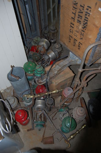

    On Saturday last, I was able to go down with the cash & a bunch of boxes and old bed sheets to wrap them, paid the man, and spent a leisurely hour or so gathering them all up and loading them in my van - all 31 1/2 of them! When I got home, I lined them all up on the patio and took this image for the membership to see and comment:

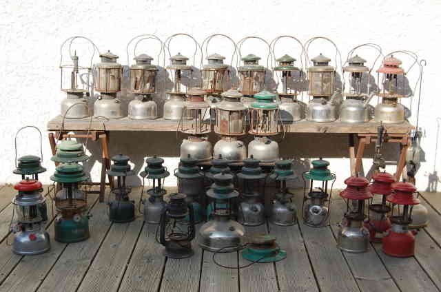

    And here they all are.
    I called the guy back in the afternoon, to ask him about the person who had brought them to his shop. All he could tell me was that it was just this average middle-aged guy from Winnipeg. A real pity - I would sure have liked to meet and talk with the person who assembled this "hoard" of lanterns, maybe even find out who made the fantastic "frankenlantern" out of a 1925 Canadian Quick-Lite fount & Canadian 247 Scout.
    So there it is. I'll follow with an ID table to help describe the hoard, and will welcome any and all comments and questions about them. This group is going to keep me busy for a very long time, and I'll have many questions about the individual pieces as I begin their restoration work. I hope all of you enjoyed the story and images.

    Here is a table of the lanterns and lamps in the "hoard". I just grabbed a lantern, gave it a number, and ID'd it as best I could. Please comment or pm me if there is a specific lantern you are interested in commenting on - Its a bit crude, but it should help with the images above. I'll answer any question regarding any of the makes or models & post specific images if requested.
    #/ Country / Brand / Model Name & No. / Date
    1 US Coleman Air-O-Lantern Model QL 1916 - 1918(?)
    2 US Coleman Air-O-Lantern Model IL post-1919(?)
    3 US Akron Model 103 1920"s
    4 US Justrite Model 25 circa 1926
    5 US Sunshine Safety (unknown) 1920's
    6 US Coleman Quick-Lite Model L427 6 5
    7 US Coleman Quick-Lite Model L427 6 5
    8 Coleman Quick-Lite Model L427 6 10
    9 Coleman Quick-Lite Model L427 6 7
    10 US Coleman Quick-Lite Model 327 5 4
    11 Canada Coleman Quick-Lite Model 327 26 8
    12 US Coleman Quick-Lite Model 327 4 11
    13 US(?) Coleman Quick-Lite Model 327 5 6
    14 Canada Coleman Sport-Lite 242B 3 47
    15 Canada Coleman Scout 247 5 48
    16 US Coleman 242B 1 11
    17 Canada Coleman Sport-Lite 242B 7 37
    18 Canada Coleman Sport-Lite 242B D 43
    19 Canada Coleman Scout 247 4 48
    20 Canada Coleman 242-type (no base rest) 9 36
    21 Canada Coleman "Frankenlantern" - a Canadian 1925 lamp fount, with a Canadian 247 Scout 1950's to 1960's
    22 Canada Coleman Major 236 5 67
    23 Canada Coleman Model 159 lamp 9 57
    24 Canada Coleman Model 159 lamp 9 57
    25 Canada Coleman Model 200 12 58
    26 Canada Coleman Model 200 1 63
    27 Canada Coleman Model 200 5 62
    28 Canada Coleman Model 335 5 72
    29 Hong Kong Unimet Model GL-1 circa 1960's
    30 Hong Kong Ashflash (US market) Model 1022 1960's(?)
    31 Germany Hasag Deadflame Kero Hurricane Model No. 651 unknown
    32 Canada Coleman Seafoam 236/237 ventilator and bail 1940's
    A bit crude, but the models and years are there.

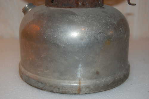

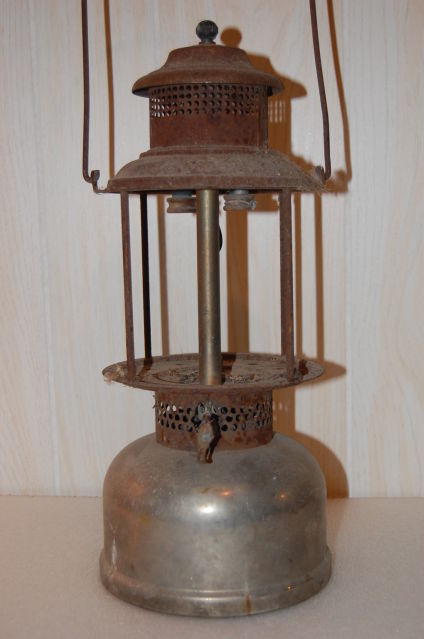

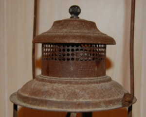

    Here is the Justrite lantern Model 25.
    1319922565-Justrite_2_opt.jpg 1319922579-Justrite_3_opt.jpg 1319922595-Justrite_4_opt.jpg 1319922614-Justrite_5_opt.jpg
    Observations:
    - Fount looks suspiciously like a Coleman fount, and has what looks like a nasty stress crack (first stress crack I've ever seen in person). there are no markings anywhere on the fount.
    - Control wheel has been replaced by a home-made version (common up here in lanterns from the 1930's). still functions properly.
    - Ventilator clearly marked by company
    - Unique burner and generator
    From the literature, this model ( if it is in fact a model 25) seems to date to about 1926. Any advice regarding the date of manufacture or the suspicious looking fount will be gratefully received.
    Fount image to follow.

    Here is the Justrite Model 25 fount. It is suspiciously like a Quick-Lite fount, but has an external thread.
    Is this the original fount?
    Does This model date to around 1926?

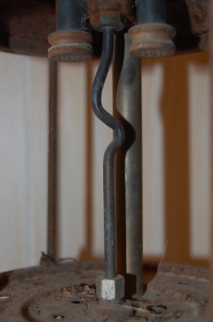

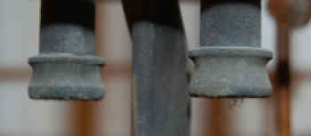

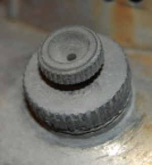

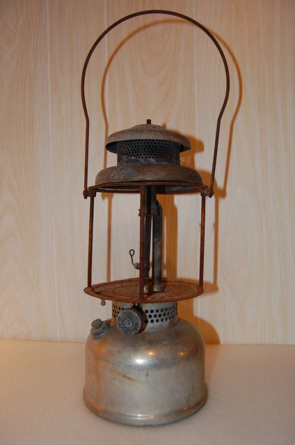

    Here is the Air-O-Lantern Model IL.
    1319924282-IL-2_opt.jpg 1319924301-IL-4_opt.jpg 1319924317-IL-6_opt.jpg 1319924335-IL-8_opt.jpg
    - No identification markings or small folded tabs on the lower flange of the ventilator
    - No central base plate - has large washer with 1 flattened or trimmed side, adjacent to the air intake tube
    - Patent date of 1919 on air intake tube
    - Burner caps are flared (typical) type & upper burner casting looks "recent"
    - R55 generator
    - Match lighting door on globe rest, with bead-like metal handle
    - No markings or date stamps anywhere on fount
    - Ventilator nut is missing
    - No pump notch in edge of globe rest
    - Base rest stamped "THE AIR-O-LANTERN MODEL IL MFD BY THE COLEMAN LAMP CO WICHITA KANS."
    - Valve wheel in poor condition, though may be flat on outer edge (as opposed to slightly rounded) - no markings visible
    - Unusual "cup-shaped" check valve on round filler cap with fine notching on edges
    - Mica globe with vertical sliding door (poor condition)
    I don't know much at all about this model, but from what I've seen, I would say the burner assembly was changed out with a more recent form sometime in the past, but that's just my guess.
    Please help me make an accurate ID of this lantern as to its model and years of manufacture, and the distinct features that make it a Model IL. Did this type have a model number as well as the "IL" designation? Was the burner assembly changed out?
    Other images to follow.

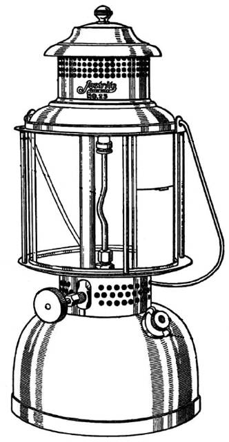

  16. Mackburner
    Not sure about that Justrite tank. The real thing has a rounder shoulder that that. Here is an illustration from a model 25 instruction leaflet.
    The IL originally had a torch lighting generator and burner. These were commonly re fitted with Quick-Lite burners to upgrade the lantern. This upgrade was a service that Coleman provided but could also have been done by the owner of course. No question the fount and such are from around 1916 to 1921 but the burner could have been changed not long afterwards. So the retrofit fettle may well date to the mid 1920s. Interesting and desireable piece but sadly not quite as desireable as a complete and original example.
    ::Neil::
