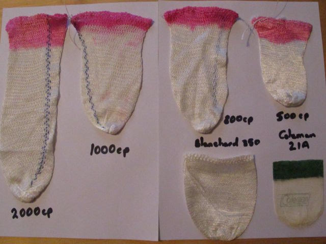

    I just try to get a mantle that works best for the lamp never mind the cp rating modern mantles some anyway must be overated. You maybe intrested in this picture taken against A4 paper of some mantles i got from Pelam i took the pic to compare them against each other just by chance i wanted more

    Thank you Pete, firstly what does that 2000 CP mantle go on :shock:

    The 2000 cp mantle must fit something but i have not found it yet maybe petromax donuts come in this size. I found the 800cp size quite useful but shrinkage and the open weave did not do the lamps justice really.
