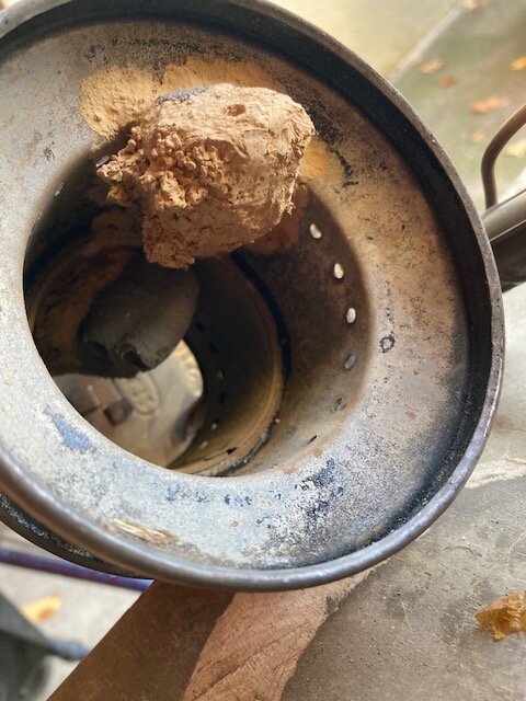

    I picked up a Dietz No 2 D-Lite for cheap. It was so filthy I could not see if I was making a mistake. However with steel wool, some emery paper and a brass brush it turned out great.

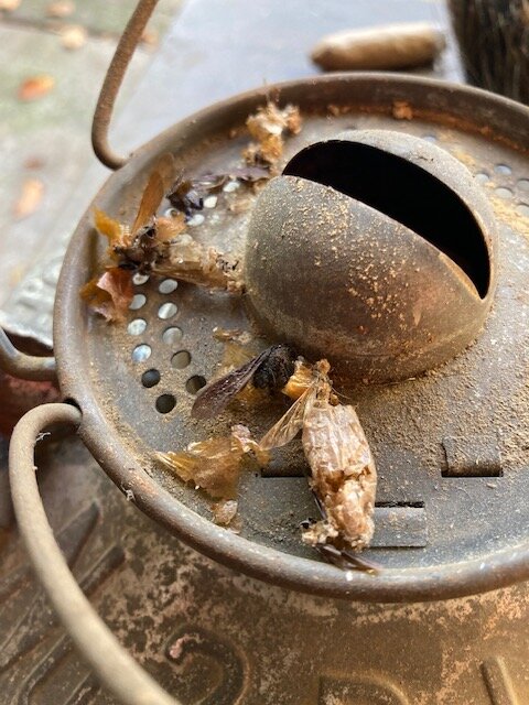

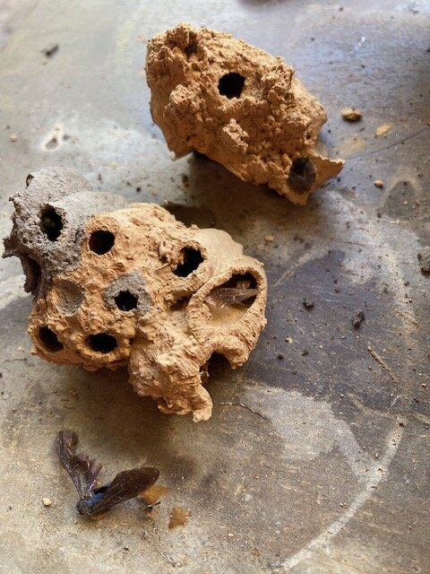

    the trouble was that I could not get it to raise to get the globe out. Frustration led me to vigorously shake the lantern and I was rewarded with a shower of dried wings and yellow jacket bodies

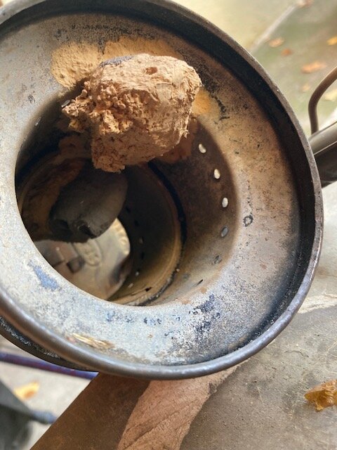

    Now I understood that someone had made a home in the upper part of my lantern With much twisting and pulling I was able to get to this

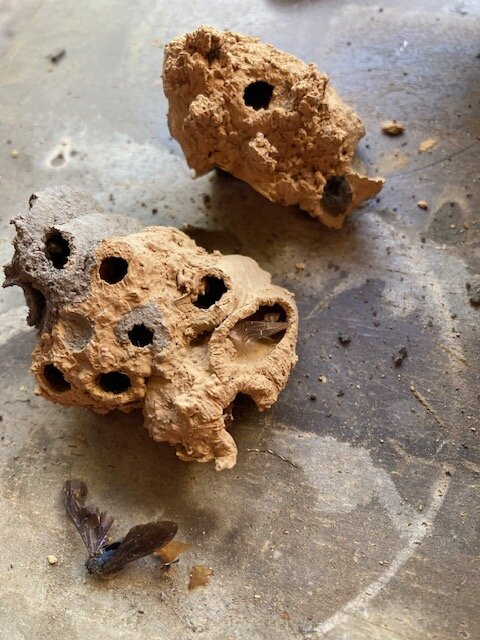

    That with the help of a screwdriver got me this

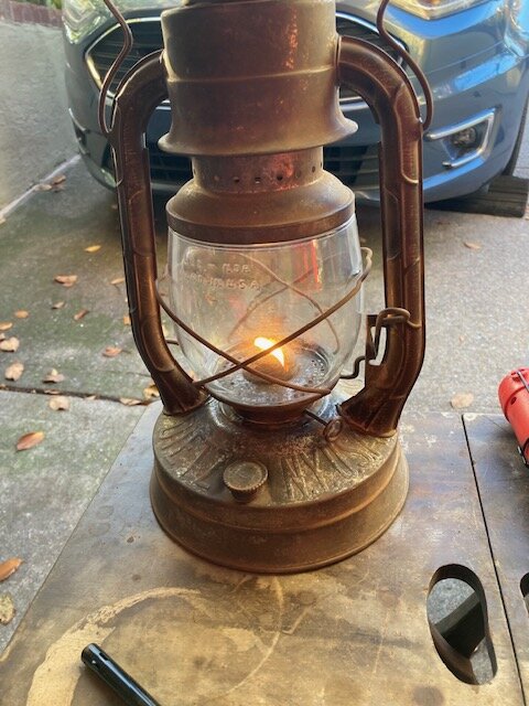

    You're lucky that the air tubes haven't been inhabited. It would have been difficult to get them completely free again.

    I think that this style of lantern is a cold-blast lantern, so doesn't have air tubes running back down from the crown to the burner, as on my Chalwyn Pilot. :-k

    You are correct SJ. It is a cold blast lantern. We had gale force winds for a few nights starting on Halloween. I had 2 of my Dietz HY-Lo out, They are both hot blast . I clearly noted that even though they did not go out, they were pretty battered by 30 MPH winds. While my 2 cold blast railroad Vesta's shrugged it off. The difference that I have noticed with my very modest collection is that cold blast really smell of kero while the hot blasts are much less noticeable.
