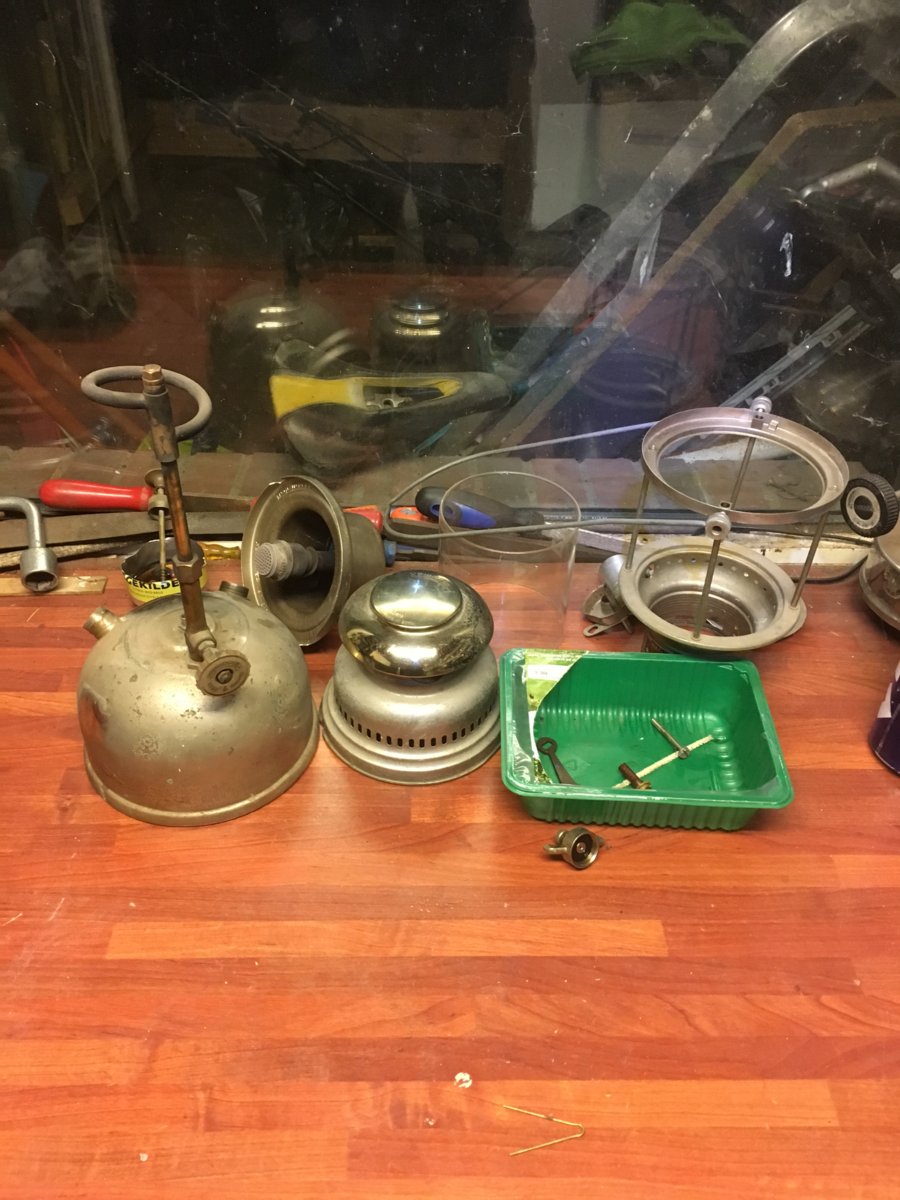

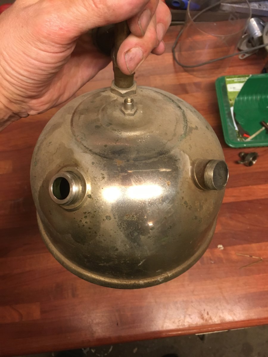

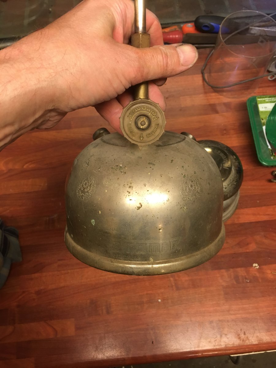

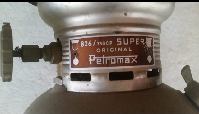

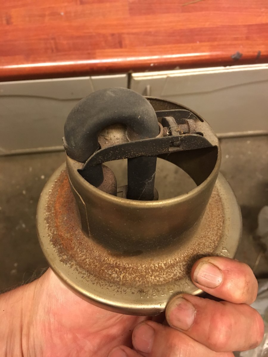

    I picked up a Petromax 826 in OK looking condition for 34 Euro not far from where I live. Wife likes the “used” look of it - it seems to have been idle for quite some years.
    Might install a 250 jet, needle and mantel in order to brighten it down a bit.
    I have no idea of build year?
    Again
    - Thank you all

  26. Wim
    Wim Subscriber
    925
    Dendermonde, Belgium
    Others are more knowledgeable on these then me, but the "E" inside the "G" is missing so post WW2, early 1950s is my guess.
    They are a fine lantern, yours does not have the pre-heat torch, but I don't like these anyway. They are easy to start with a spirit pre-heat tray and you don't really need a pressure gauge. They go bust all to easy as well. KISS rules!

    eiremax Subscriber
    Jul 5, 2014
    630
    A fine lantern. Look at the bottom of the tank. There should be a 4 digit code, from that the approximate date of manufacturer can be determined. This will run at 250HK no problem. My advice is to first use 500HK furniture to burn in the mantle, then swap over to 250HK and readjust your air gaps. Runs a lot quieter and less thirsty. Petromax Helox mantels are excellent btw.
  29. Harder Sorensen
    Harder Sorensen Subscriber
    Jun 6, 2018
    119
    @eiremax
    You’re right - It is stamped 4133 under the bottom of the tank?
  30. eiremax
    eiremax Subscriber
    Jul 5, 2014
    630
    Week 41 (41) of 1963 (3) om the 3rd day (3)! Good luck with it and keep us updated
